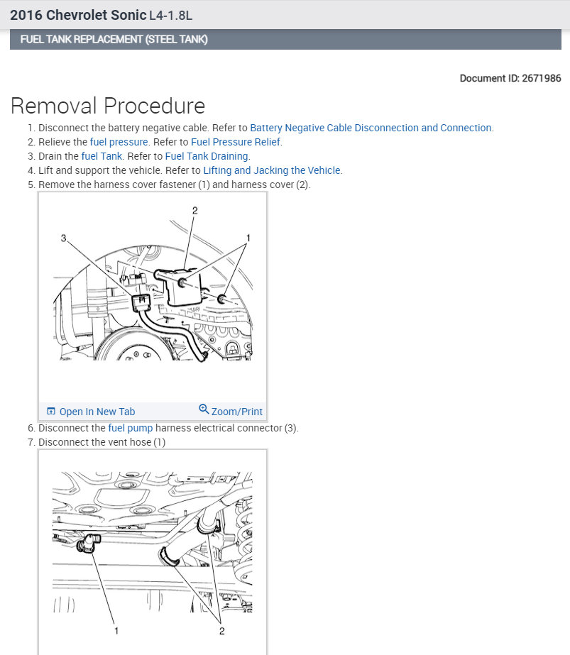

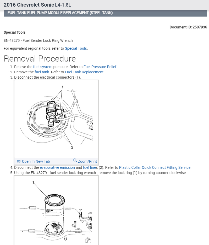

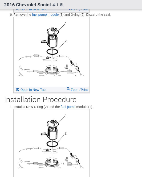

I've been looking for the fuel filter on this car all day. I have decided it doesn't have one. I'm just checking but I now believe I have to drop the fuel tank to even get to the fuel filter. There isn't access in the trunk or below the back seat. Sometimes I don't understand what the engineers were thinking when they design these things.
