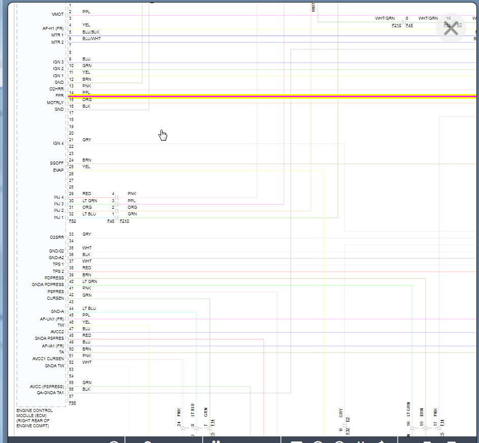

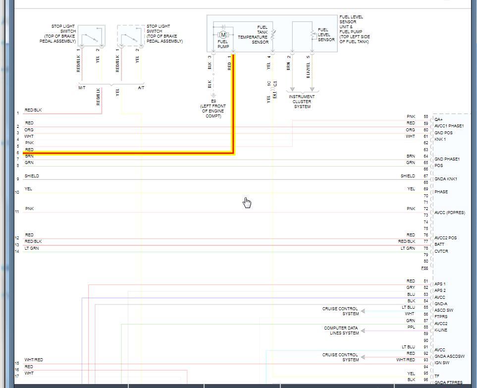

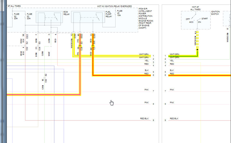

I drive the vehicle listed above S, four cylinder automatic with 90,000 miles on. I was having drivability issues and it would shut off sometimes and was running really rough after I cranked it back up. My code scanner pulled po181 and po171. One code was for the temperature sensor and the other one was a lean condition which I assumed was related to the fuel temperature sensor not giving the PCM correct data. I replaced the fuel pump and fuel sending unit with fuel temperature sensor attached and now I have no fuel pressure at all. I ordered an intelligent power distribution module which has the fuel pump relay in it new from Nissan. I am still not getting any fuel pressure and checked the connections at the fuel pump and all is good. My question is what do I check next? Is there a sensor on the engine somewhere that's telling the PCM not to send power to the fuel pump?
