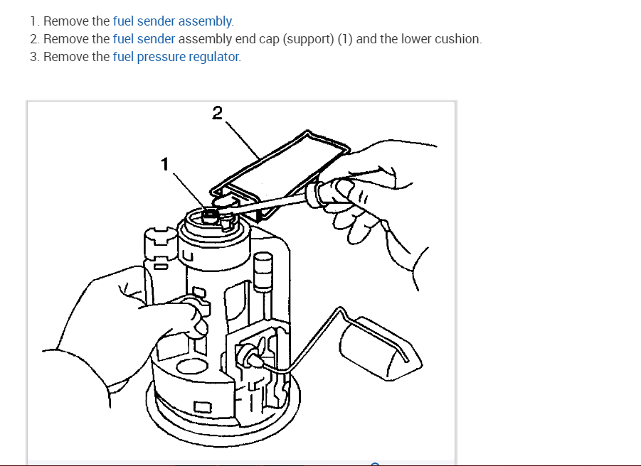

Need to know if there is s fuel filter that can be changed on the car listed above and the location.

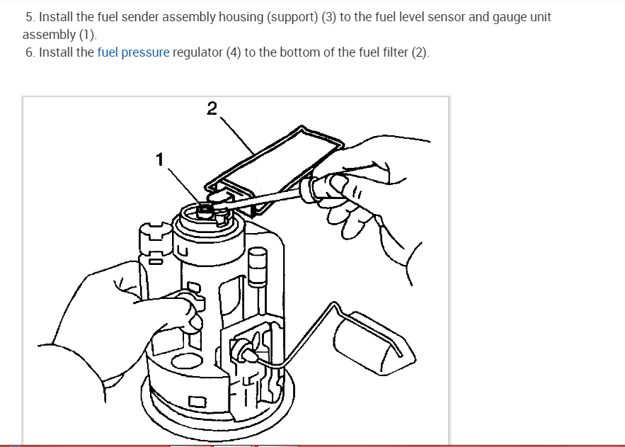

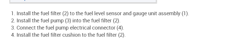

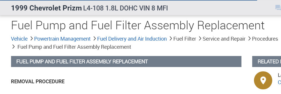

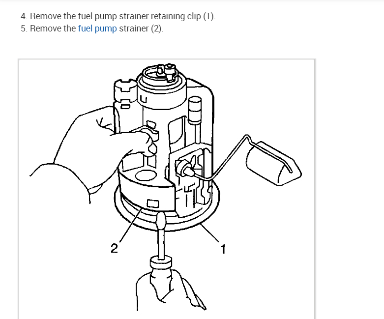

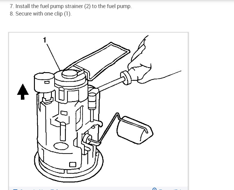

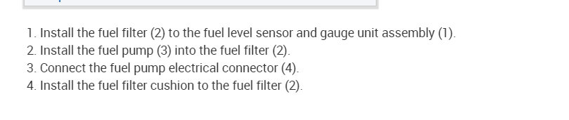

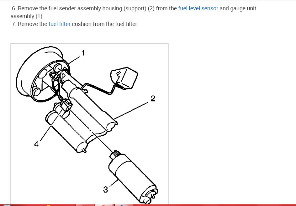

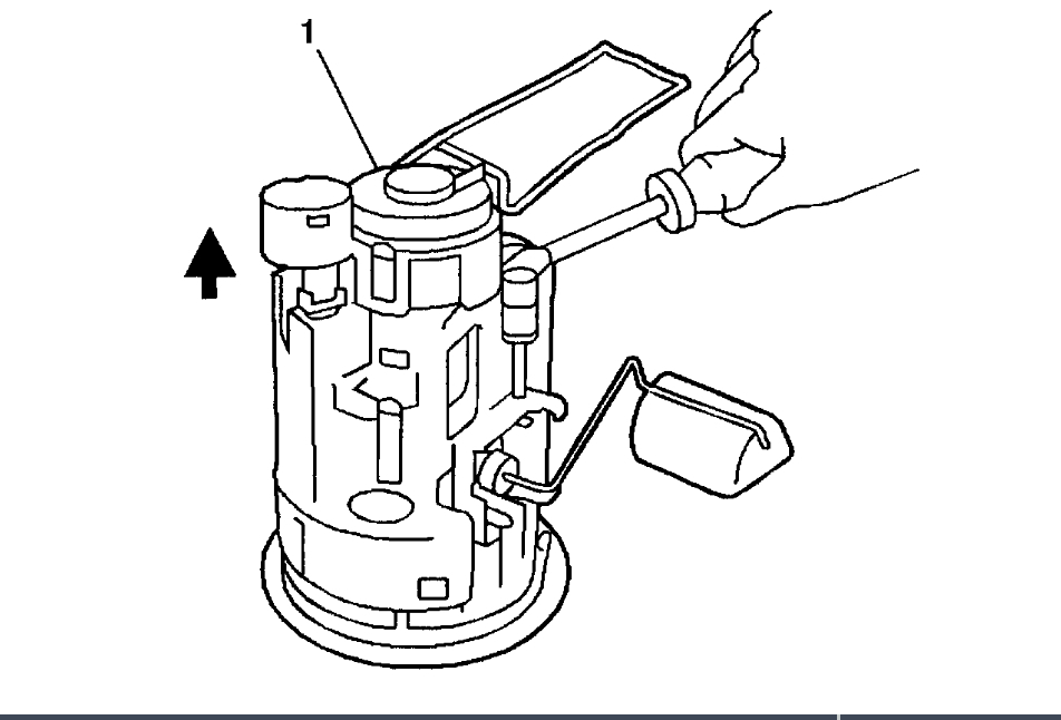

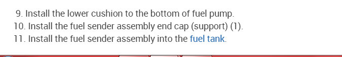

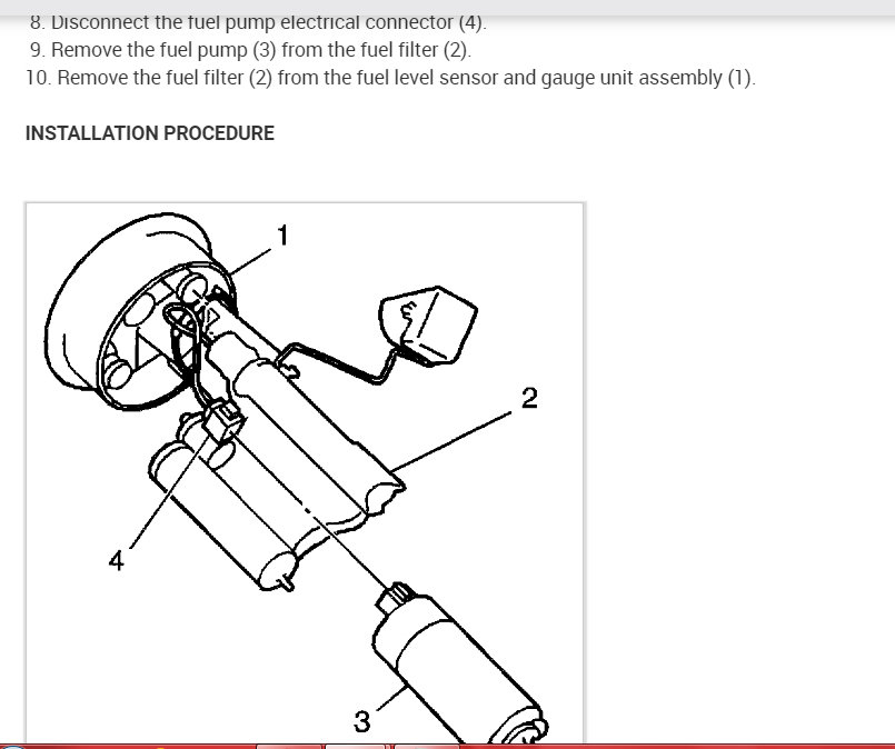

I have included the instruction guide that you requested in the diagrams down below. Please go through this guide and get back to us with how everything turns out, or if you need further clarification.
