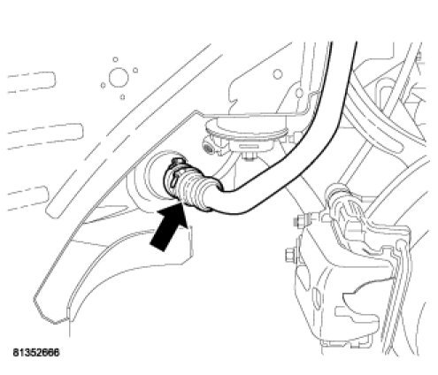

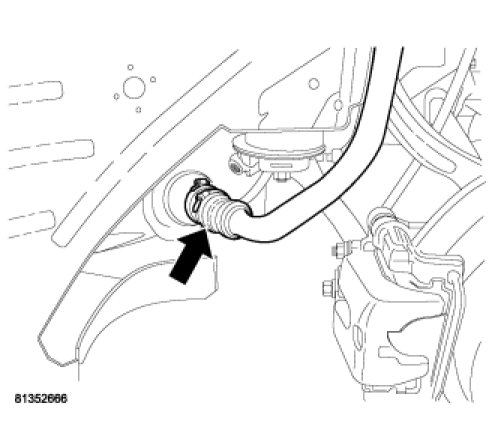

If the fuel leaks in the area where you put the pump in, there is a good chance the filler tube has rusted and there is a hole. That should cause the check engine light to come on.
I attached a picture of part of the filler tube so you can see what I mean. In the pic, you can see where it connects to the fuel tank.
