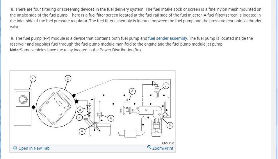

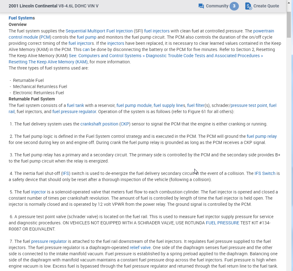

Okay, I had to replace the intake manifold gasket when I got it running the idle is poor and it set lean code for bank 1 and 2 stayed that way on a 40 mile trip. when I went to check the fuel pressure a lot of air came out when I was hooking up the gauge fuel pressure is 50lbs and it started to run better. there is no return line on this fuel system.

So do you still have the lean codes since you found 50 PSI? Have you checked the engine over for vacuum leaks? I assume that is how you found the intake gaskets but clearly lean on both banks is most likely unmetered air coming in.
https://www.2carpros.com/articles/repair-lean-mixture-codes-p0171-or-p0174-on-some-manufacturers
