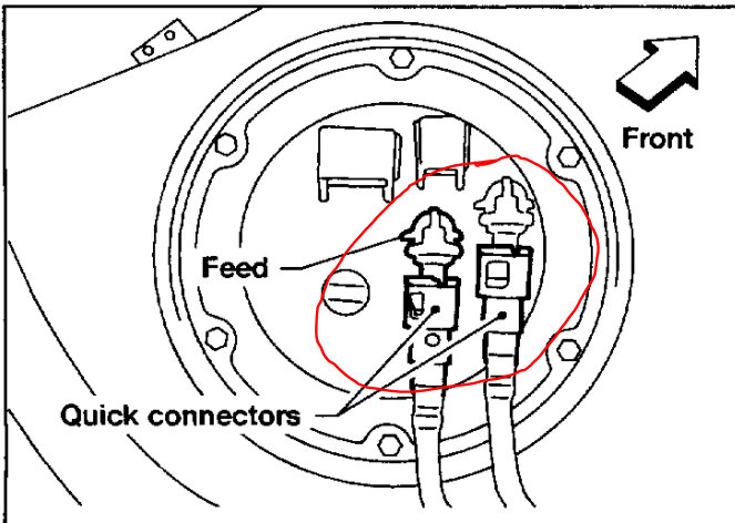

I've attached a picture below. Did the plastic nipples break off the fuel pump or did the plastic fuel line couplers break? I've circled in red.Hope this helps and thanks for using 2CarPros.

Nipples on feed where the lines hook up to.

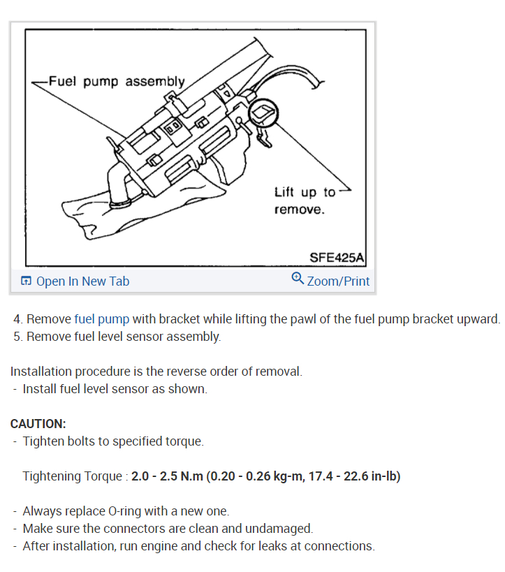

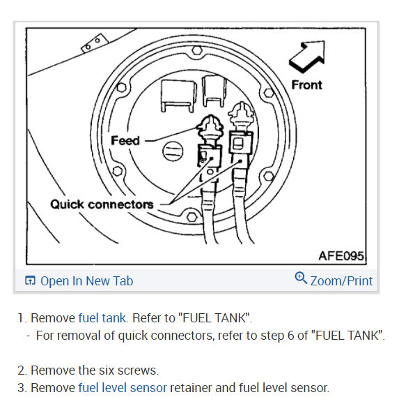

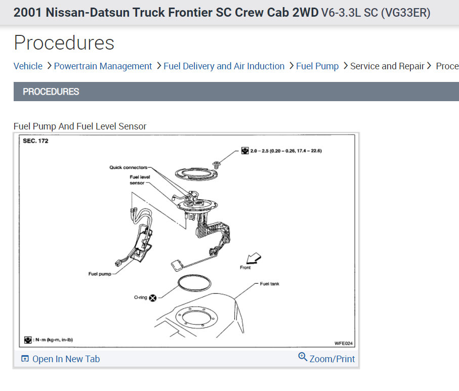

Here are the instructions on how to change out the fuel pump with a guide to help walk you through the steps:
Check out the diagrams (below). Please let us know if you need anything else to get the problem fixed.
