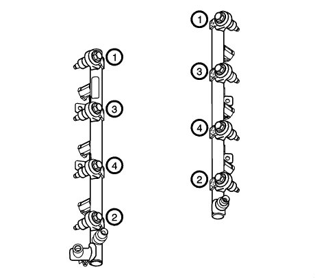

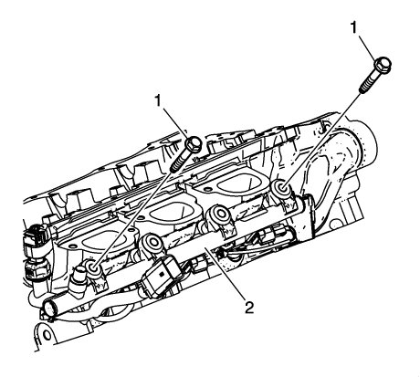

I attached two pictures of a fuel rail. That is what supplies fuel to the injectors. You will see at the end of the rail, there is a port (schrader valve). That is where you will attach a fuel pressure gauge. Most parts stores will lend you a gauge. Allow the vehicle to set for approximately two hours so fuel pressure drops in the system. When you attach the gauge, wrap a shop towel around the connection to capture any fuel that is released. Also, I suggest wearing eye protection. If the pressure is less than the specifications, the pump may be weak or you could have a clogged fuel filter.
