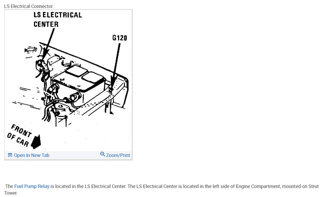

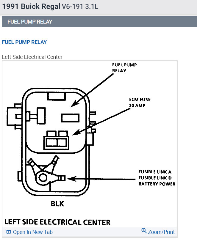

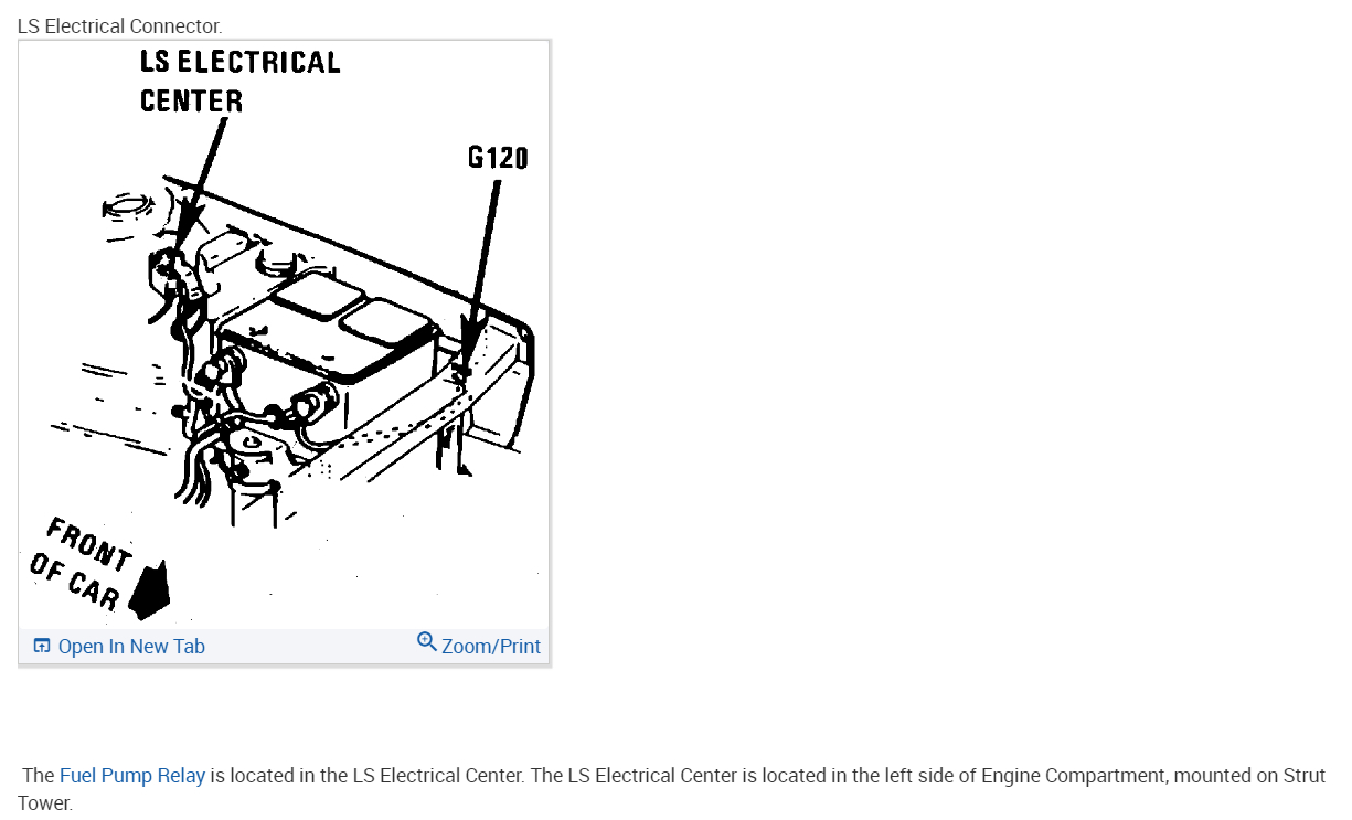

It sounds like you have a defective fuel pump, but I would swap out the fuel pump relay. Here is the location. If that doesn't work replace the fuel pump.
