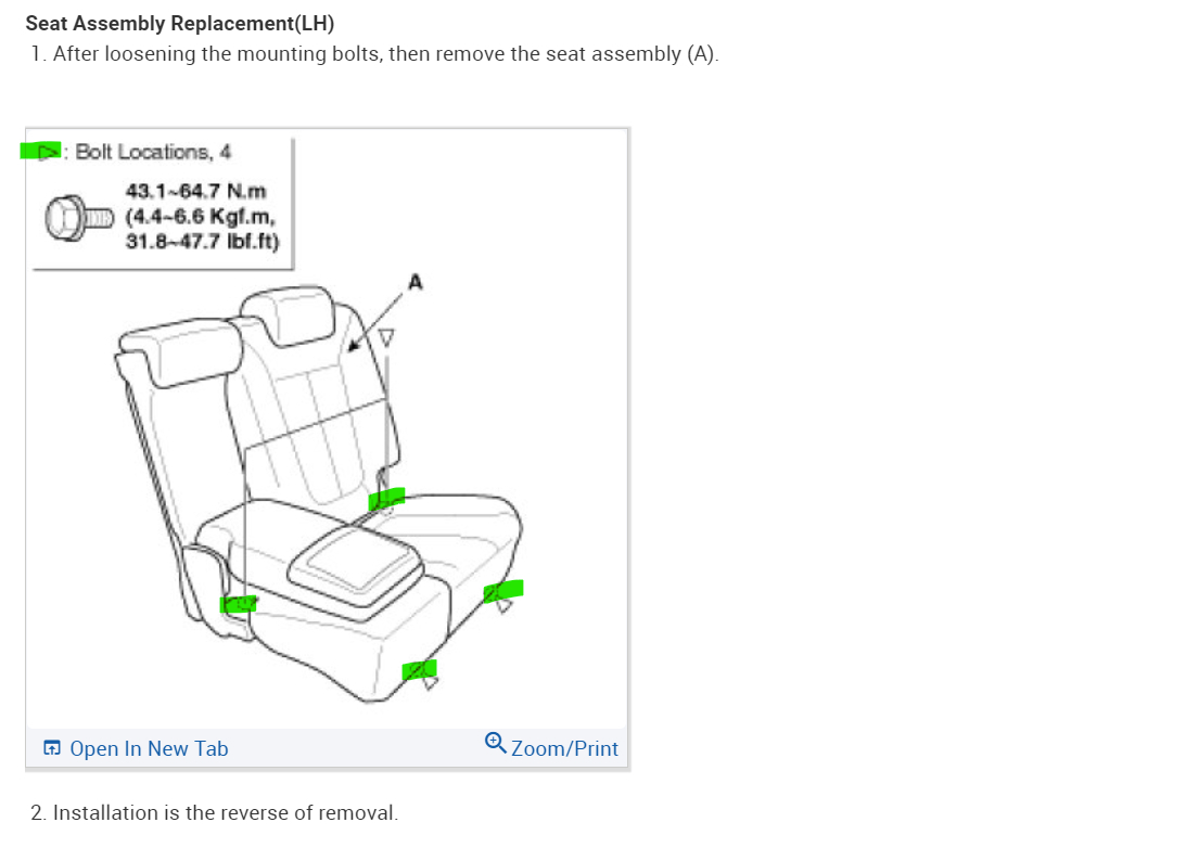

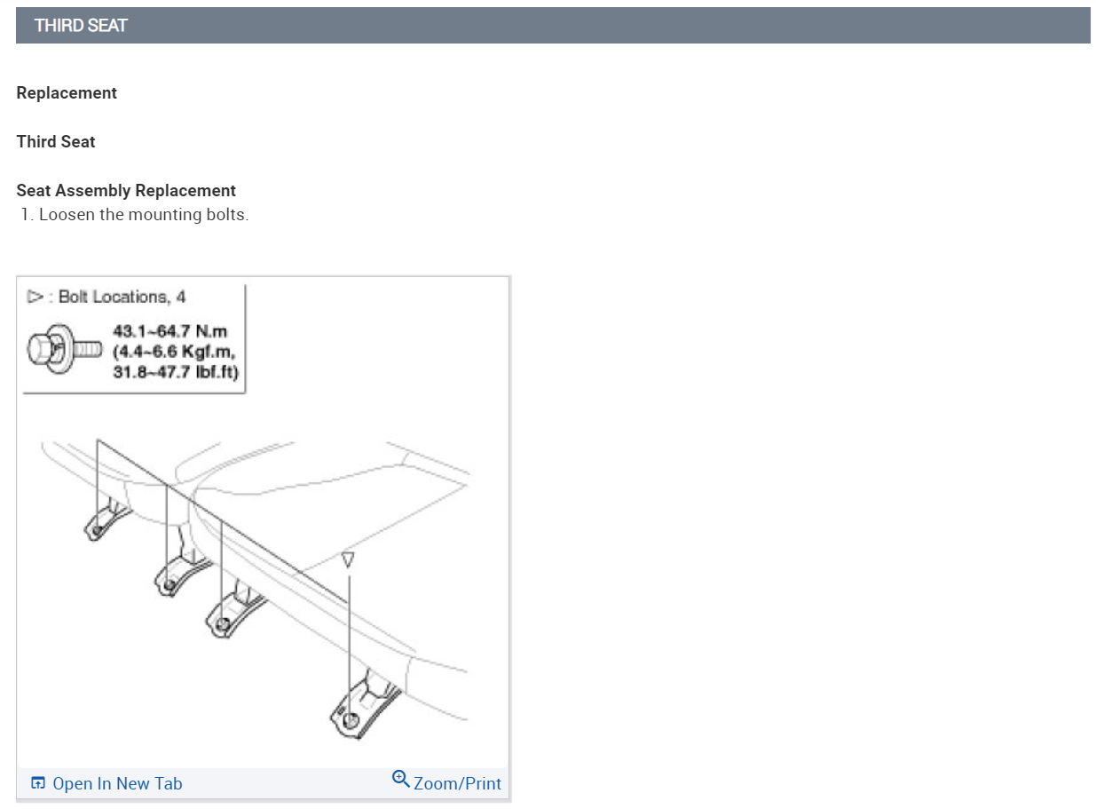

My gas gauge doesn't work, and I've figured it was the sending units in the back seat. I have the correct sending unit. I watched a YouTube video on how to replace it. In the video it showed them taking off the rear plastic and extra storage covers in order to remove the back seats. Do I need to do all that or just remove the rear seats to get to the access panels?
