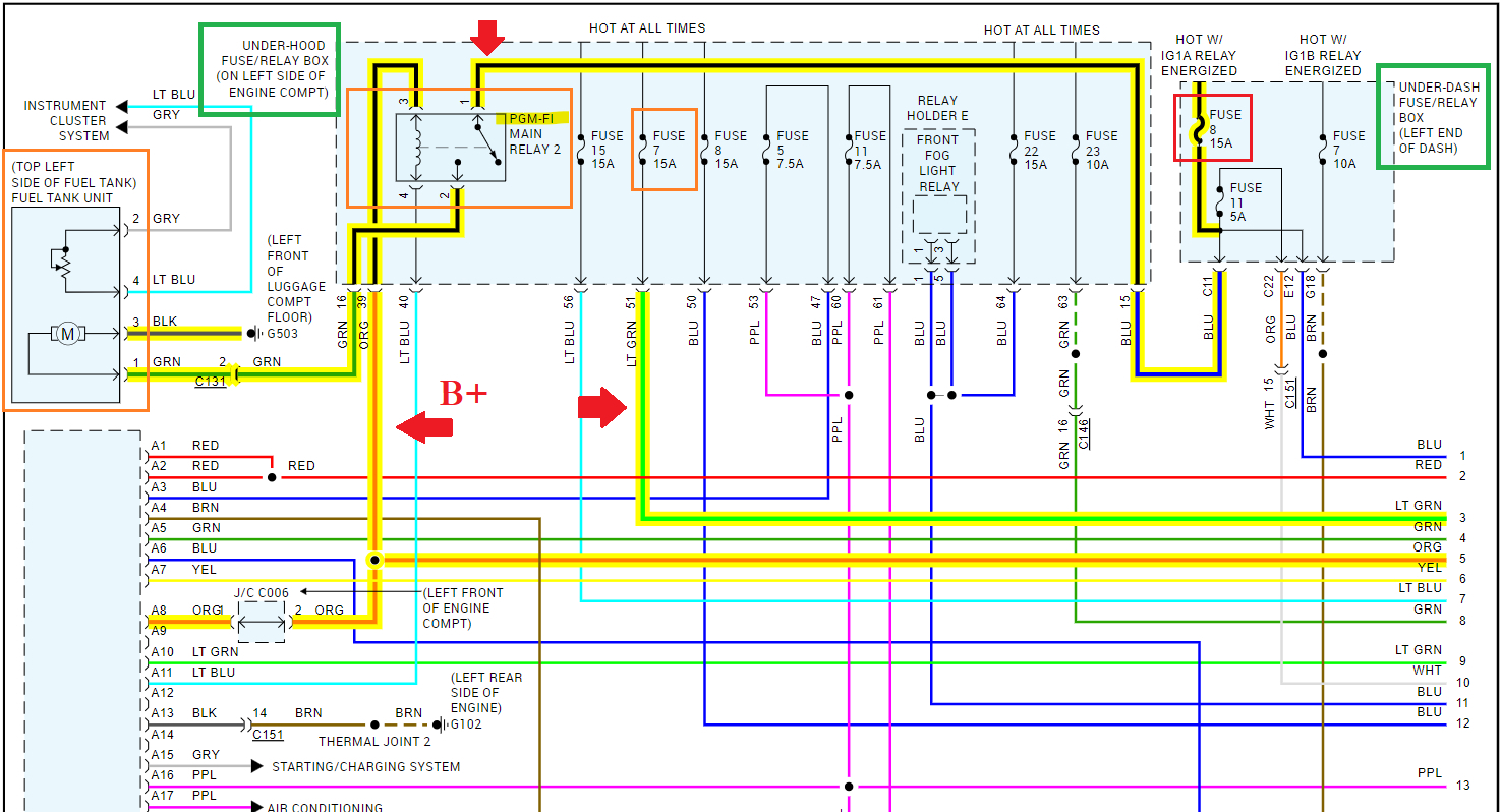

I was driving my vehicle and all of a sudden it turned off. The vehicle cranks but won’t ignite. I think it might be a fuel relay or the fuel pump. Can someone tell me where I can find the fuel relay? I can’t seem to find a diagram online for this.

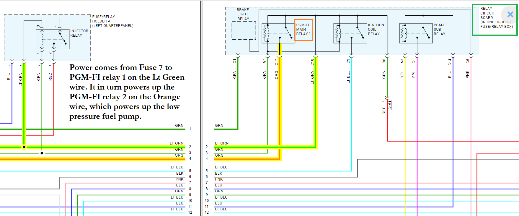

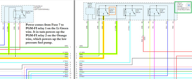

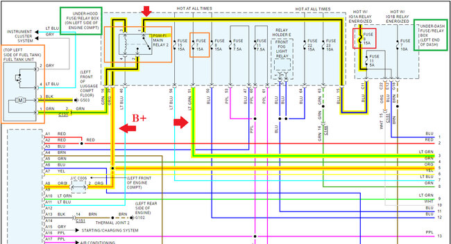

The low-pressure pump is powered by the PGM-FI Main Relay 2, I'll post a diagram for it, there will be a plastic or rubber fuel line coming into the high-pressure fuel pump, and that's where you would take a fuel pressure reading to check if the pump in the tank is working.
But the first thing to do is go through and check all the fuses, there are 2 PGM-FI relays that power up many components, along with the low-pressure pump and ECM. So, see if any fuses are blown first, write down which ones are if any, and we can help you from there to figure out what's going on. But if you still have a warranty, I recommend taking it in and letting the dealership repair it.

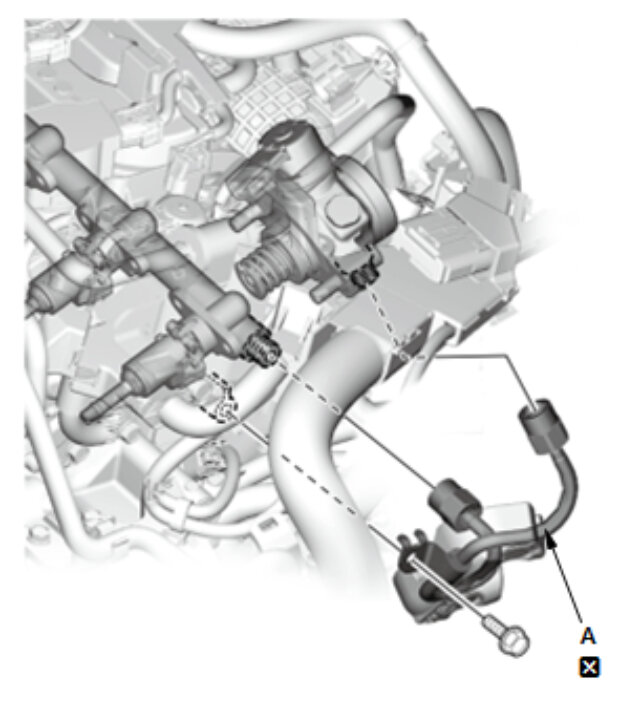

The 3rd diagram is of the high-pressure fuel and fuel rail, do not unbolt these lines, they are usually a onetime use as well. It takes a trained technician to work on these high-pressure systems.
