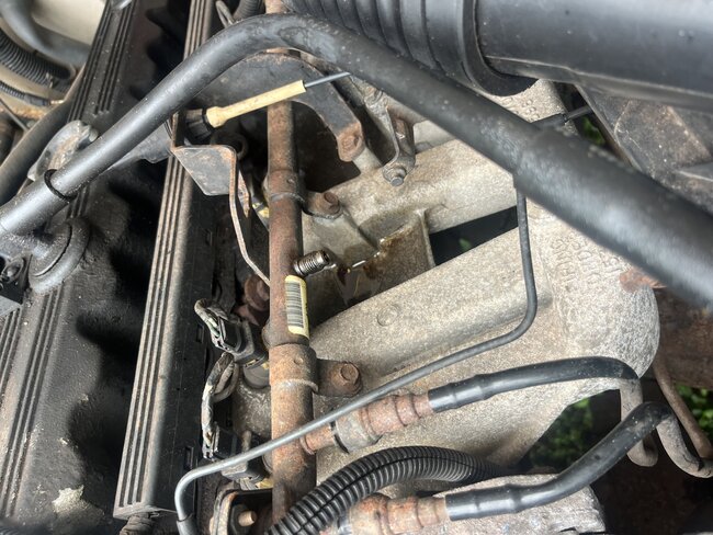

I notice a leak coming out the fuel rail connected to the injectors . I’ve also noticed that it’s missing a cap where the fuel is leaking . My question is , is it leaking because the caps missing ? Where can I find this screw on cap? I’m hoping it’s just a cap issue otherwise I’d probably have to search for a fuel rail I wouldn’t know what to look under when searching . If I can pick up some type of cap from Napa . I’ve attached a photo of what I’m talking about thank you
