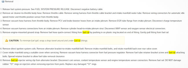

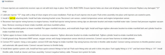

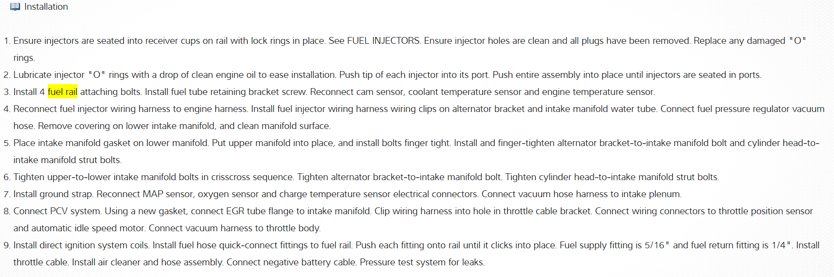

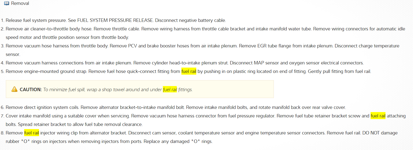

I would not recommend patching up any part of the fuel system. Gasoline is highly flammable and a leaking fuel rail is a good way to start a fire. I have included in the diagrams below instructions for the removal and installation of the fuel rails for your vehicle.
Thanks,
Alex
2CarPros
Feb 12, 2019 at 2:04 PM
