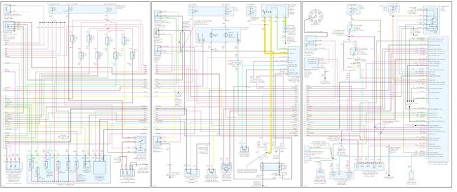

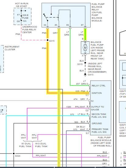

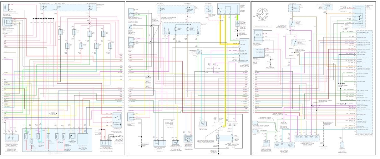

The two second prime comes from the PCM. It is sent to the fuel pump through the relay and the module on the left front frame rail.
I attached a wiring diagram of the pump for you to view.

So my problem must be between the relay and the PCM (or the PCM itself) since the vehicle runs well once started. Thanks.
Aug 29, 2019 at 7:26 AM
That is correct. My bet is the PCM.
