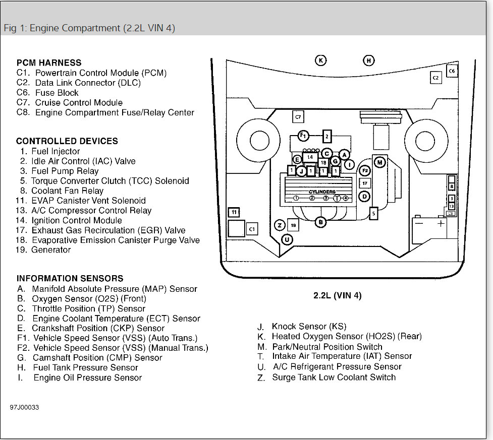

Trying to find out if the 1997 have a fuel pump cut shut off switch.
Feb 24, 2019 at 5:13 PM
SCGRANTURISMO
  • 4,897 POSTS
No it does not. If you are looking to stop the fuel pump, take out the fuel pump relay. I have included its location in the diagrams down below.
