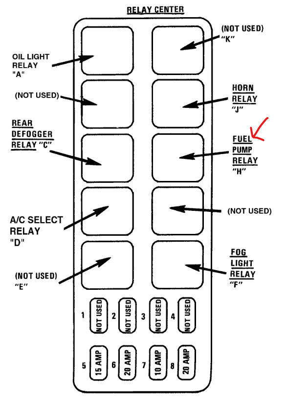

I would check the fuses and if okay swap out the fuel pump relay, here is the location and a guide to help:
