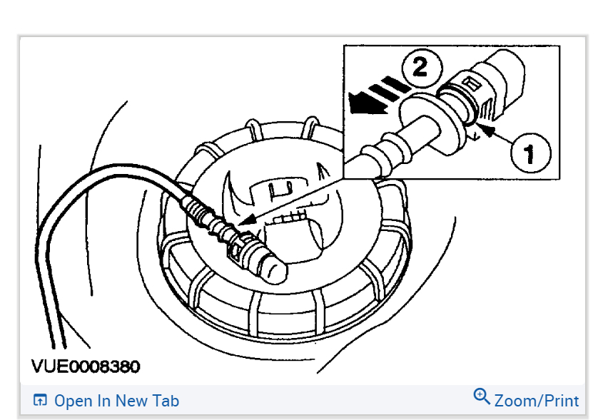

Hi Ed, thanks for visiting 2CarPros.

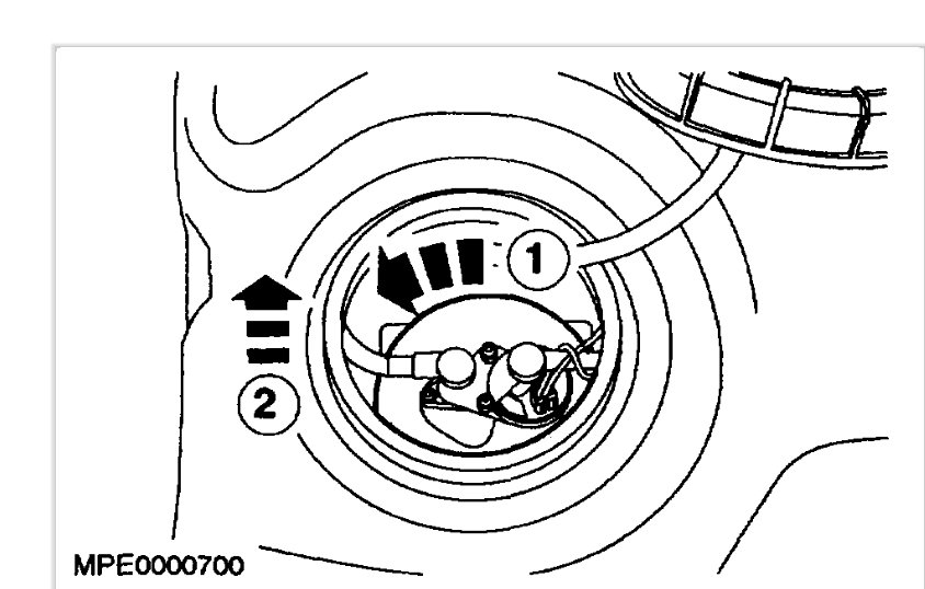

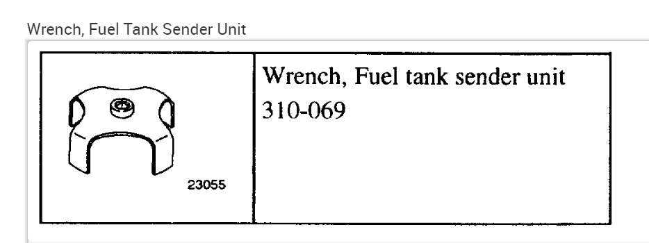

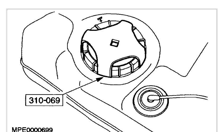

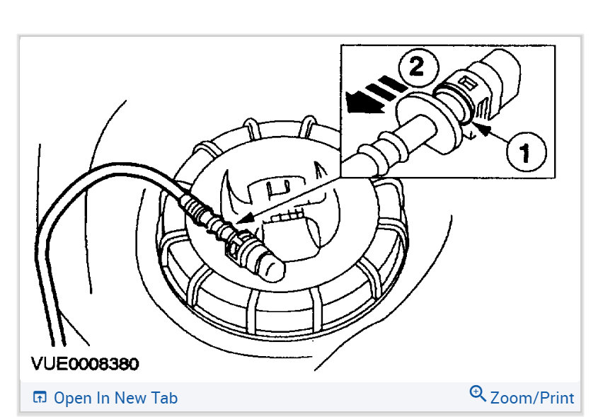

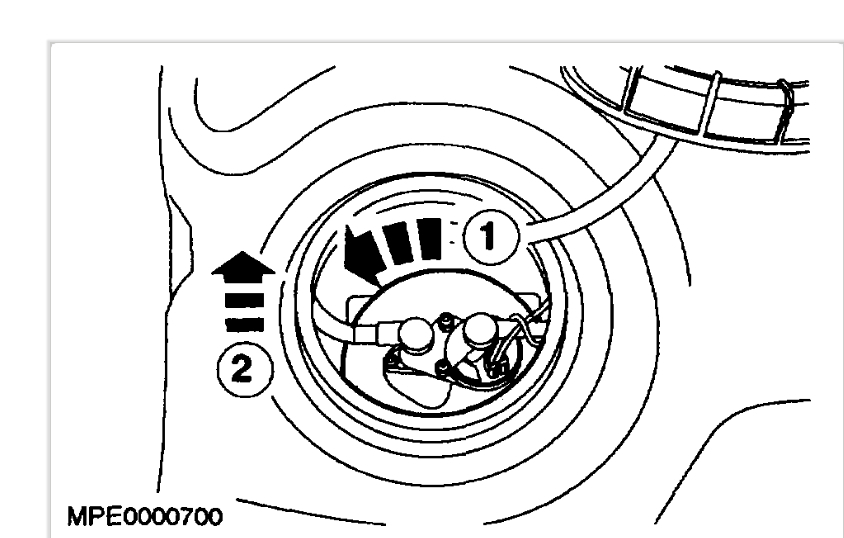

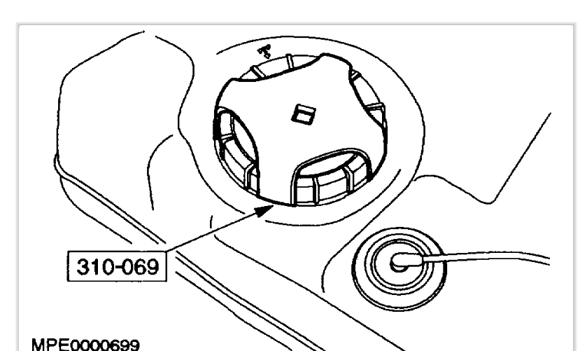

You may want to get the vehicle higher. You can leave the front tires on the ground and chocked and try to get the rear twelve to fourteen inches high. This will give you room to get under it and slide the tank out. using your jack with a scrap of wood in the middle of the tank to support it is a good way to go if you don't have help.
Loosen the bolts retaining the two fuel tank straps, the filler neck hose clamp and vent hose clamp. Slowly lower your jack while using a screwdriver to push the filler and vent hose off.
once you have the tank down you'll need to remove the fuel supply line. Then using the special tool listed or a brass punch and hammer the top cover. You can then remove the lines and fuel pump module. I'll post some pictures below for you.
Regarding the clacking noise, this is usually due to low battery charge.
