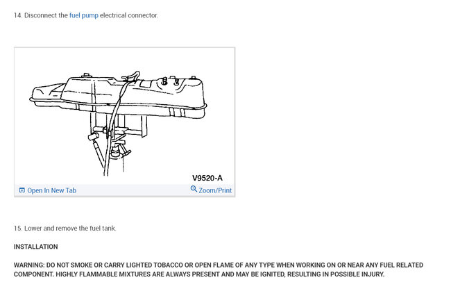

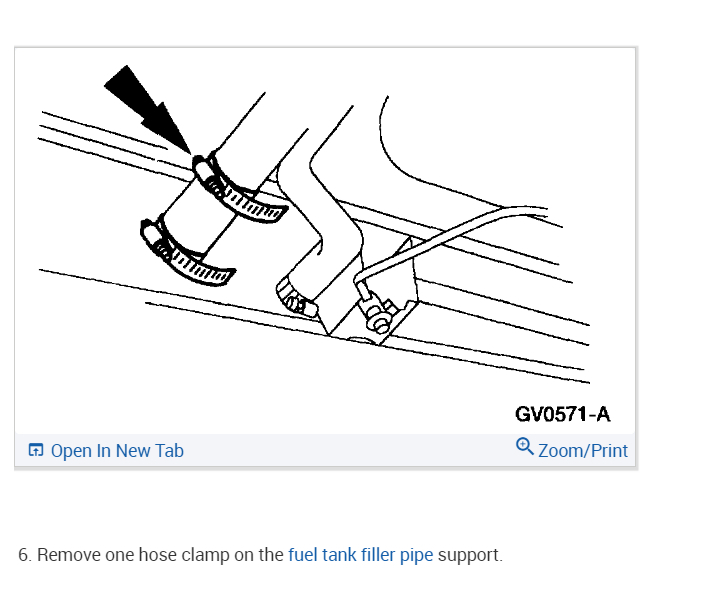

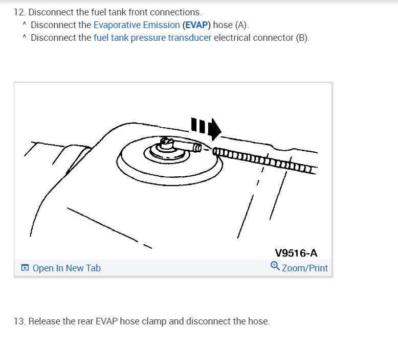

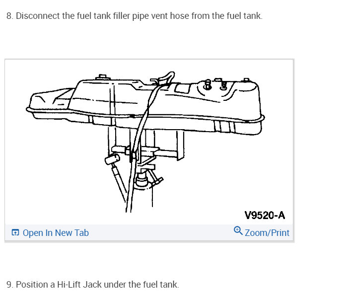

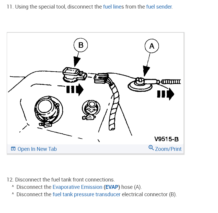

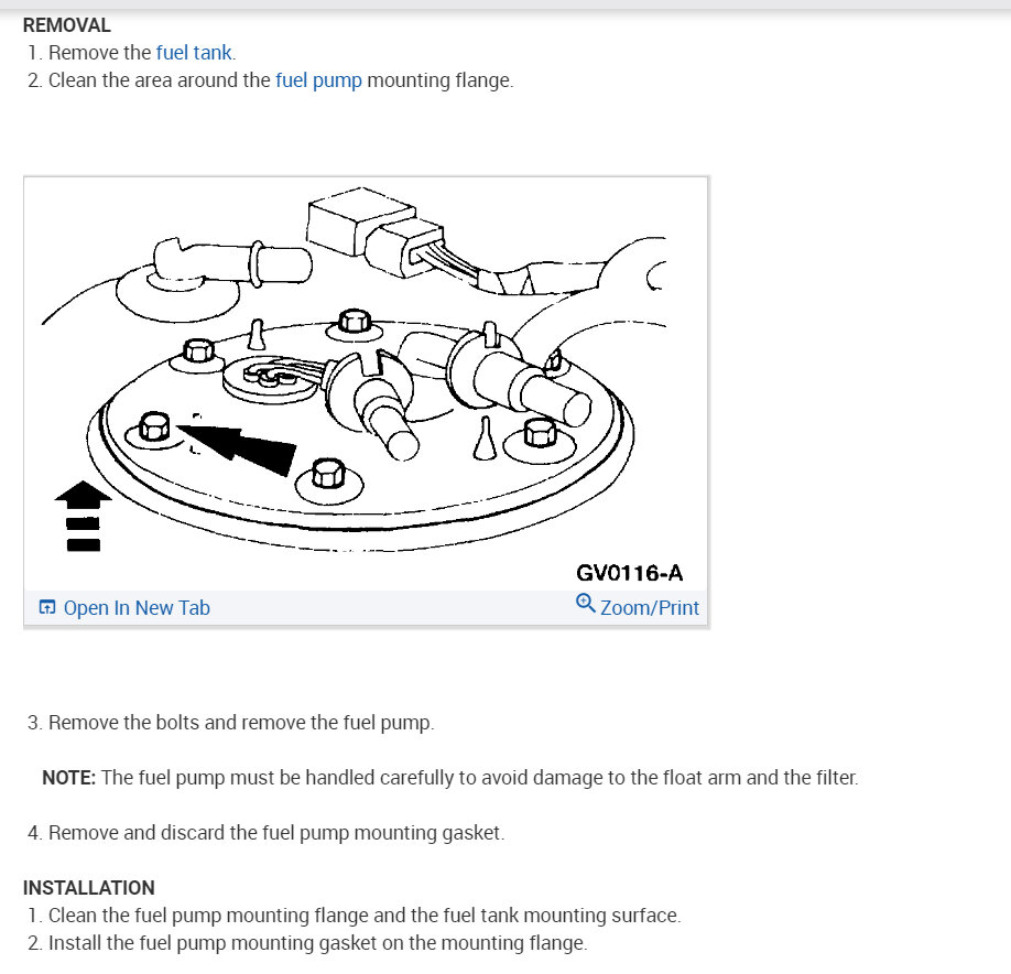

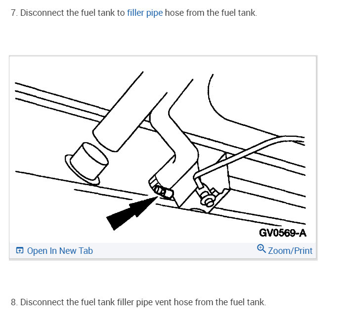

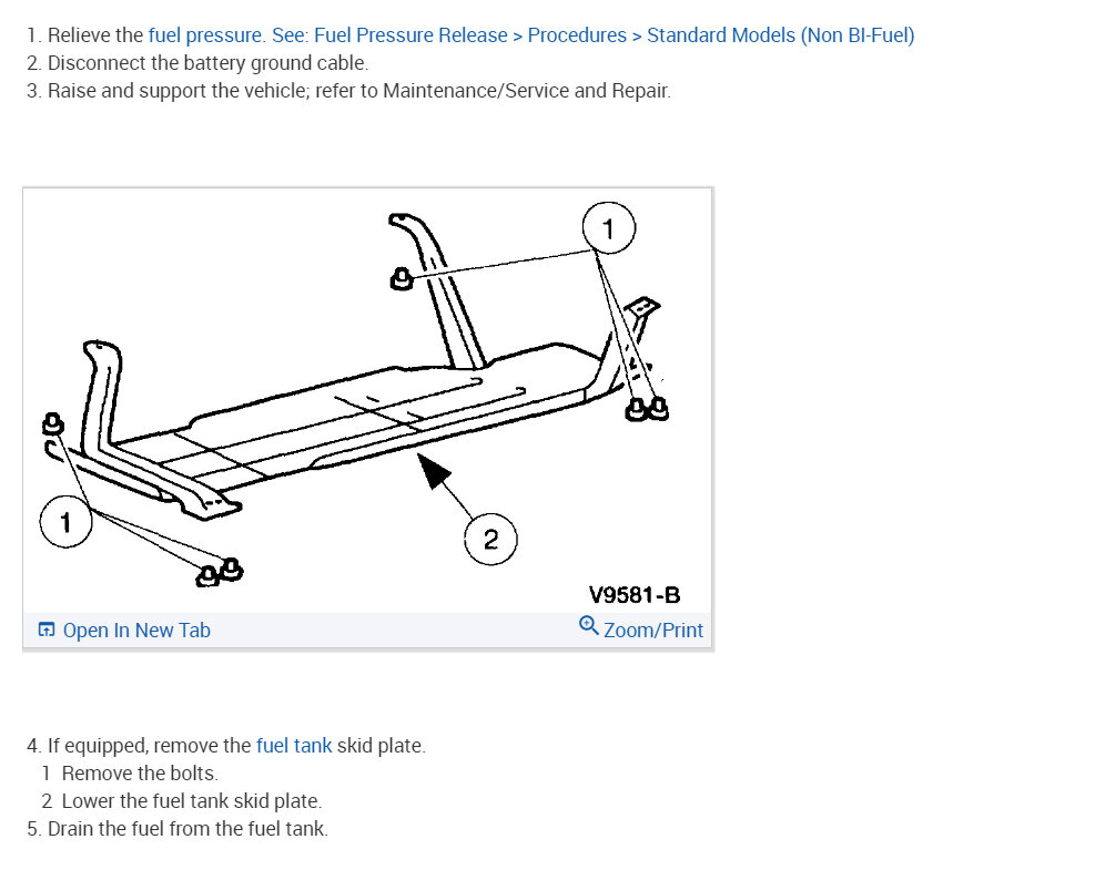

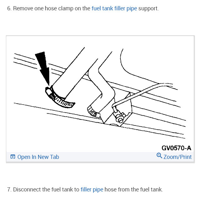

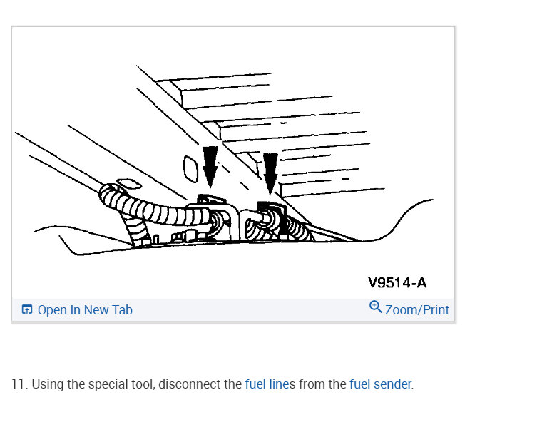

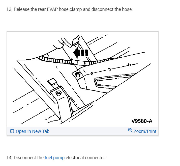

We don't know that information, but I can give you how to replace the fuel pump step by step without cutting a hole in the bed. Here is how to drain the fuel out:
https://youtu.be/Q5MH2gnyFH0
Here is a generic guide to help walk you through the repair with instructions below to show you how on your truck:
This video will show you how to remove the fuel lines:
https://youtu.be/Boi0DPXVHbM
Feb 25, 2023 at 12:19 PM
