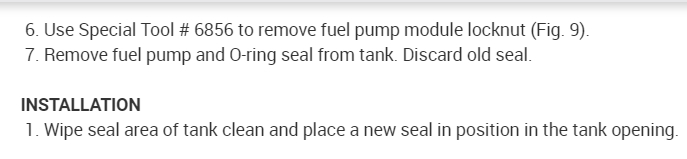

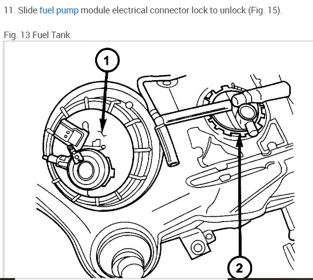

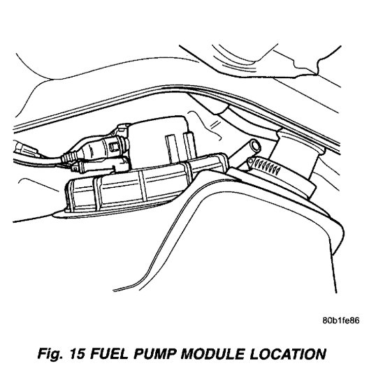

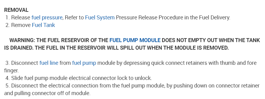

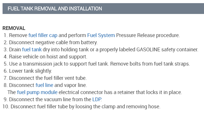

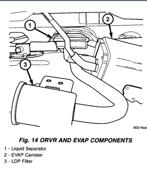

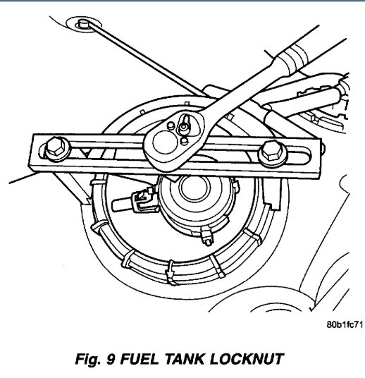

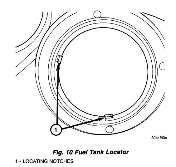

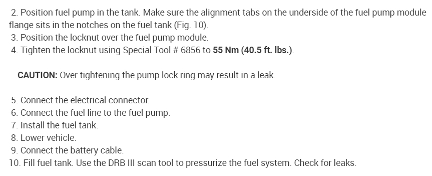

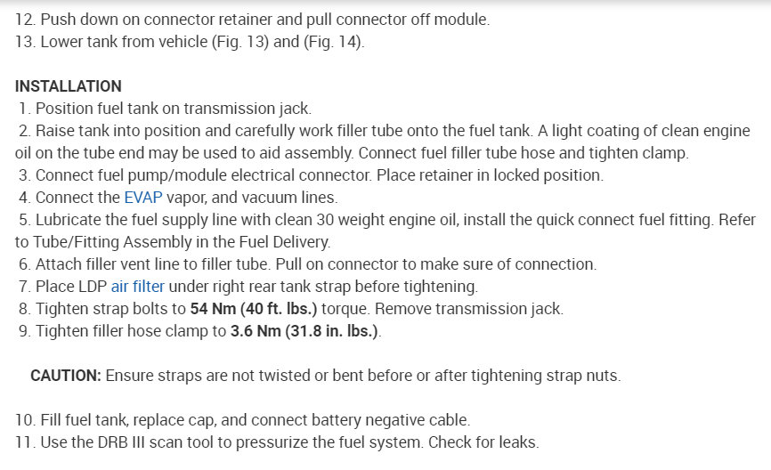

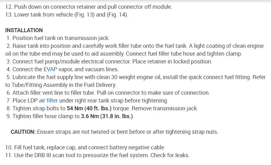

Thank you very much for the information about the fuel pump! The replacement solved the problem. Now if I could ask another question pertaining to the right rear brake pads dragging on the same vehicle-2001 Sebring convertible 2.7. This is my Grandson's vehicle so I only see it when he has an issue. The right rear brake stayed partially applied and when he arrived the pads were wore down to the metal. I replaced the pads, rotor and caliper after removing all rust and build up that may have interfered with the movement of any contacted new parts, everything moved freely as it should have. Fast forward 700 miles. He arrived again with the same issue. The brake components were so hot the caliper piston boot melted. I took all parts back and had them replaced under warranty and installed them. Fast forward 1,000 miles , I checked and the pads on the the brake - half gone, the driver side pad were replace at the same time and are not noticeable worn. I checked the rotation of the tire and noticed a slight drag, then took the tire and rim off and checked the rotation ,there was drag and the caliper had free movement ,but the pads and rotor moved with the caliper. I then again took all parts off and looked for anything that may have obstructed brake fluid flow. I found nothing. I checked to see if the flow from the other rear brake was the same when loosening the bleeder valve and it appeared the bad brake line was similar, possible a little slower. I tried to trace the line from the caliper to the reservoir but could not. then took off reservoir cap and put 110 ponds of air pressure into the brake line to see if it may have restrictions. the reservoir did not rise. I'm baffled? Any suggestion would be appreciated.
