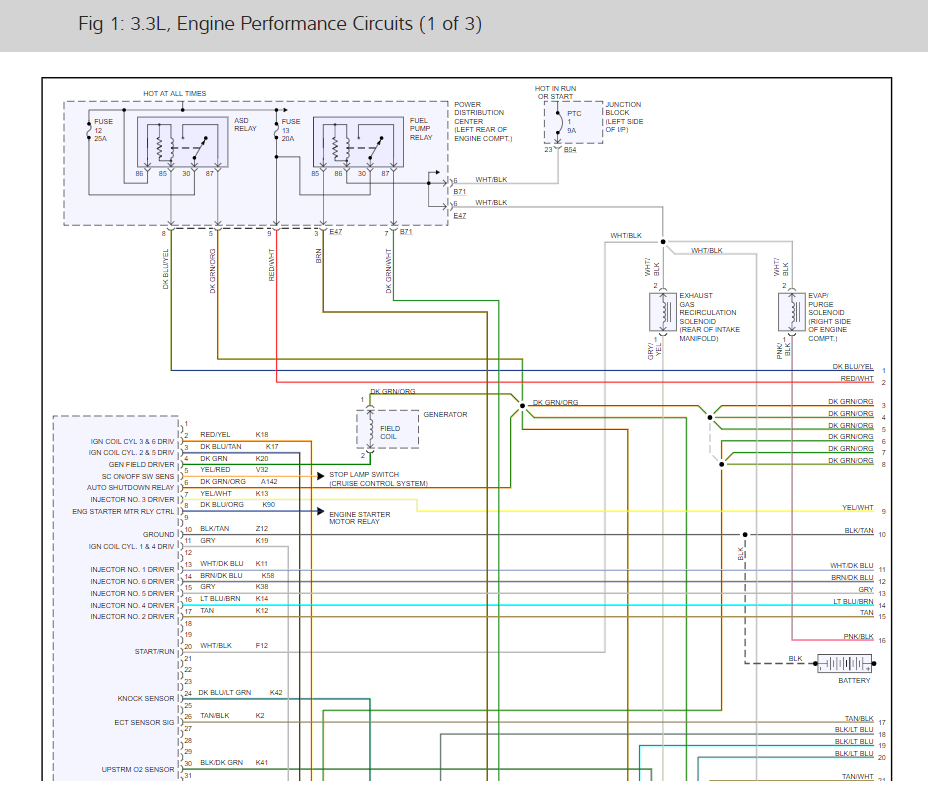

My fuel pump went out and i replaced it with a new one and it still wont start it seems its not getting any power to the pump i checked the fuse and relay and there good what could cause the new fuel pump to not have power or not start.
