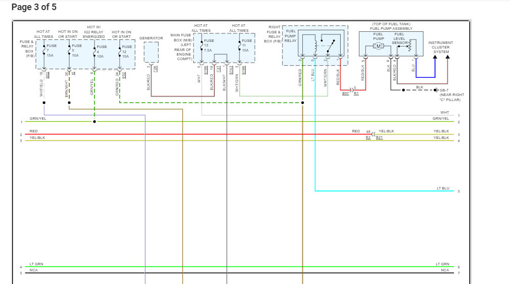

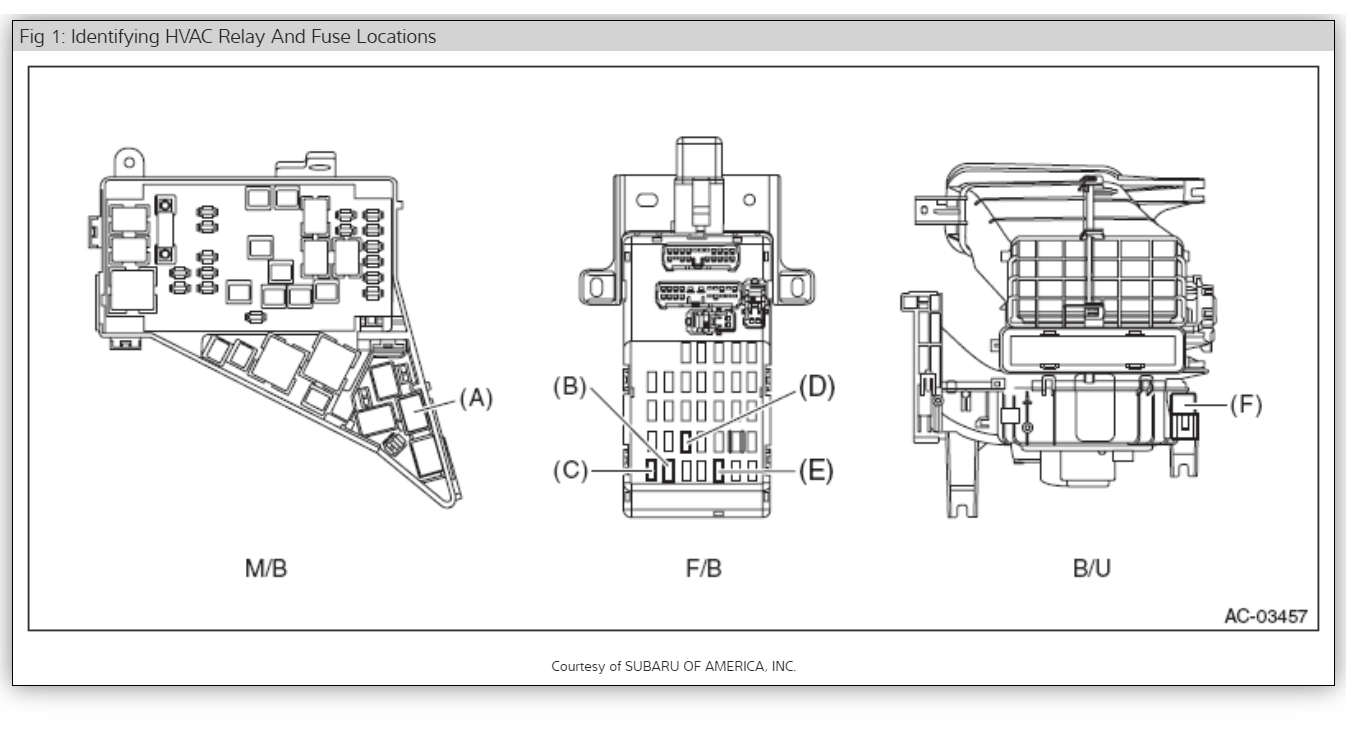

The fuse pump relay is located at the right fuse and relay box. It should say in the fuse panel cover. In the diagrams below shows the location of the relay though don't pay attention to the A marking that is for the HVAC system. I can't find the exact location but here is the relay in the engine wiring diagrams. Check out the images (below). Please let us know what happens.
