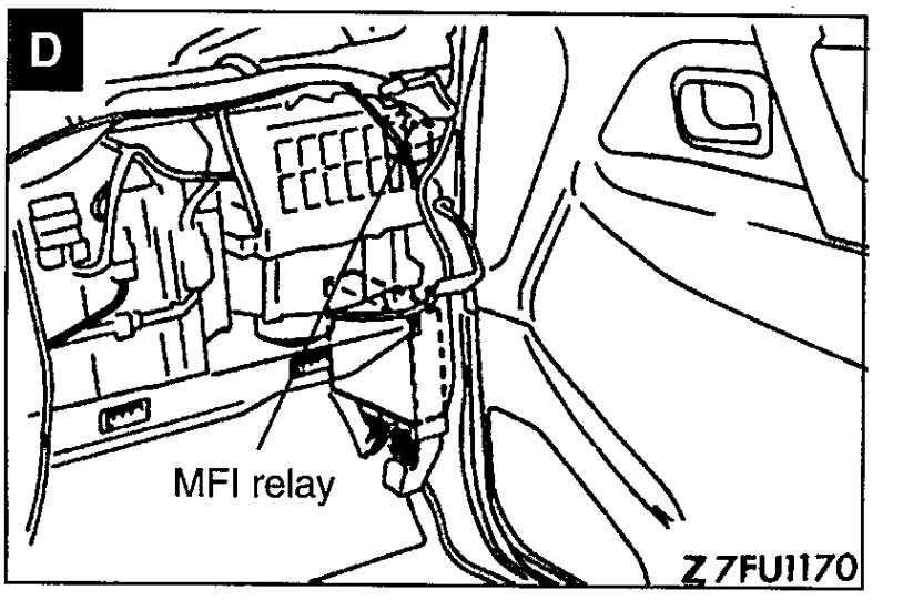

I don't have power to the pump no sound crank but no start.

On this vehicle, the Multiport Fuel Injection (MFI) relay provides power to the ECM and the fuel pump.
If you look below, it appears the relay is located under the dash on the passenger side of the vehicle.
joe
See pic below.
