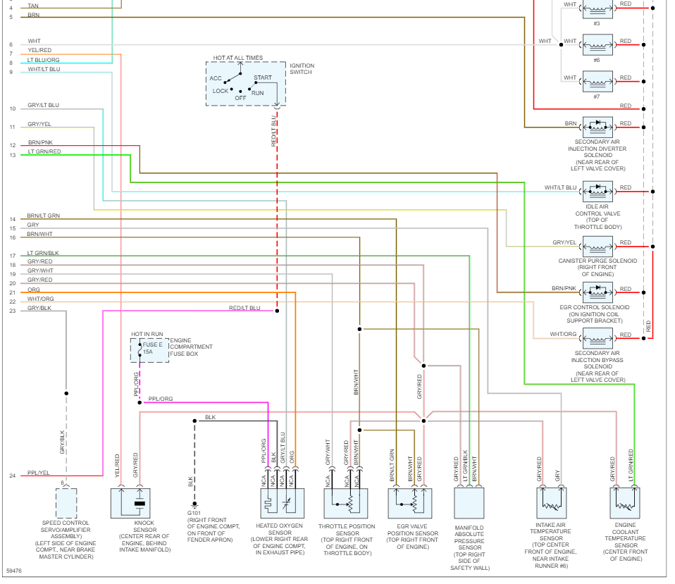

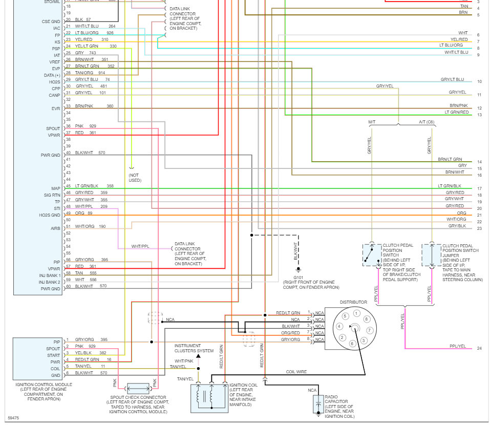

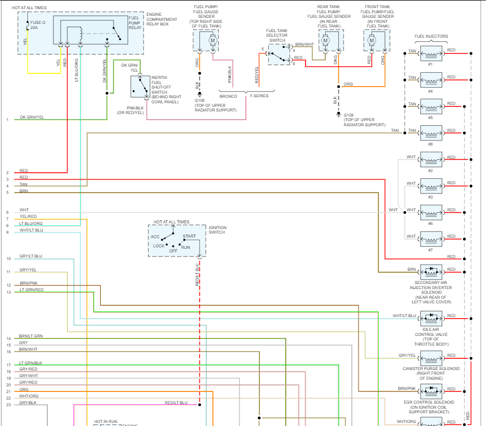

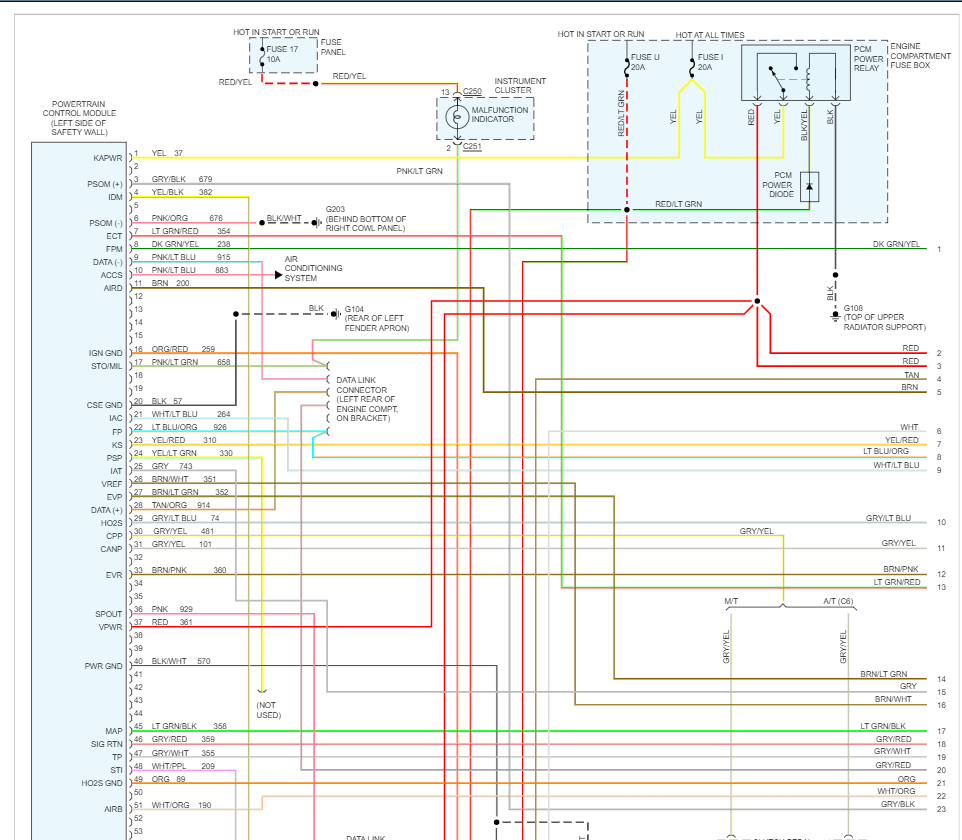

Did you install a new PCM power relay? Here are the wiring diagrams for the PCM and a guide to help check for power and grounds. I would start by unplugging the injectors because you may have one that is shorted which will cause the PCM to dump voltage.
Check out the images (below). Let us know what happens and please upload pictures or videos of the problem so we can see what's going on.
