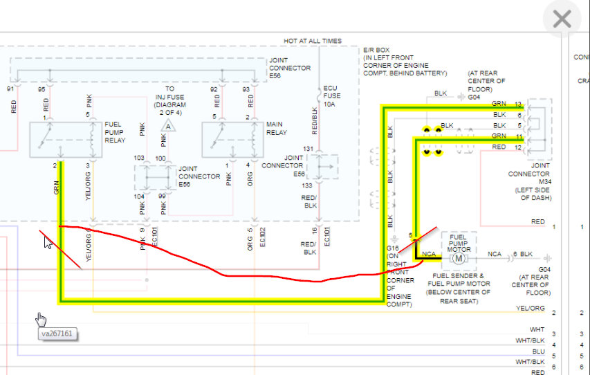

thank you for your comment.i have checked fuel pump voltage and when key is off there is no voltage so i don't think it's jumped. this problem occured about 2 years ago and getting worst since. i have a acceleration problem too because of this and from all diagnostic checks that i have done i am sure the problem is just this. i think its short to something but how can i find where? I'm thinking about rewiring fuel pump with new wires and put fuel pump out of relay box because the wiring of relay box is old and complicated. do you think it's good idea?if not how can i find the short?
Jan 3, 2021 at 11:42 PM

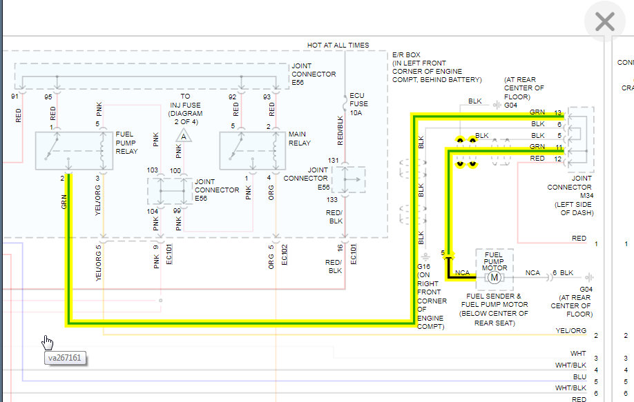

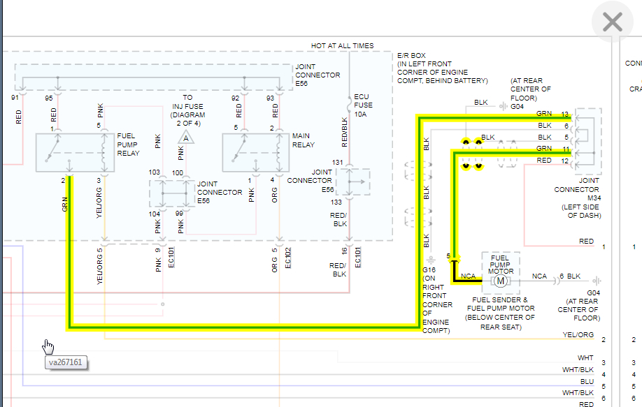

I think that is exactly what you should do. I would just access the power wire from the relay at the bottom of the fuse box and run it directly to the fuel pump. This would eliminate any other possible wiring issue. Just cut the wire and connect the new wire to the connector side of each end. I attached a diagram below where I illustrated this.
