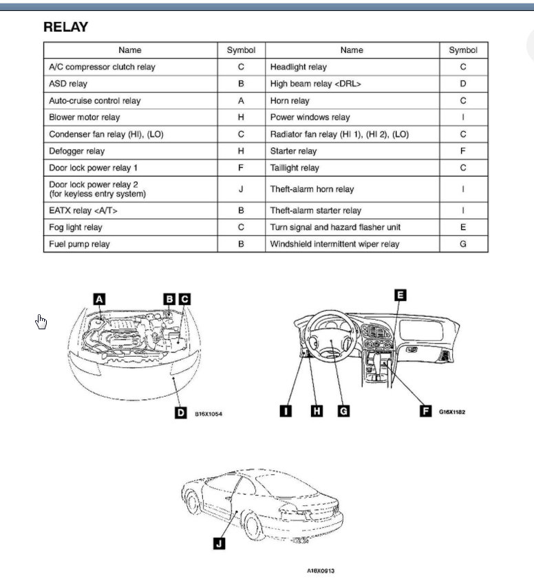

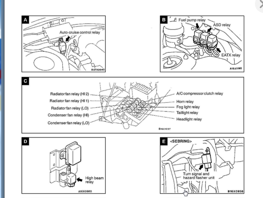

I have replaced the crank shaft sensor, the distributor that has the camshaft sensor built in, fuel pump, (I can't find the fuel pump relay). I have noticed that when you turn the key on it doesn't kick. the check engine light on and then it would go out... To my knowledge if that is happening it's your computer is that correct? I know I have put $400.00 for parts in this car and it has not helped anything...
