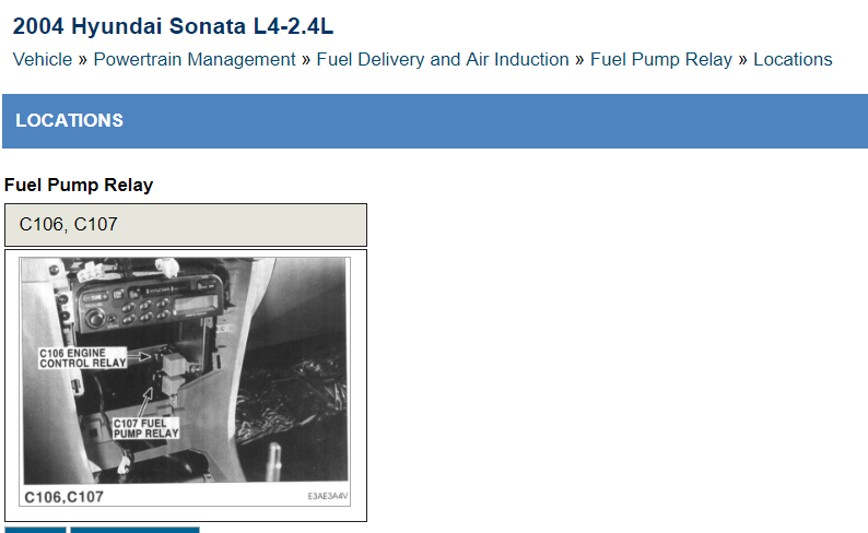

The fuel pump relay is not located behind the radio. would there be another random location that it would be in?
May 1, 2018 at 11:51 AM
Good afternoon.

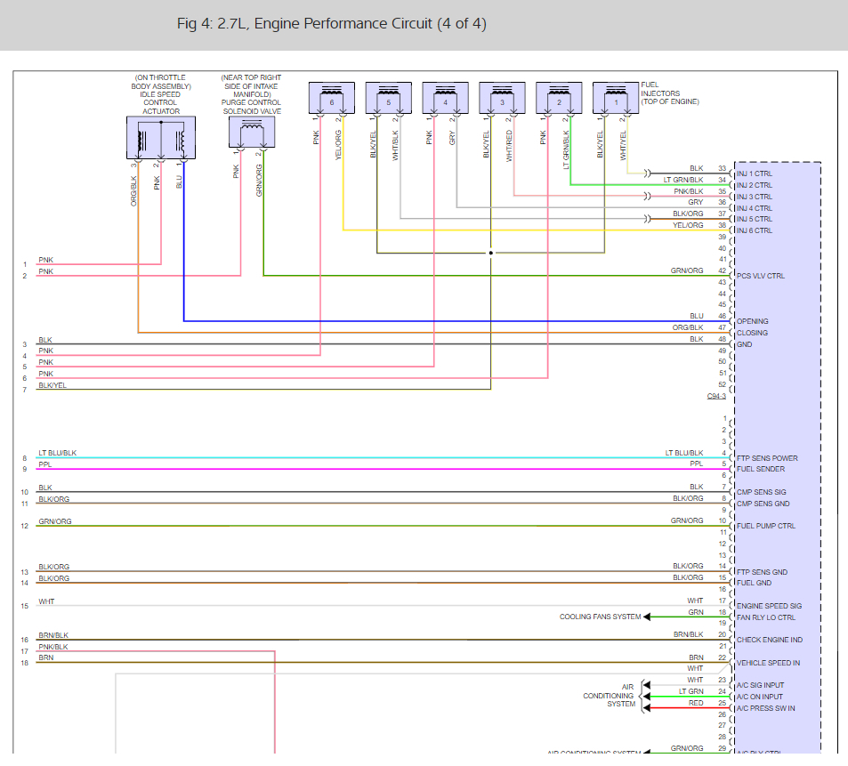

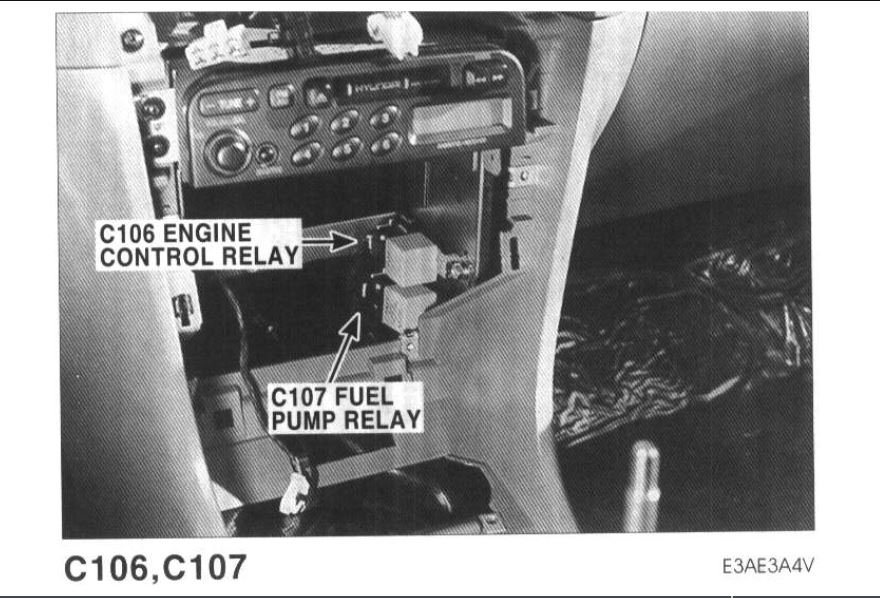

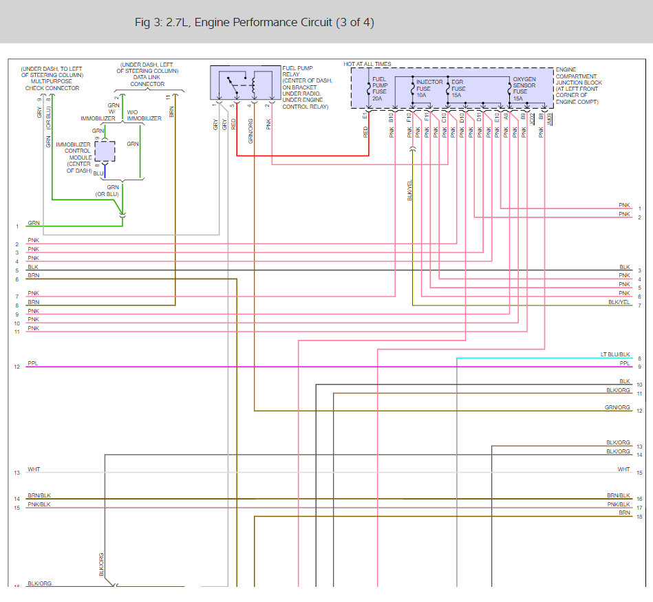

It is below the radio it is called the engine control relay on the 2.4 liter engine. Here is a guide to help test it with the relay locations in the diagrams below.
May 1, 2018 at 12:58 PM

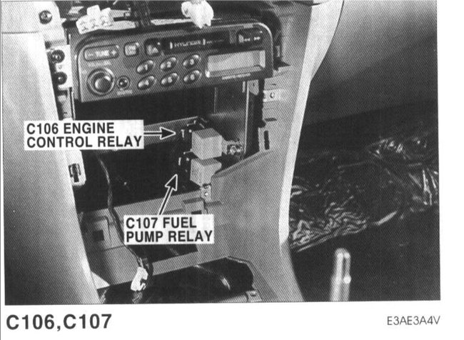

i have an 04 sonata 2.4 automatic. i am not getting fuel to the motor. no power to the fuel pump. i do have power at fuel pump fuse. i have looked for relay and was told it was under the radio , i did find one relay but i am unsure if it is it. how do i test it ? i do know the fuel pump is good . by the loss of power to the pump i am assuming it would be a relay, am i correct.

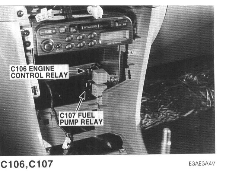

The relay is located under the radio. Here are some guides and diagrams that will help you get the problem fixed. https://www.2carpros.com/articles/how-to-check-an-electrical-relay-and-wiring-control-circuit and https://www.2carpros.com/articles/how-to-use-a-test-light-circuit-tester
https://www.2carpros.com/forum/automotive_pictures/12900_fp_relay_21.jpg

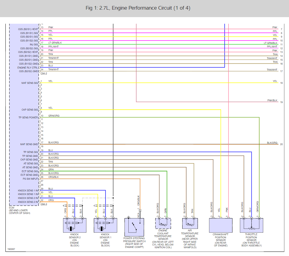

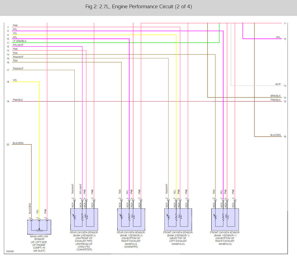

Here are the wiring diagrams and more below: Please let us know what happens. Cheers,

Okay i have opened the dash but right where there are 2 in your pic there is only 1 big gold one in my car would this be it?
Aug 5, 2019 at 5:56 PM (Merged)
It sounds like they have integrated the two relays. Go ahead and replace that one and you should be good.

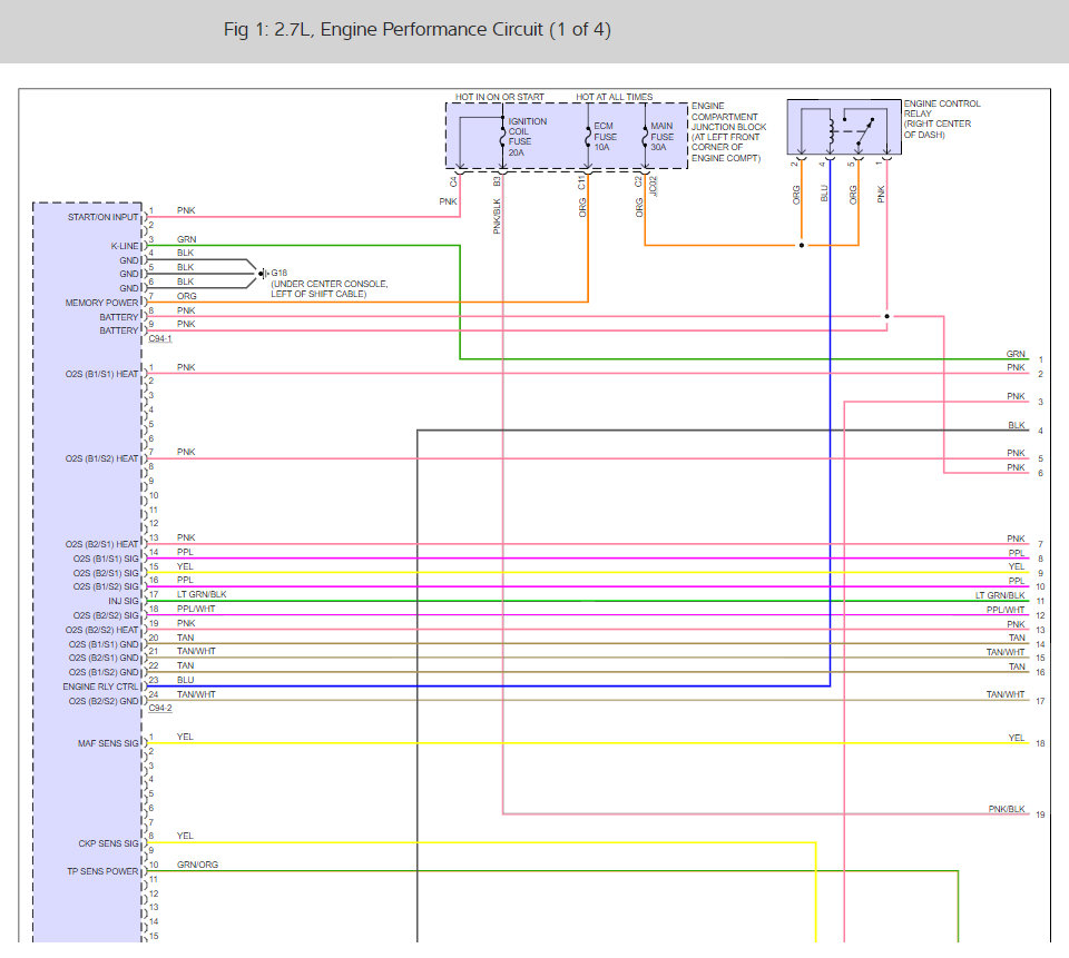

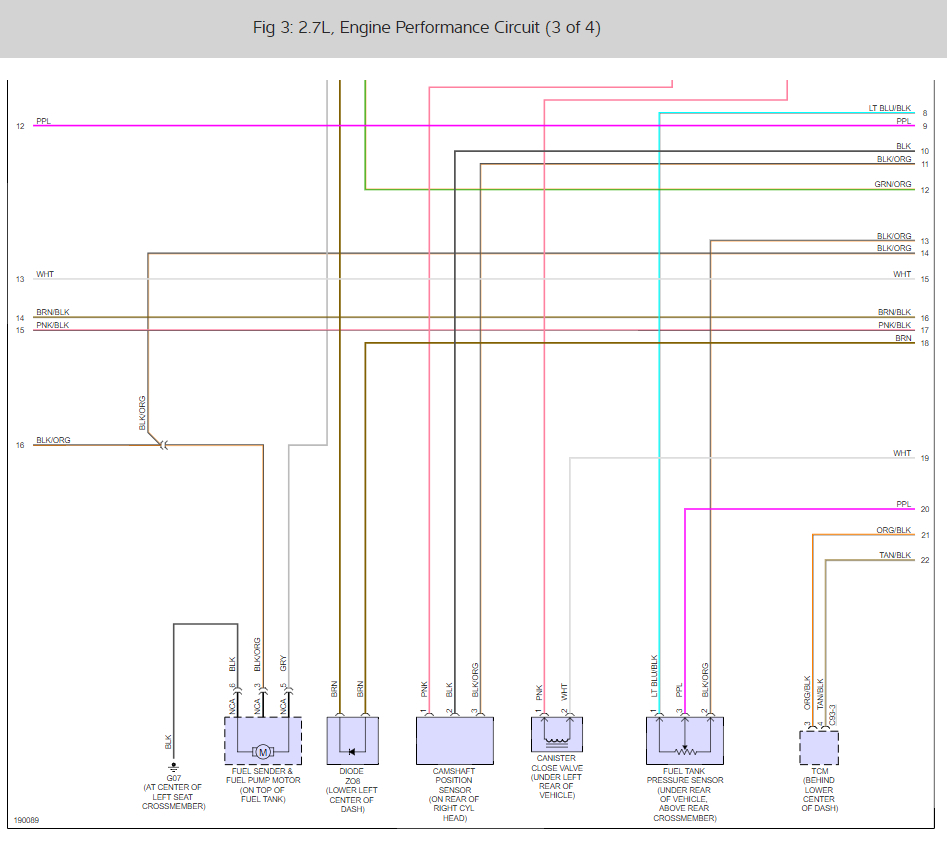

your vehicle's fuel pump relay is located in the center of the dash, on bracket under radio, under the engine control relay here is a diagram (below)
This guide will help you test it
Cheers

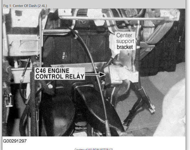

Check and test the coil fuse and the engine control relay

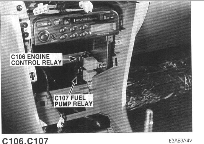

Sorry for all the confusion.
As I stated in the beginning, it is under the radio. If it is not, then post the entire VIN for me on the car.
I attached a picture for you to view. It is a single relay.
