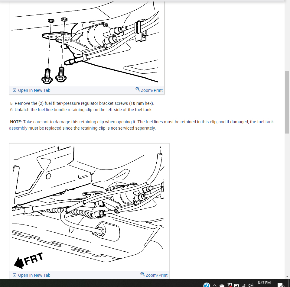

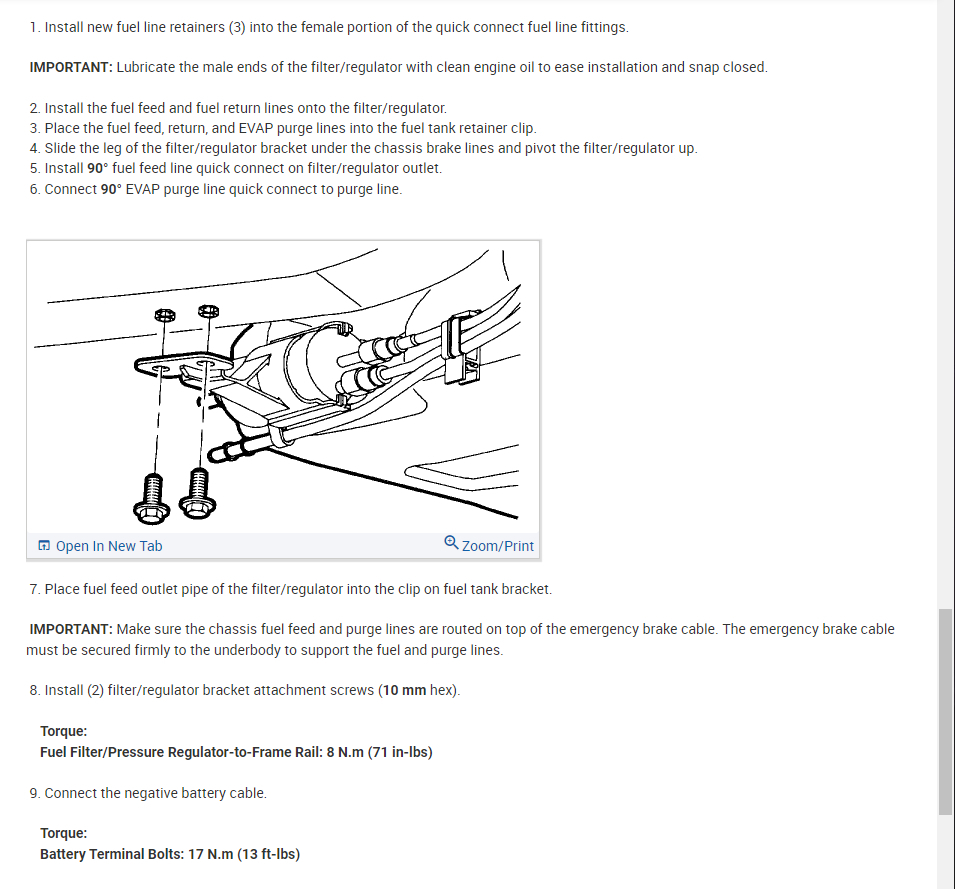

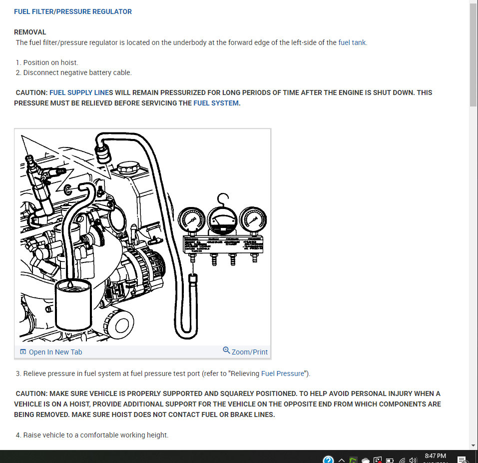

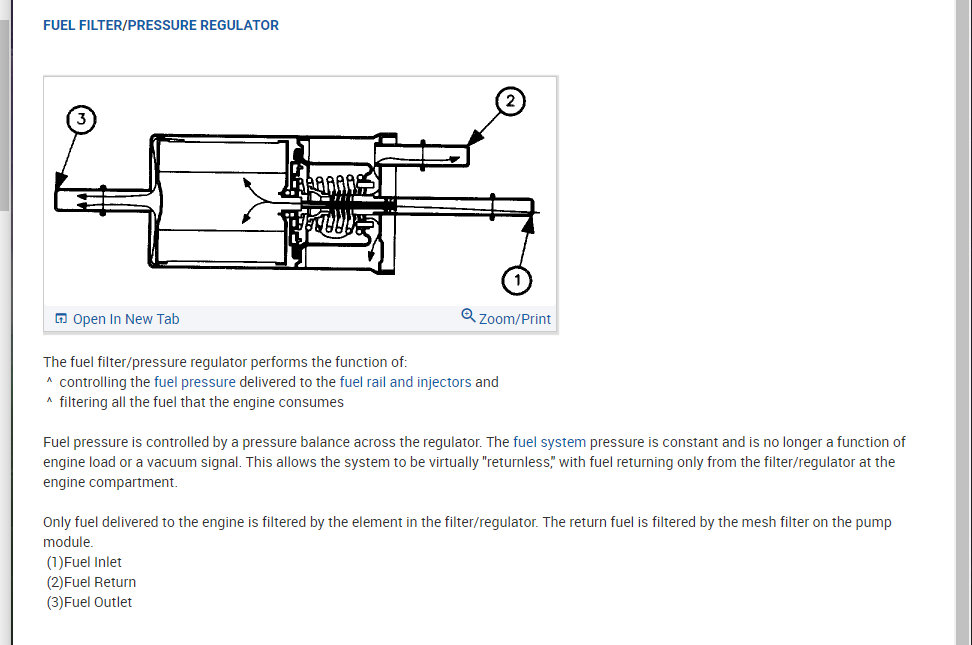

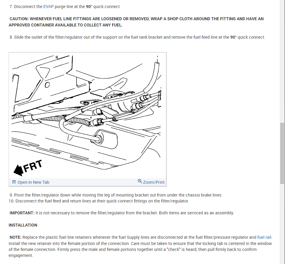

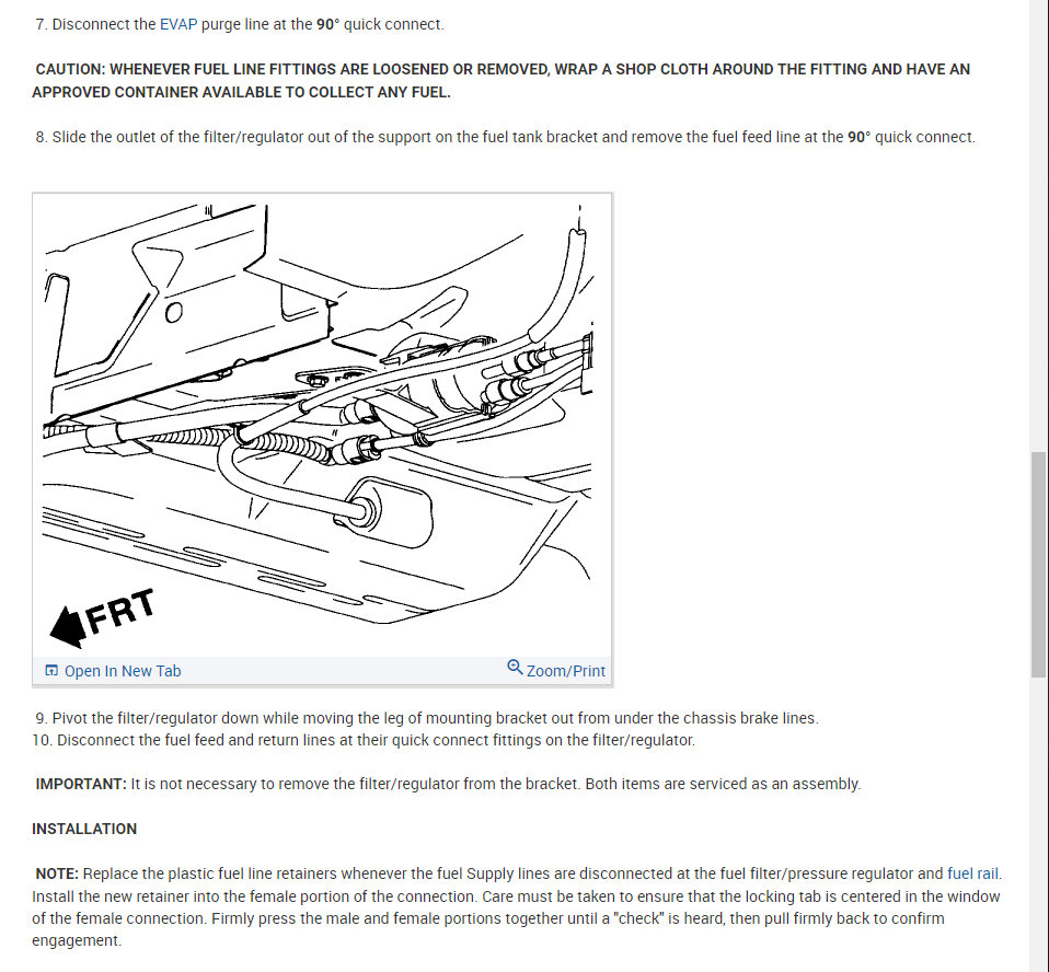

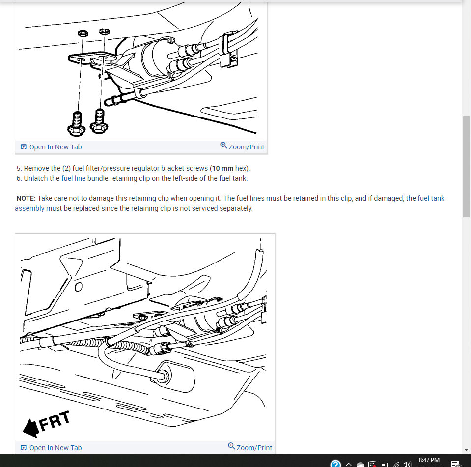

My Saturn sl2 02 has 289k so I have replaced parts honestly at random trying to get the rough idle to stop. I had a problem with when I was cold I couldnt turn the crank to start it up or it woulsnt turn over. I had to turn the key leave it for a second shit it off then attempt to start it, it would fire right up. So I got a fuel pressure regulator to replace mine. But never got around to it and now I'm find it harder to locate than I thought. Probably right in my face but a tip would help
