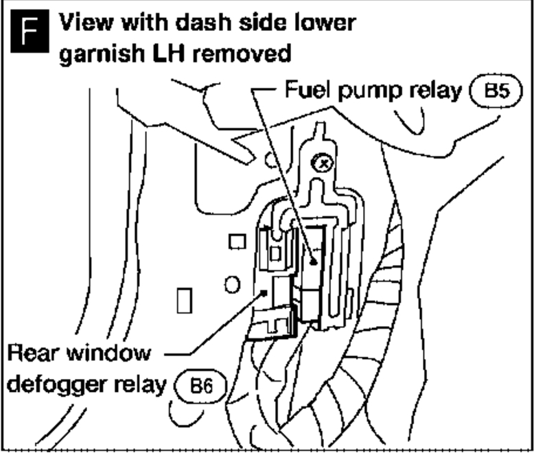

Fuel pump wont turn on. The car turns over, but wont fire. I cannot find fuel relay location.
Jul 2, 2016 at 6:19 AM
KHLOW2008
  • 41,814 POSTS
The fuel pump relay is located behind the left kick panel.
