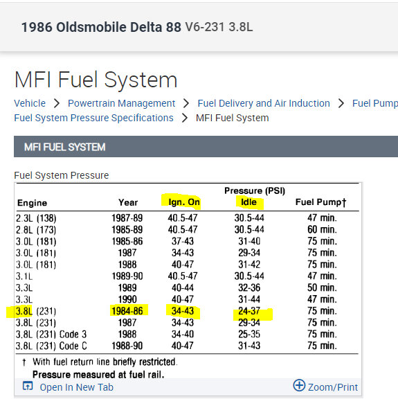

The fuel pressure specifications you provided are within the manufacturer's pressure specifications.

See pic below for fuel pressure specifications.
