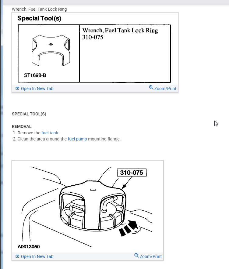

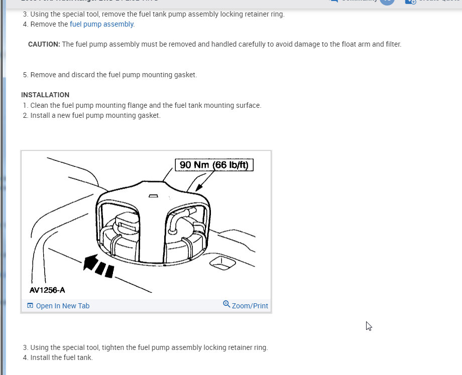

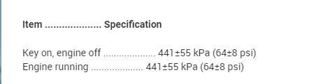

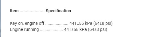

I attached the process. Let us know what questions you have. Thanks

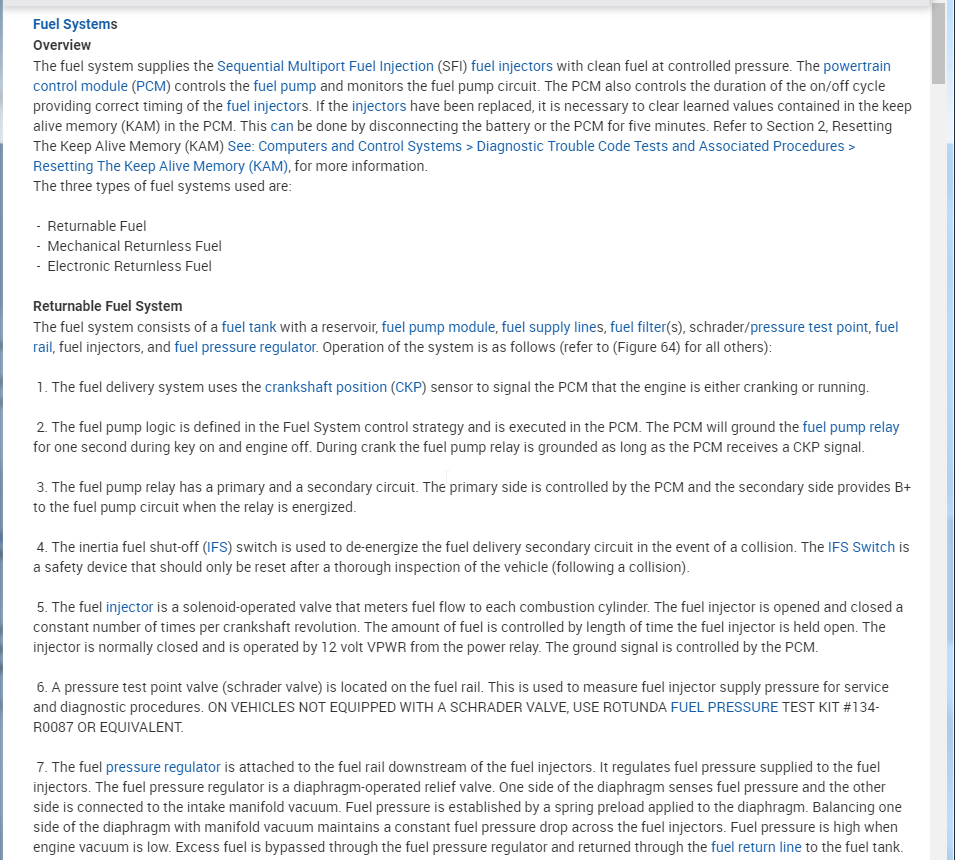

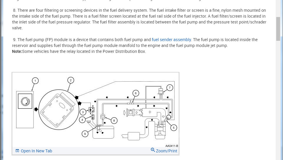

Yep. Sounds like a pump issue. You are basically correct. There are a few more items involved so I included the overview of the system.
