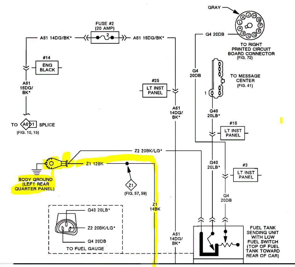

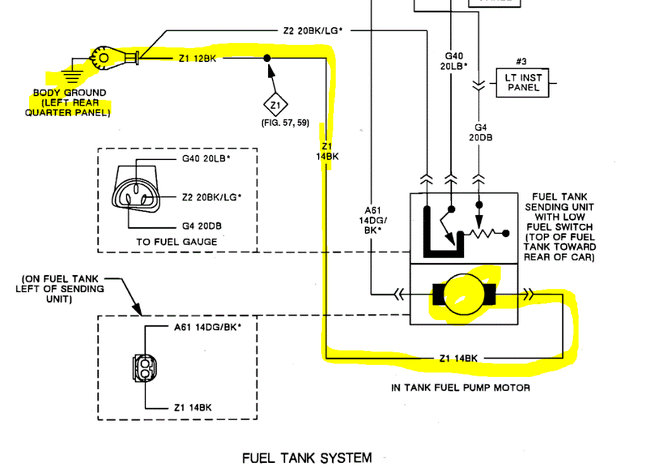

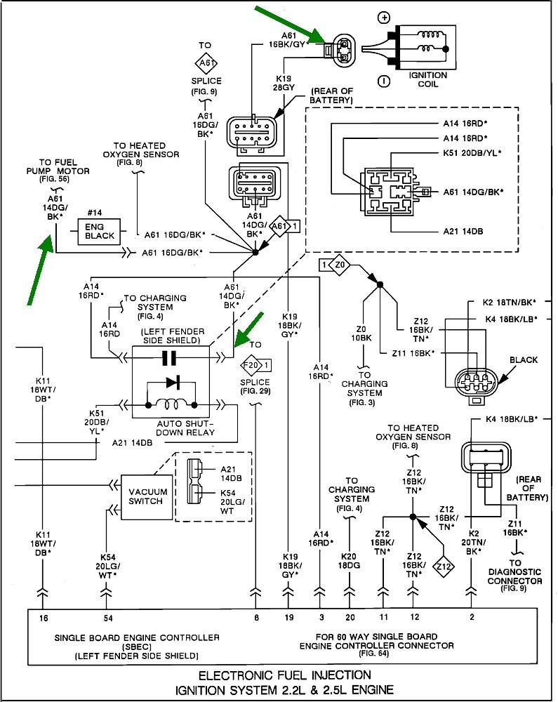

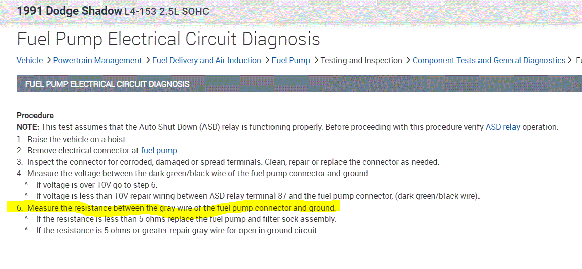

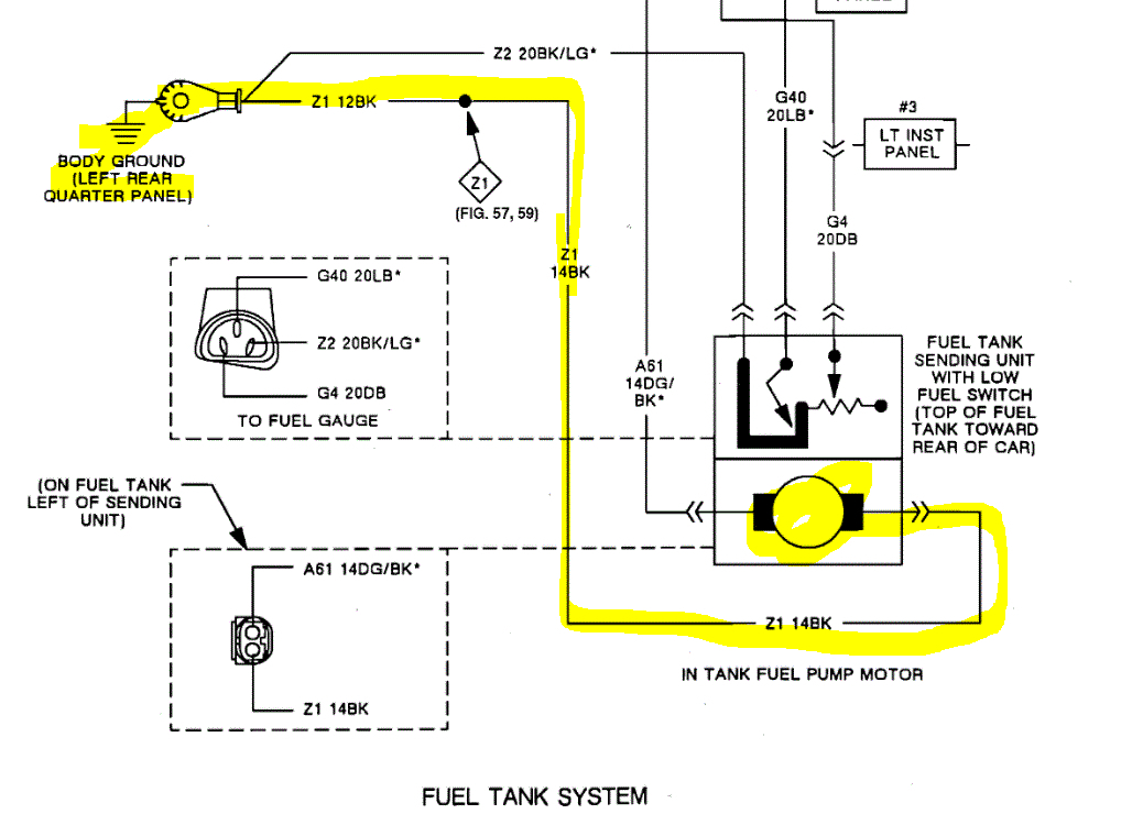

Hi Jackie, you indicate good voltage to the pump. If that is the case, either the pump is bad, or you have no ground to complete the circuit.
Do me a favor. Take a look at pic 1 below. It explains what to check if the pump isn't running. Also, pics 2 and 3 are the wiring schematic. I was only able to find the OEM schematics, so they are not as informative. However, using the tests in pic 1 and schematics should provide the cause of the problem.
Let me know what you find or what I can do to help.

This diagram shows the ASD relay and some of the circuits it feeds, (green arrows). The easiest and fastest way to see if the ASD circuit is working properly is to go right to the ignition coil positive terminal, or either smaller terminal on the back of the alternator with a test light.
You can use a voltmeter too, but they usually don't respond fast enough. Have a helper run the ignition switch or prop the test light up so you can see it from inside the car. You will see it light up full brightness for one second when you turn on the ignition switch. That tells us the ASD relay and circuit are okay and the Engine Computer has control of it. Next, it must turn on full brightness and steady when you start cranking the engine. If it does, we have to focus on the fuel pump or the ignition system, but not both. If it does not light up during cranking, you won't have fuel pump, spark, or injector pulses, that's when we have to look at the Hall Effect pickup assembly.

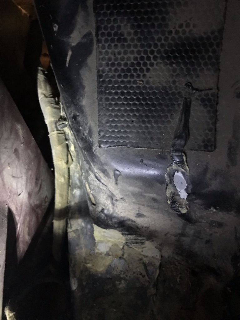

JACKIE TODD
There's no ground on the left fender well side.

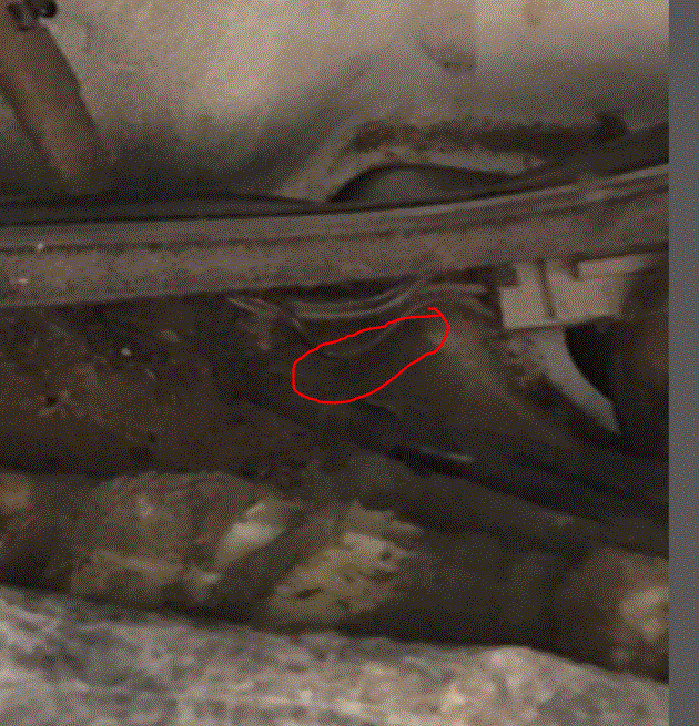

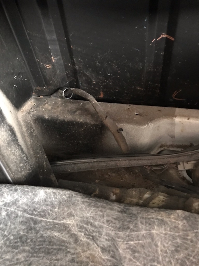

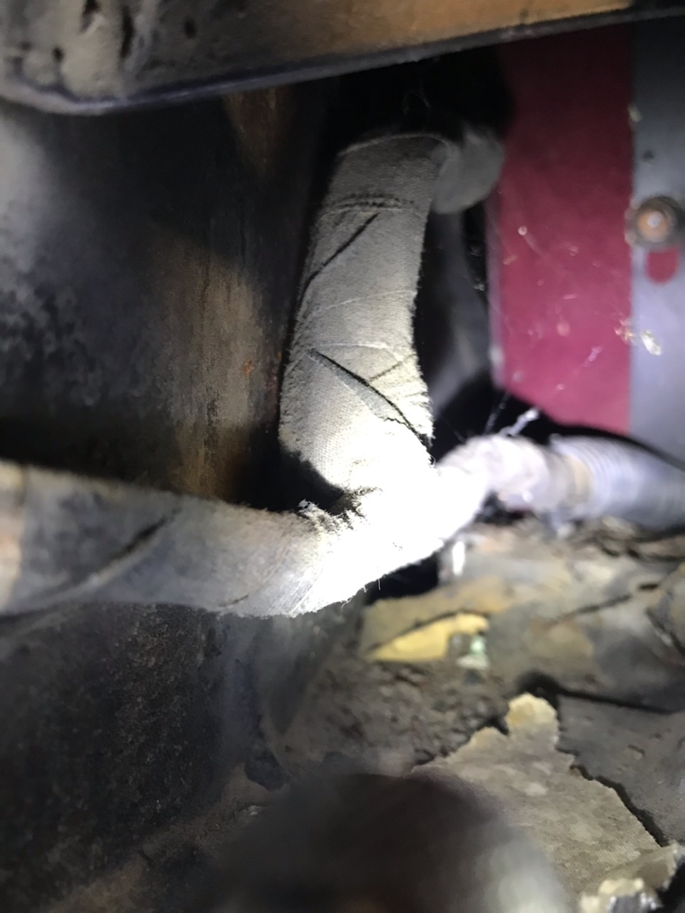

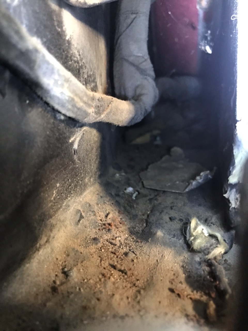

Jackie,
Are you looking in the trunk area in the pics above? I attached a pic of yours below and circled a black wire. If you follow it, where does it end?
See pic below.
