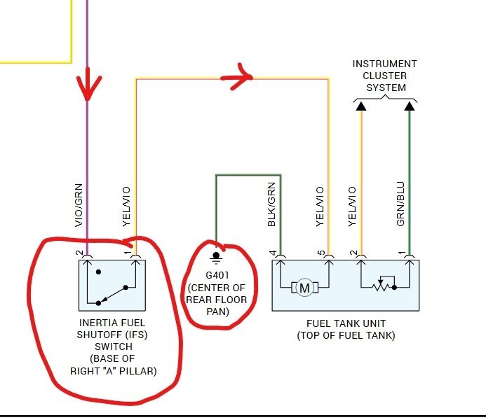

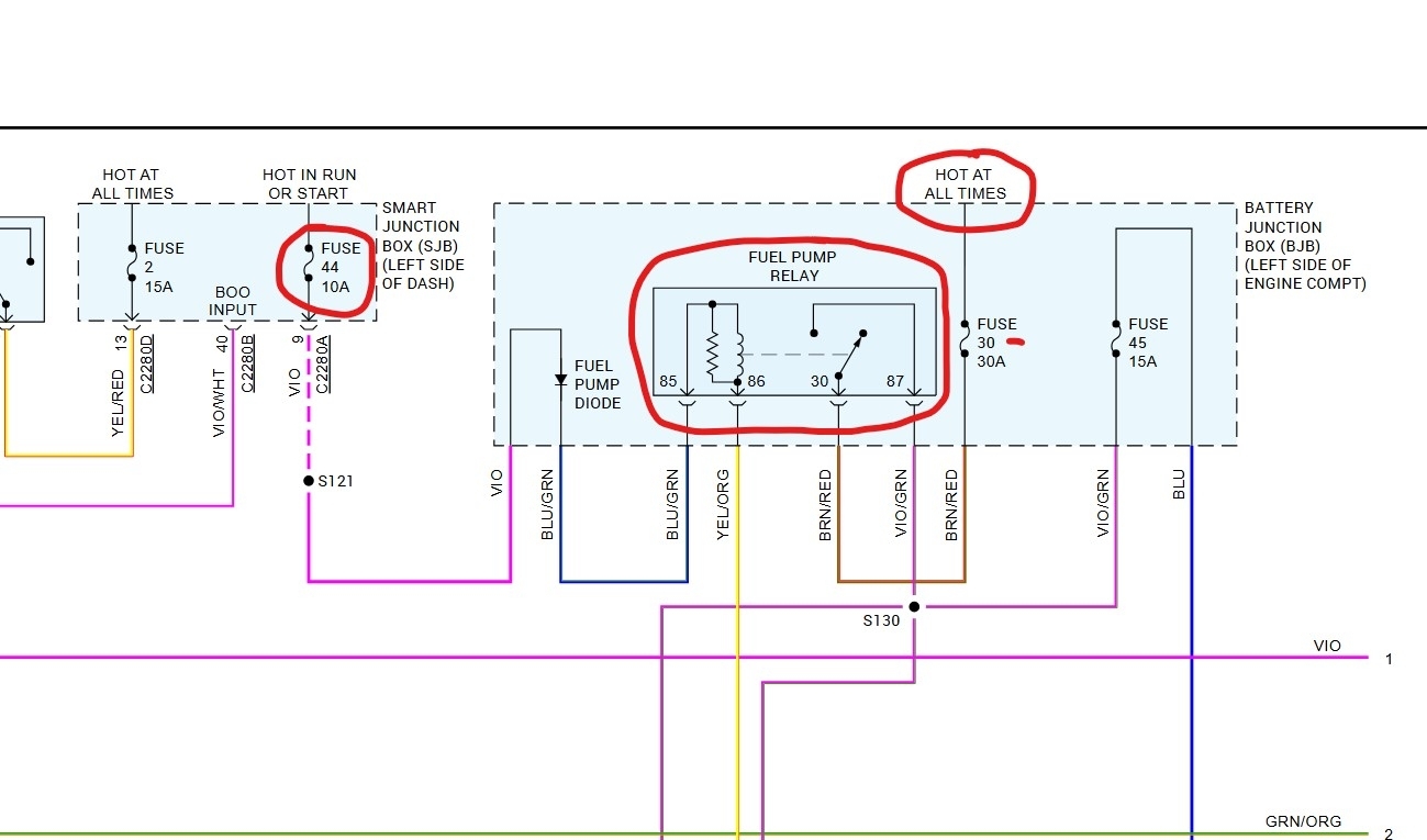

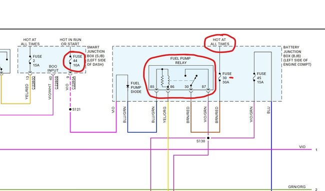

I cannot locate the fuel pump module. I have taken out the back seat, trunk liner, backseat side modeling, trim around doors, looked under the car, and removed a small heat shield. The car has intermittent starting issues and all leads to the module. Does anyone have a picture or any idea where they hiding it?
