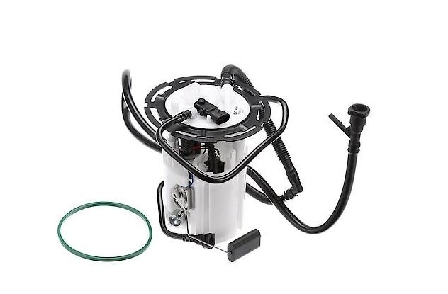

no, there is no access panel for the pump. I do not recommend cutting a hole as it will compromise the strength of the trunk floor.
Besides, the pump has lines attached that would require a huge hole be cut. I attached a picture for you of the pump and lines.

I do not have a diagram of the top of the tank to give you the exact location. what I suggest is to go under the car, look up where you can see it and I would start by punching a hole in the area. Then open the hole you made at the top and you will get an idea of where it is located and then you can adjust your hole accordingly.

You really do not want to attempt cutting a hole. The other problem with doing that is the tank will be a couple inches below the floor and the pump does not lift straight out. It has to be laid down as it comes out so the float will clear and with the gap between the tank and the floor, that will not be possible. You will destroy your floor and still not get the pump out.
