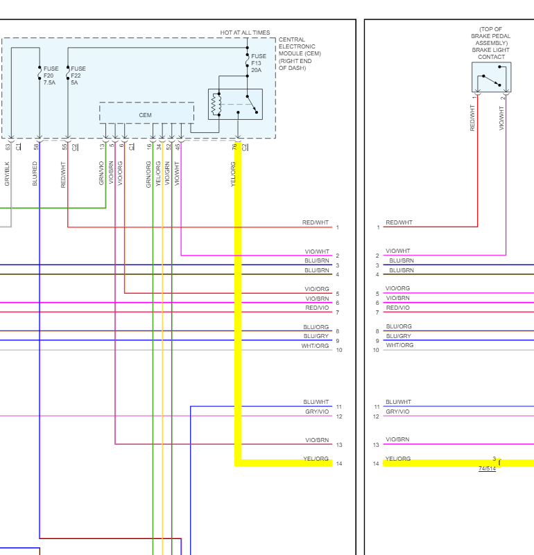

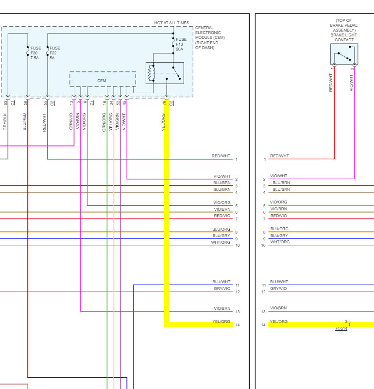

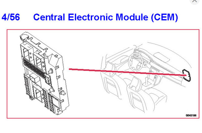

This vehicle has a fuse for the fuel pump located in the Central Electronic Module, which is at the right end of the dash. It is fuse number 13, a 20A fuse. I have attached a diagram showing the location of the CEM.

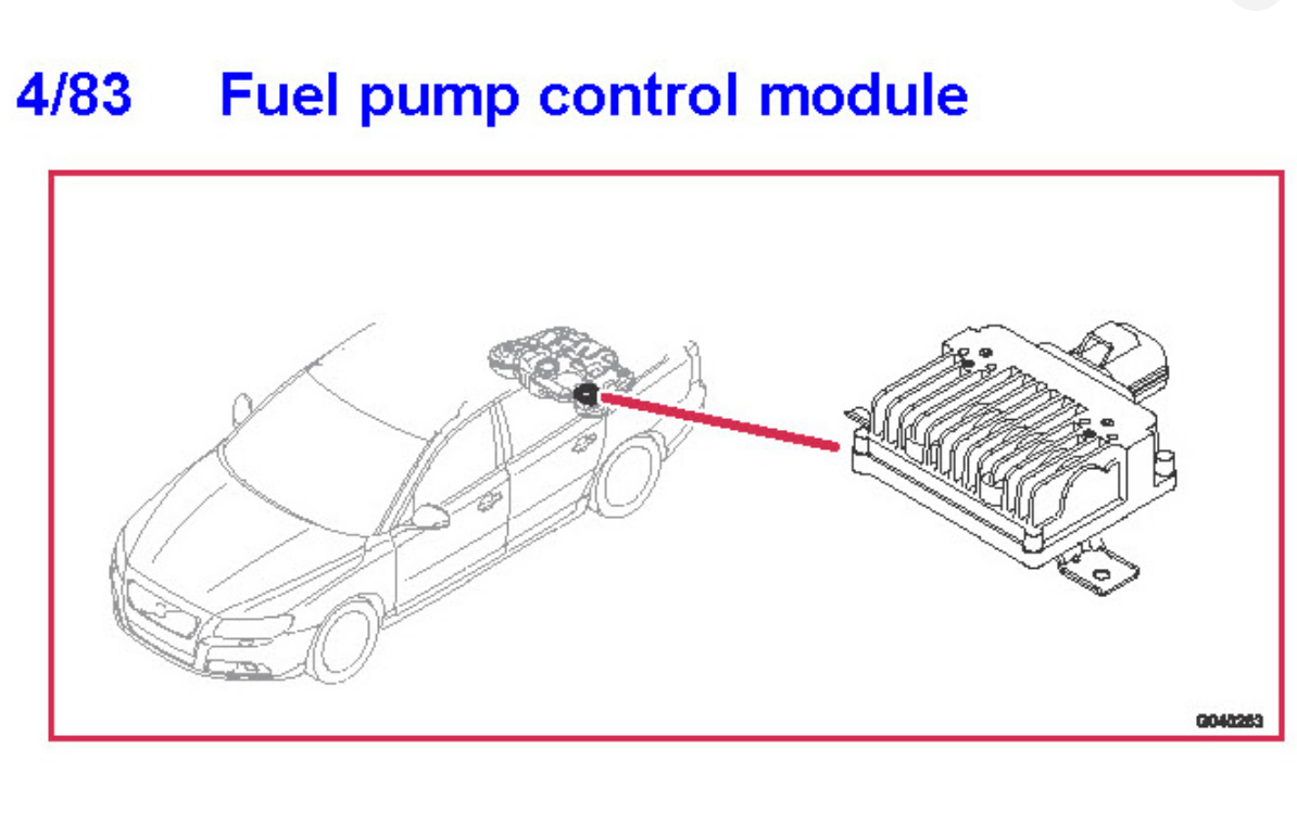

There is no relay, but a fuel pump control module located on the fuel tank.

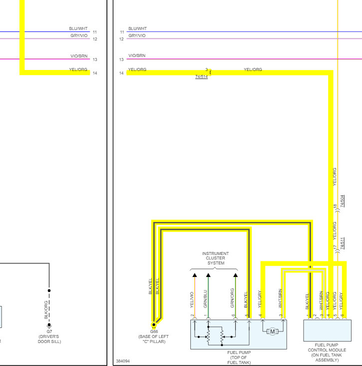

I have attached the wiring schematics for the fuel pump below.

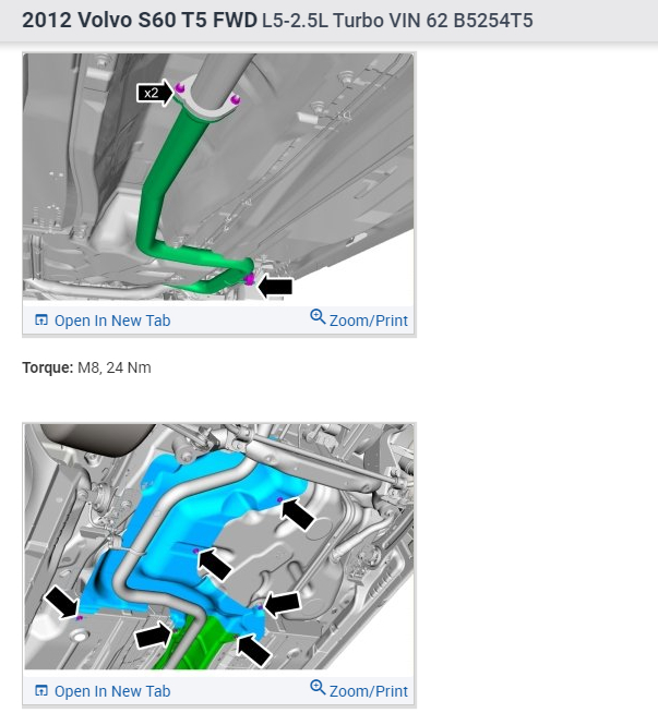

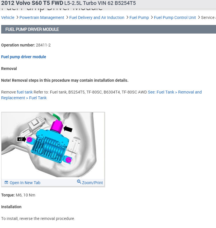

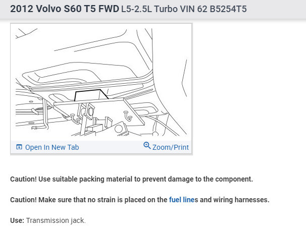

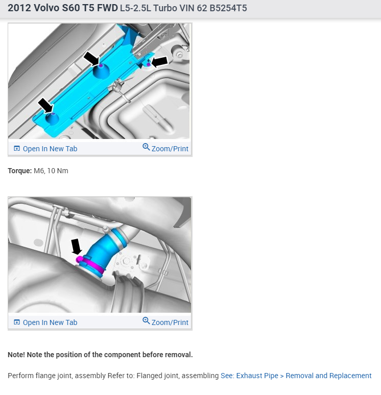

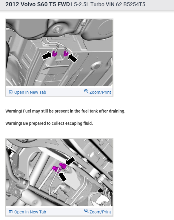

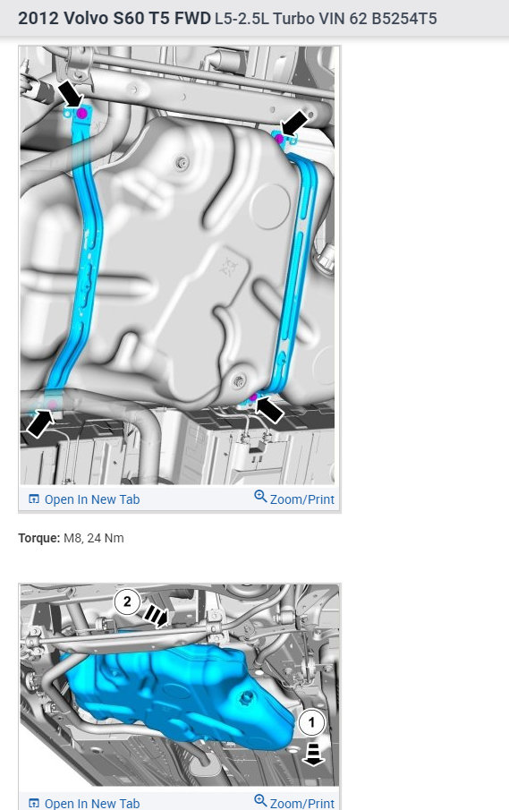

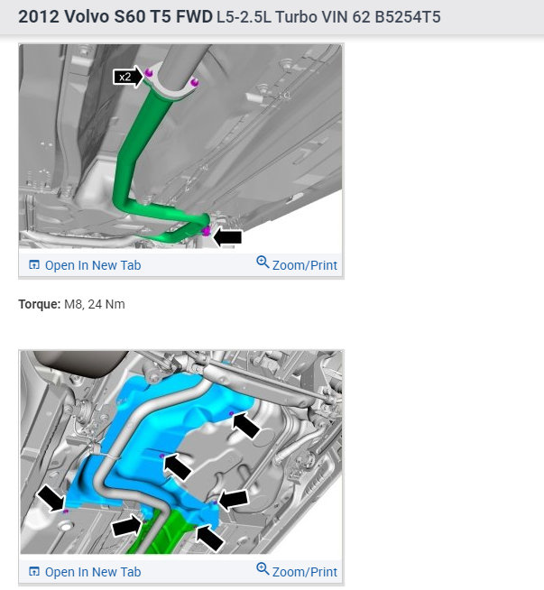

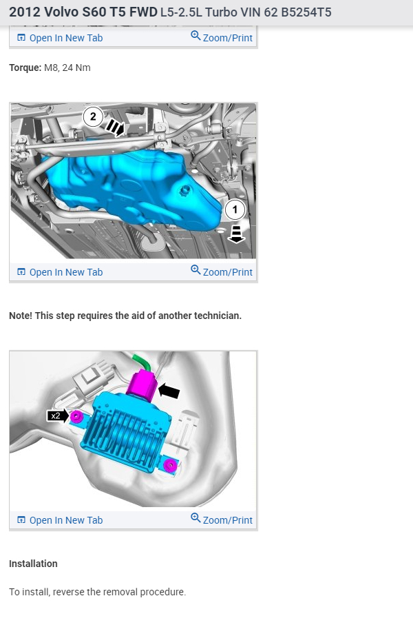

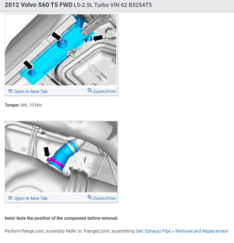

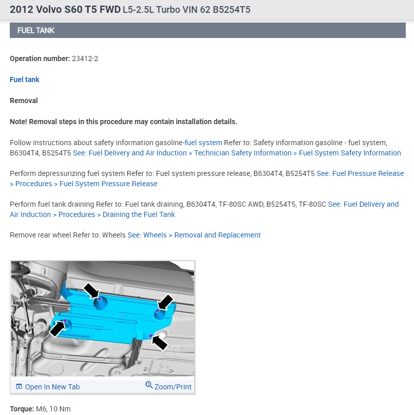

This module is actually mounted on the top of the fuel tank. In order to access the module the fuel tank will have to be removed.

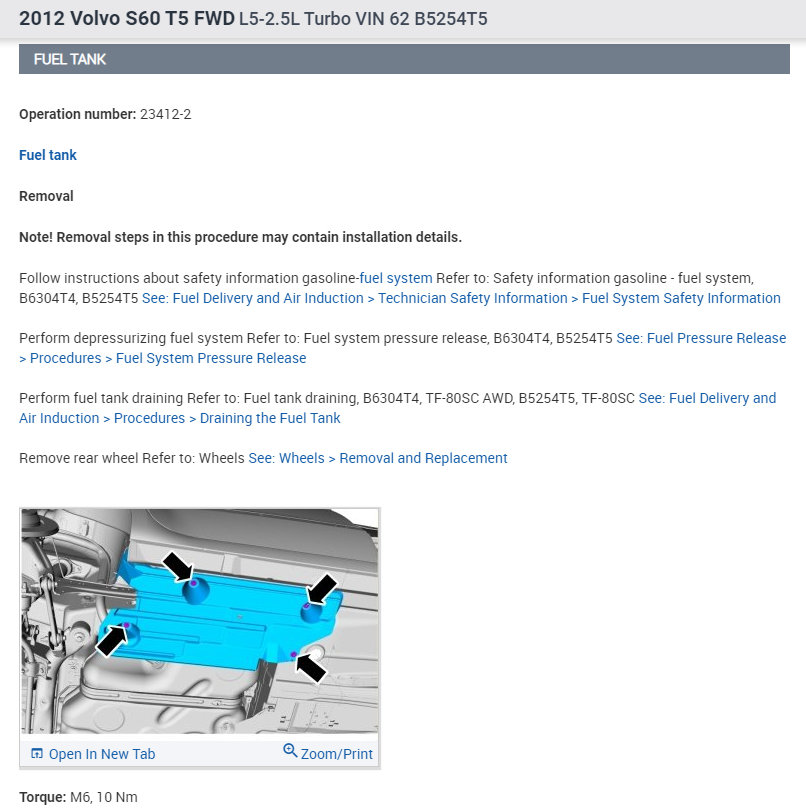

I have attached the procedure below for your reference.
