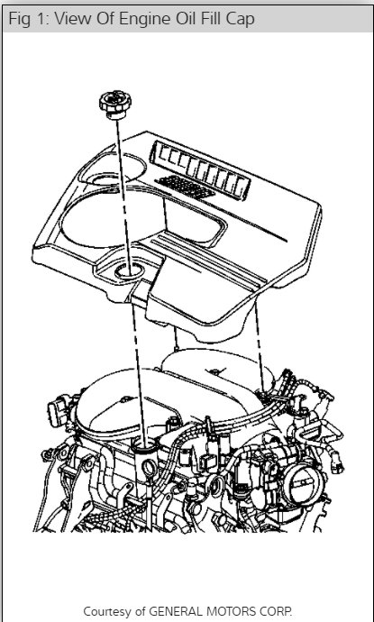

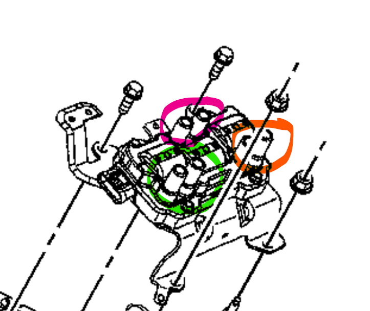

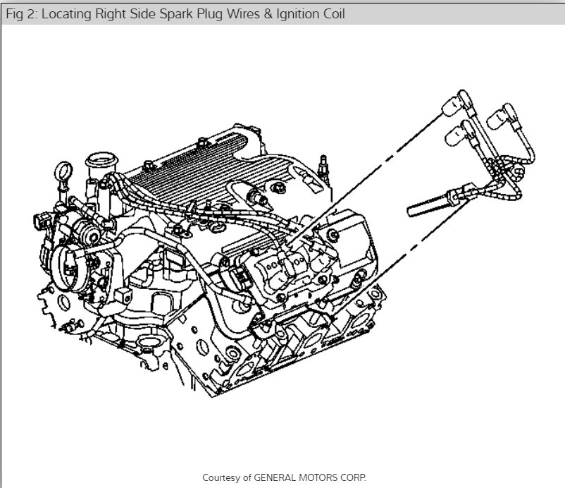

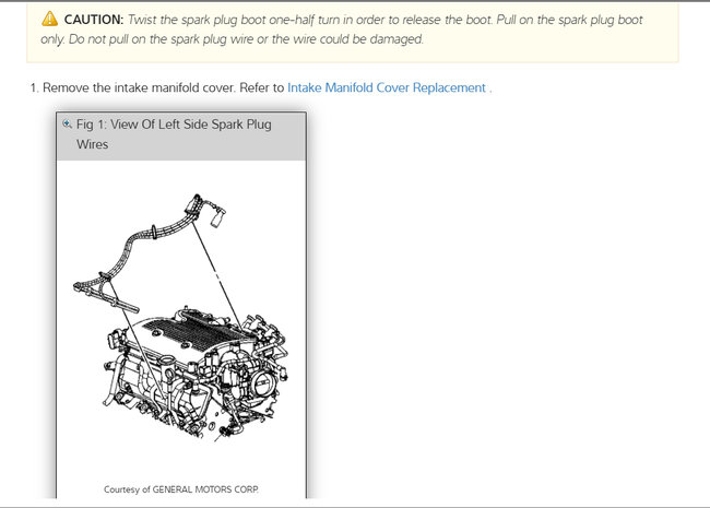

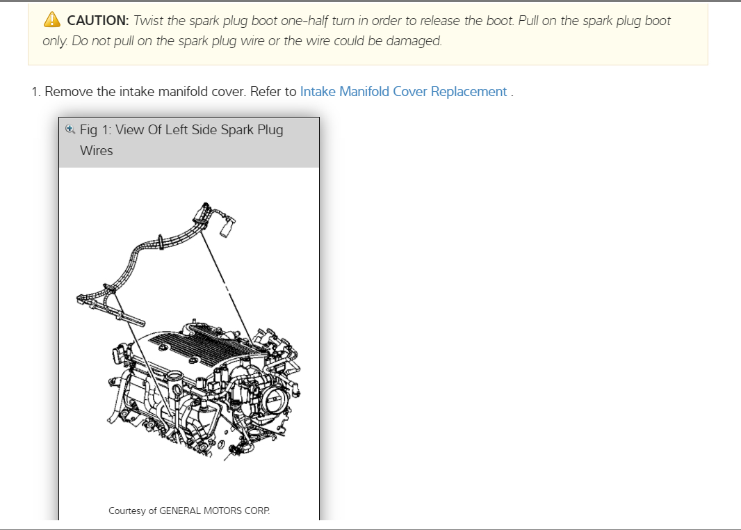

If that's the case you need to check for spark, the coil packs are on the back of the engine, on top of the valve cover. It's a waste spark system so 1 ignition coil fires 2 spark plugs. And because of this you can remove the 2 spark plug wires from one coil and crank the engine over. The spark should jump from one coil tower to the next with no problem. I will post diagrams showing how to remove the spark plug wires.
The 4th diagram is the Ignition Coil Pack. Each circle is one coil with 2 towers. Spark should jump between those 2 towers while cranking the engine. Just keep your hands away, you don't want to get a shock from one of these.
