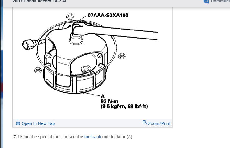

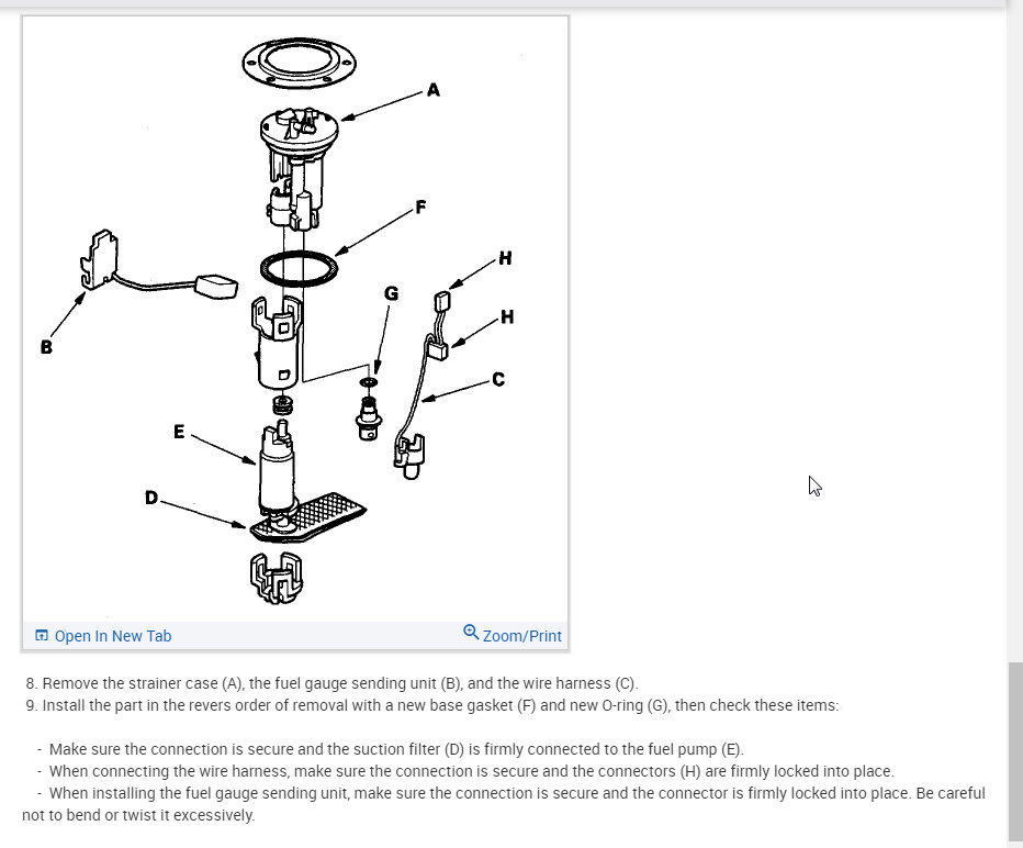

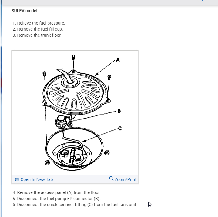

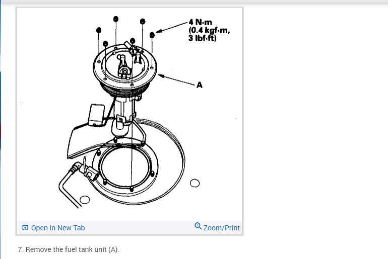

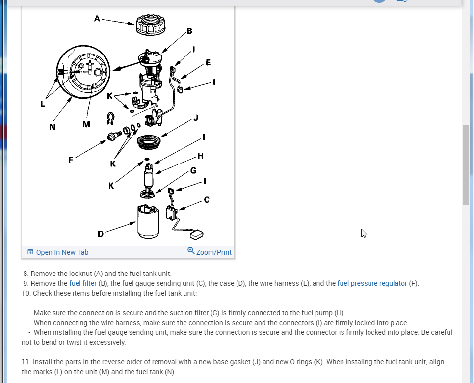

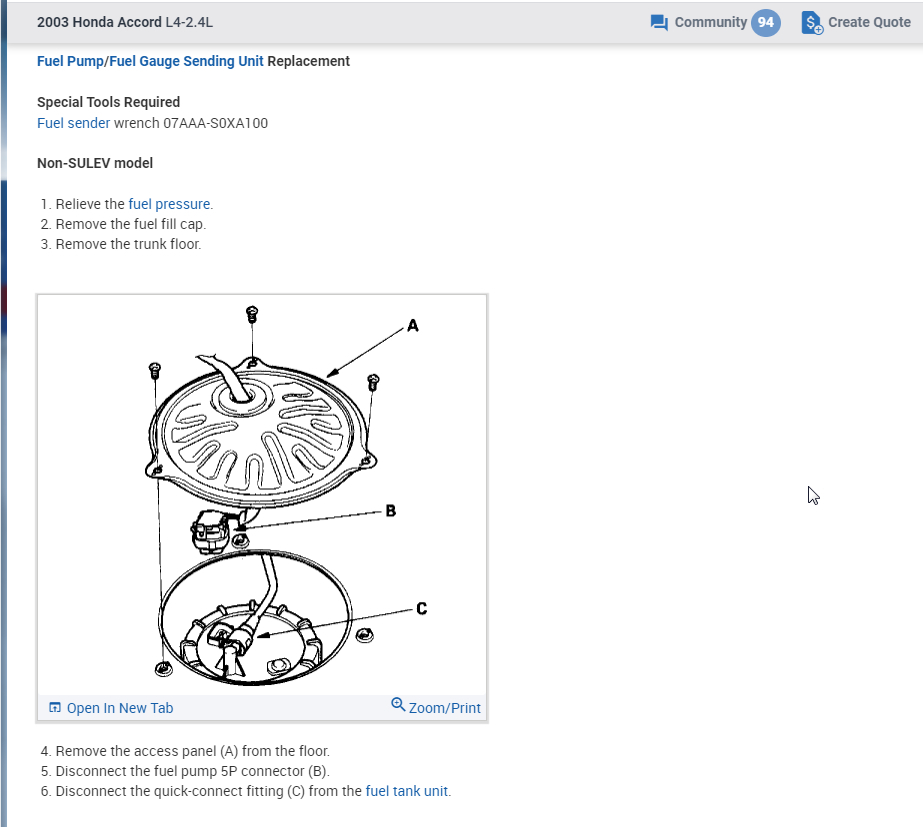

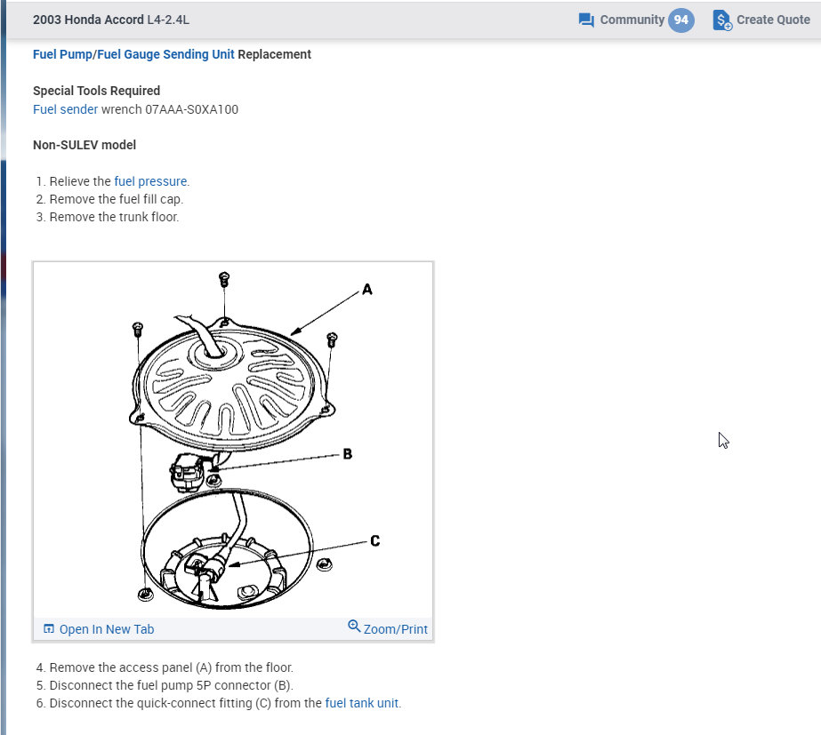

My car will sputter as it starts up. Sometimes I have to press the gas pedal as I crank it to get it to start. I've noticed it takes its time accelerating. I want to try to fix this by replacing the fuel pump and filter. Where is the fuel pump/filter located? Is it accessible through the trunk?
