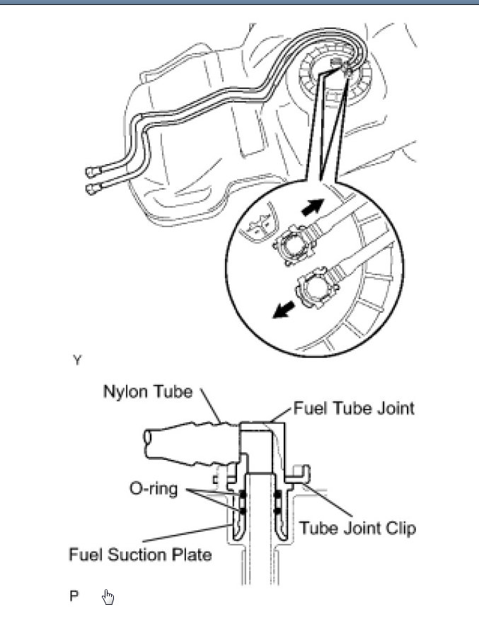

Where exactly is the fuel filter and fuel pump on the truck listed above? We came across a black box above the tank. is the fuel pump in the tank or the box? Because no wires go into the tank. Help!
Feb 17, 2020 at 5:58 PM

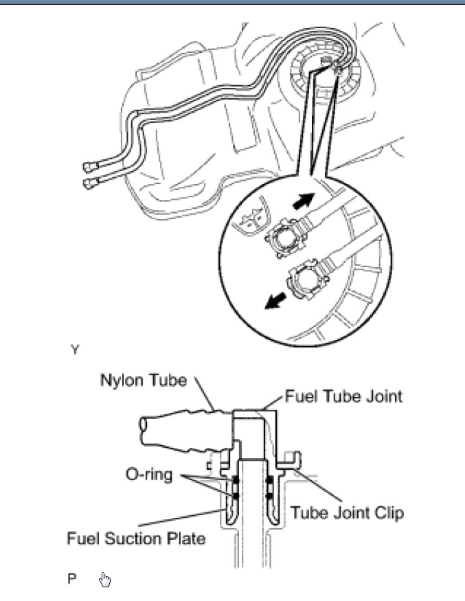

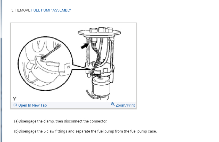

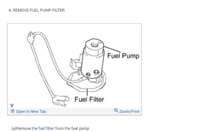

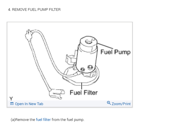

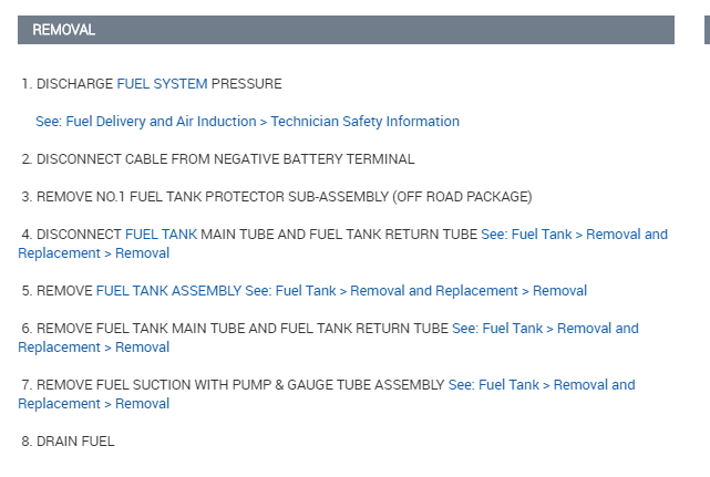

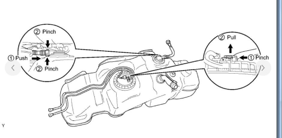

There should be a connector on the top of the pump which is in the tank. The filter is part of the pump inside the tank as well.
I attached a video that we have on an older Tacoma but it is a similar process. I also provided some information about your specific vehicle. Let me know if you need more detail and I can get that as well. Thanks
