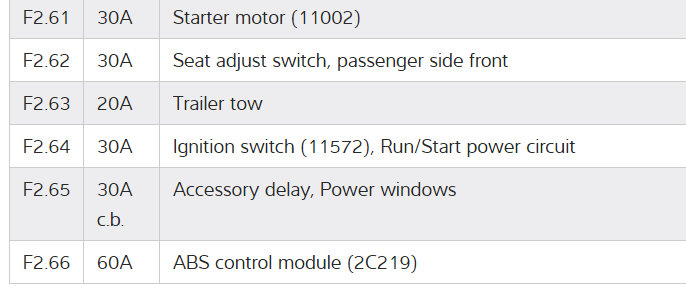

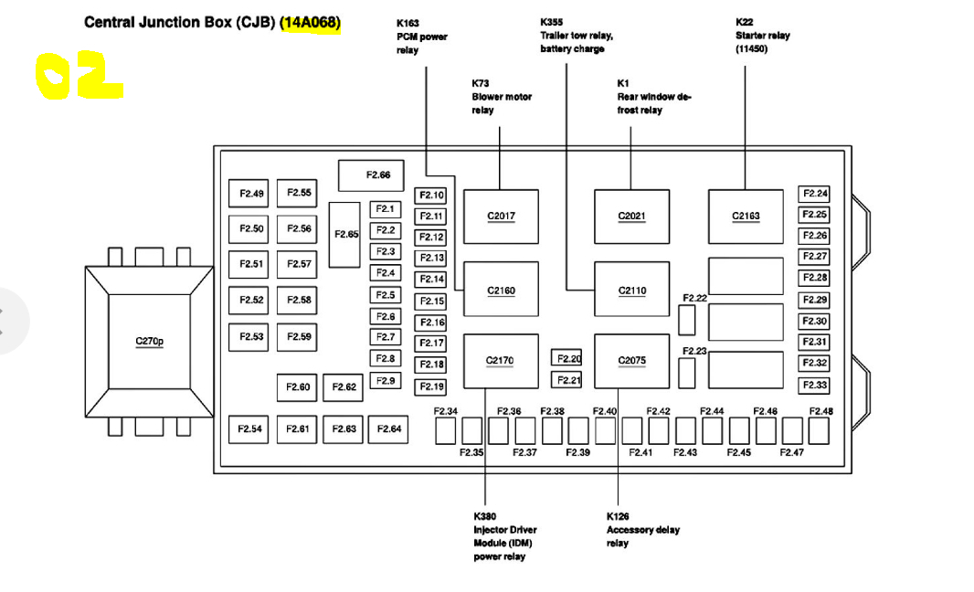

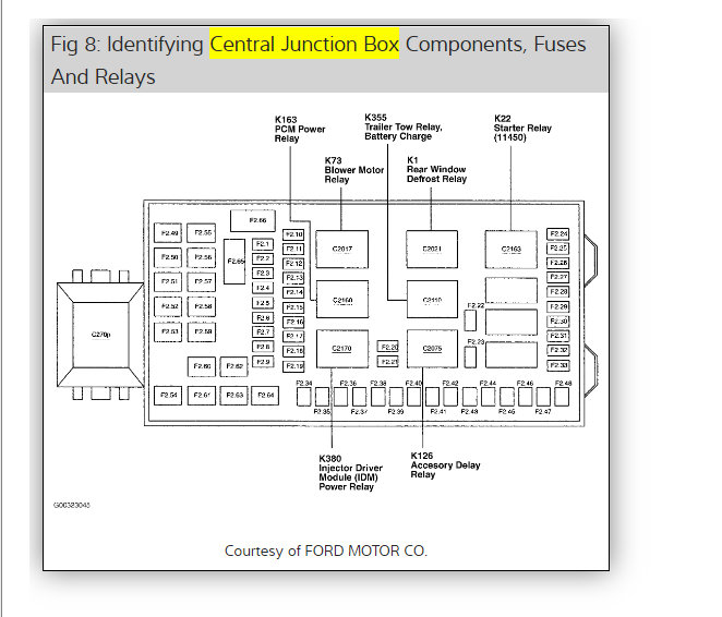

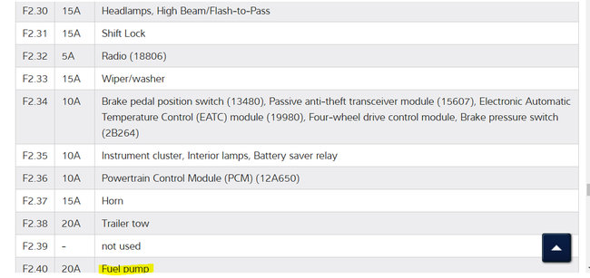

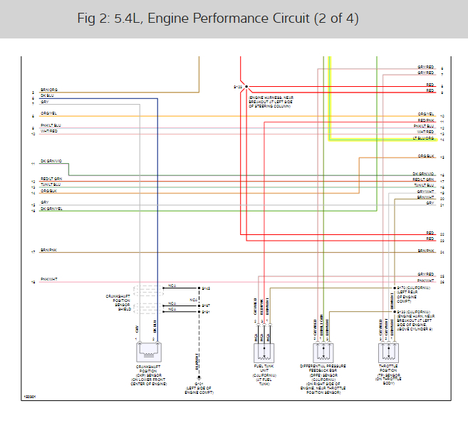

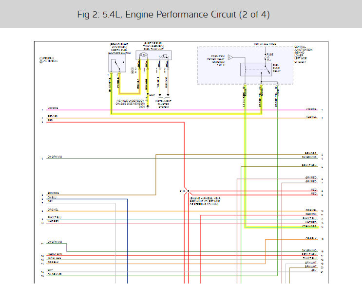

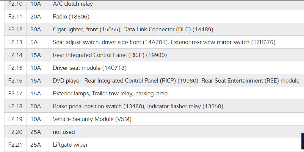

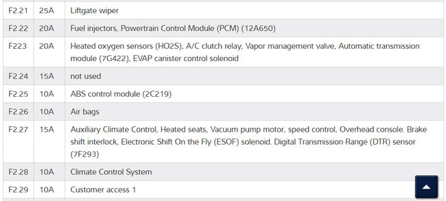

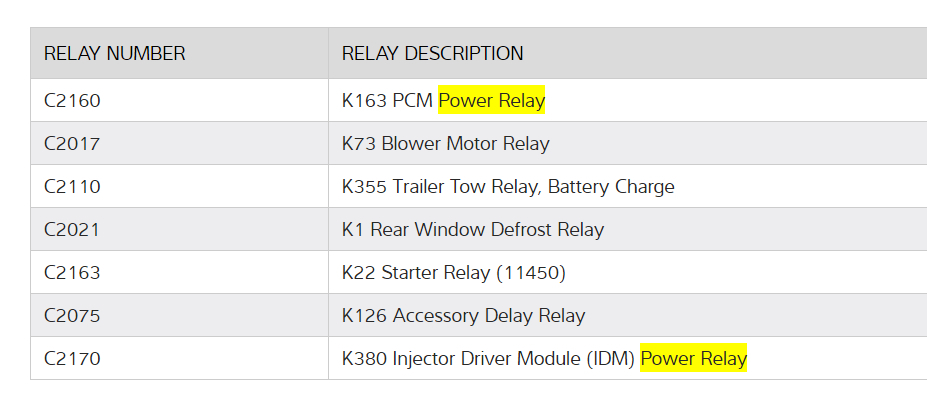

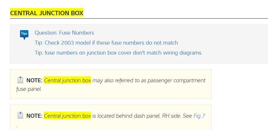

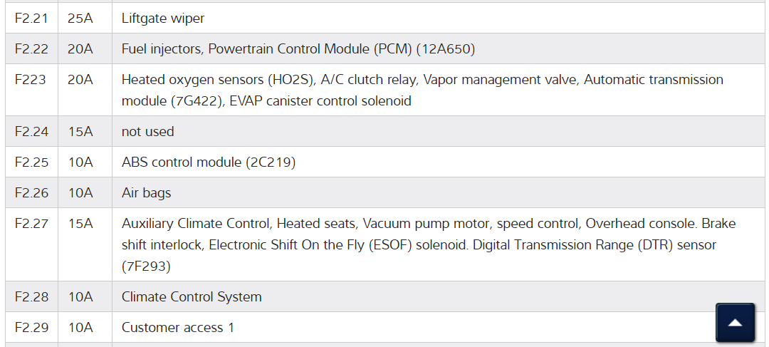

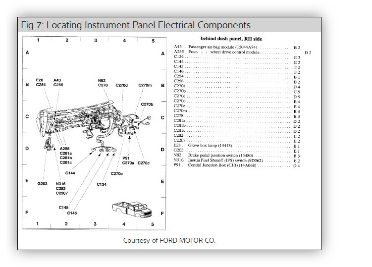

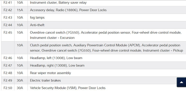

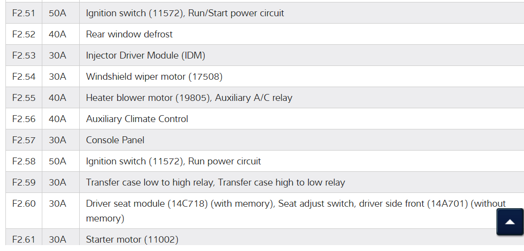

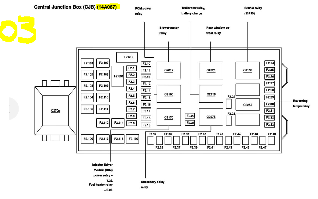

Fuel pump will not prime when the key is turned on . The fuel pump is not getting power. And cannot find fuel pump relay. This truck is supposedly the first year they change all kinds of things like I have no fuse box under my hood.
