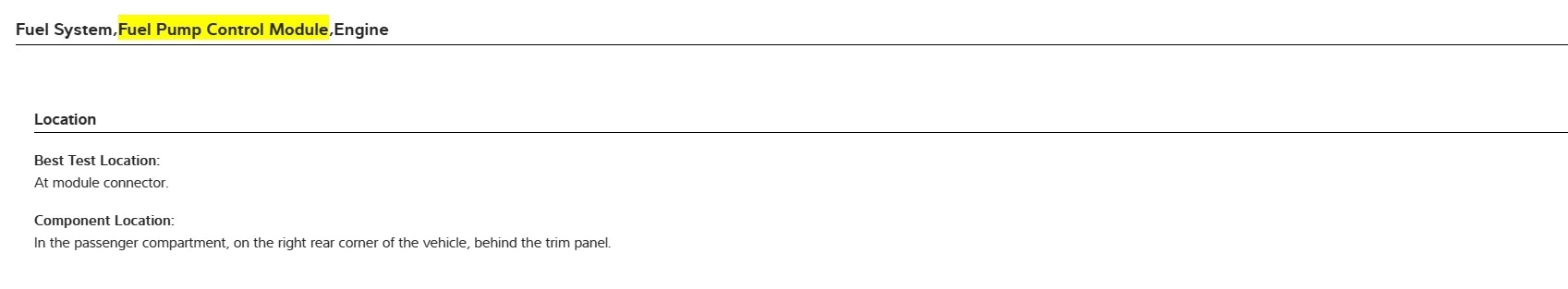

Good morning, RONICAG99,
I have attached a snippet from my repair information telling you the location of this module.
Let me know if I can help you any further.
Thank you,
Brendon
