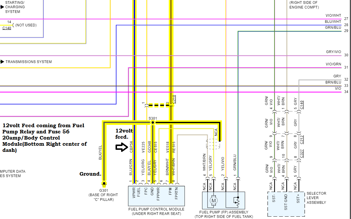

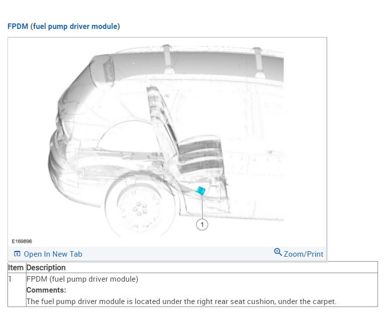

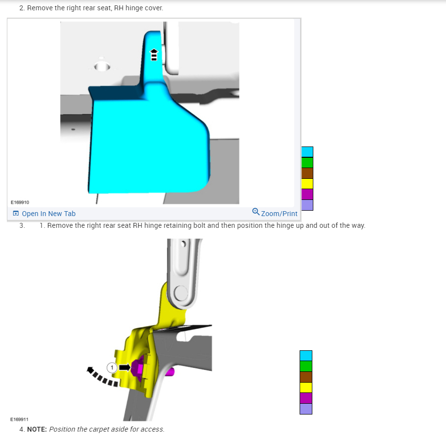

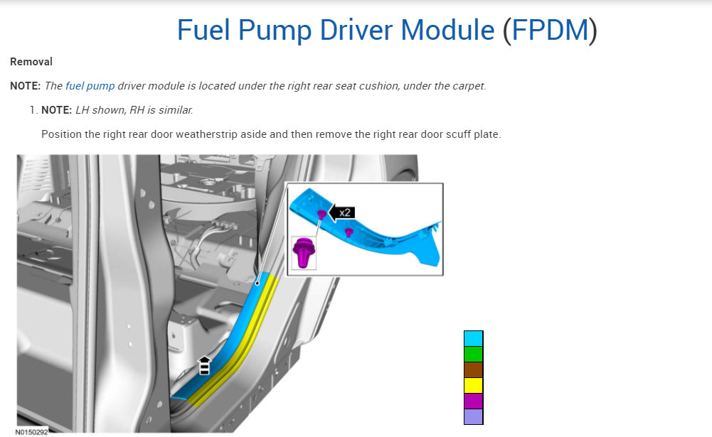

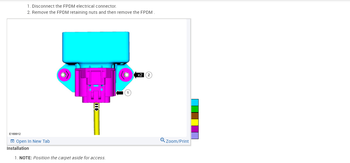

Hello, The Fuel Pump Driver Module is located under the passenger side rear seat. The diagrams show it from the Driver side, but it is the same removal process. I will include the wiring diagram in a couple minutes in case you want to test it for power and ground, which is recommended.

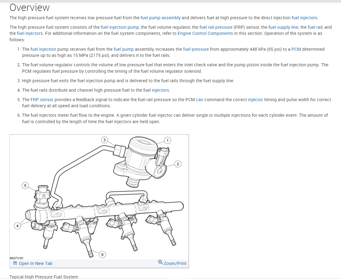

This vehicle has a low pressure and high-pressure fuel system, do not attempt to check the Fuel Pressure from the High-Pressure Fuel Pump. It is rated at 2175PSI and can cause serious injury. It is recommended to check Fuel system status using a scan tool and live data PIDS first to verify Actual and Requested Fuel pressure on the High-Pressure side.
