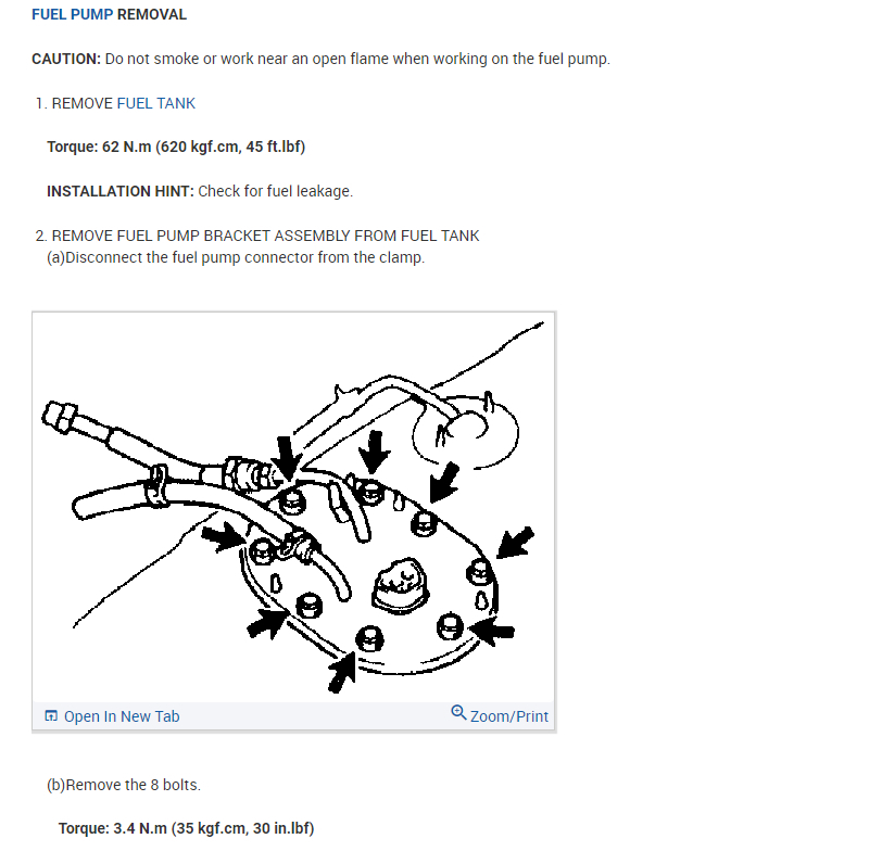

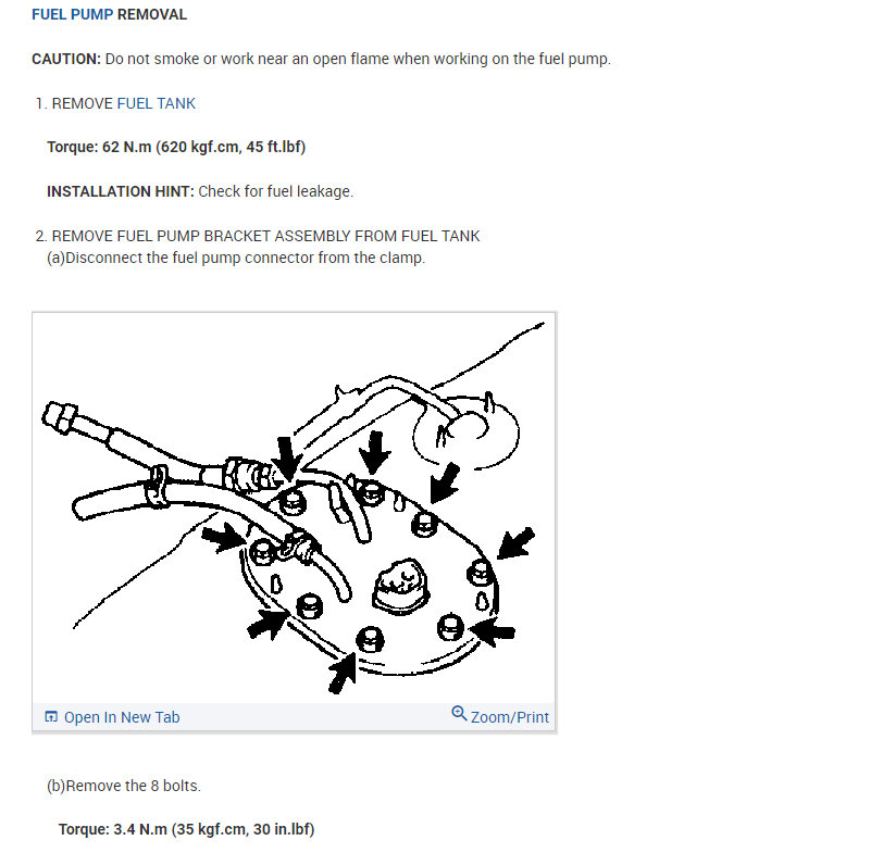

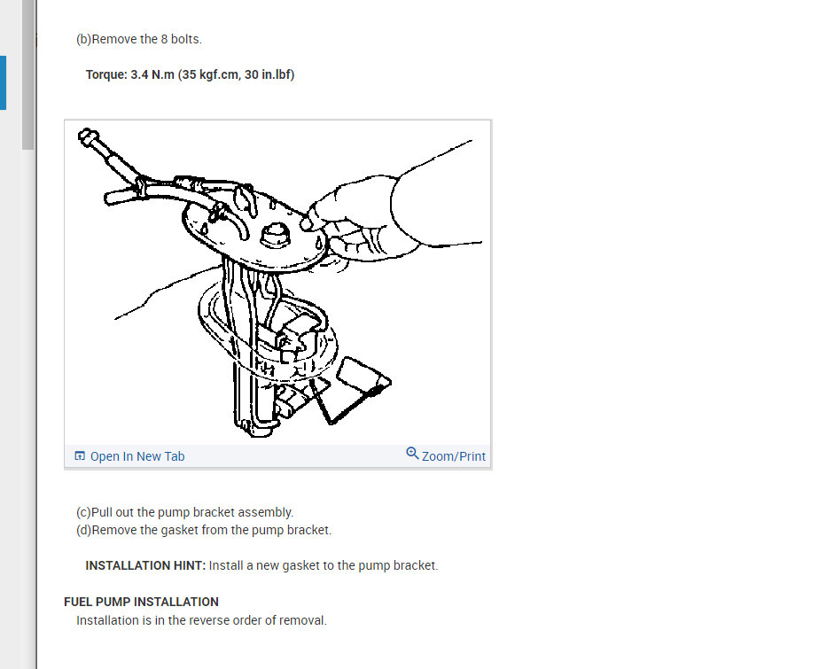

Also, incase you need it, here is some info on how to replace the fuel pump. Here is a guide that has some good info in it:
Also, please see the info below from the manual that will help as well.
Please let us know if you need more info. Thanks
