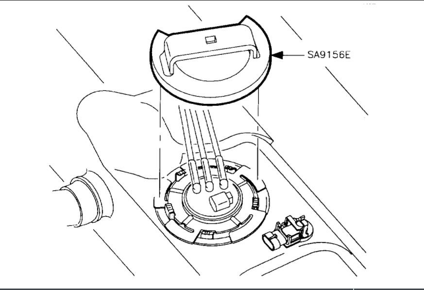

TOOLS REQUIRED
SA9156E Fuel Tank Lock Ring Remover

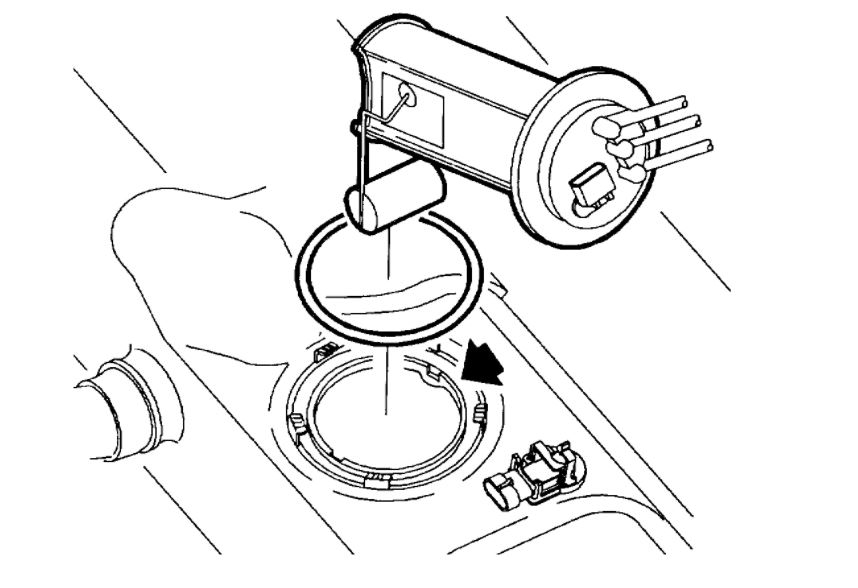

4. Use the Fuel Tank Lock Ring Remover SA9156E and remove the fuel pump module retaining ring. A 1/2 in. breaker bar (approximately 18 inches long) will easily loosen and remove the lock ring.
5. To prevent bending of the sending unit float arm during removal, lift the pump module up slightly to disengage the orientation tabs in the tank and rotate the module 90° clockwise until the fuel lines are facing the 1 o'clock position (12 o'clock is front of tank).
NOTE: Care must be taken not to bend or twist the fuel pump filter or sending unit float arm during removal or installation of fuel pump module assembly. A damaged fuel pump filter restricts fuel flow to the pump and a bent sending unit arm will not provide accurate readings. Care must be taken to assure pump module is not dropped. A dropped pump can dislodge internal parts creating a noisy and or leakage condition.
6. Carefully lift the fuel pump module (with sending unit) straight up from the fuel tank until the bottom of the pump module is very close to the fuel tank opening. Then tilt the pump module about 45° toward the right side of the tank and simultaneously lift it up and out of the tank opening watching that the level sender float arm is not being bent.
IMPORTANT: Always replace the fuel pump module to tank seal (O-ring) whenever the assembly is removed. The correct seal is green in color. Do not use the older black seal.
7. Discard the fuel pump module to tank seal.
