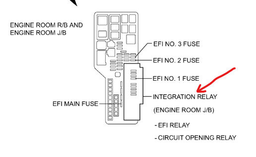

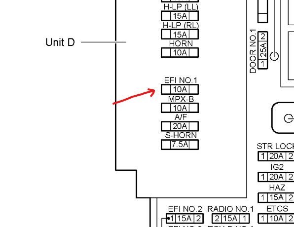

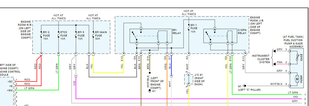

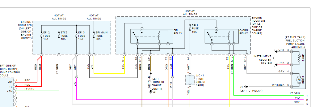

Sure, it can be the pump is burned out or the C/opn relay is not working or the MAIN EFI fuse is blown which is in the fuse panel on the left side of the engine compartment. The fuel pump can have a bad ground as well which is at the left C pillar. Here is the wiring diagrams for the system so you can see how it works. Check out the images (below). Let us know what you find.
