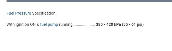

You need to check the actual pressure. You can rent a tester at a parts store and the fitting is right by the distributor.
