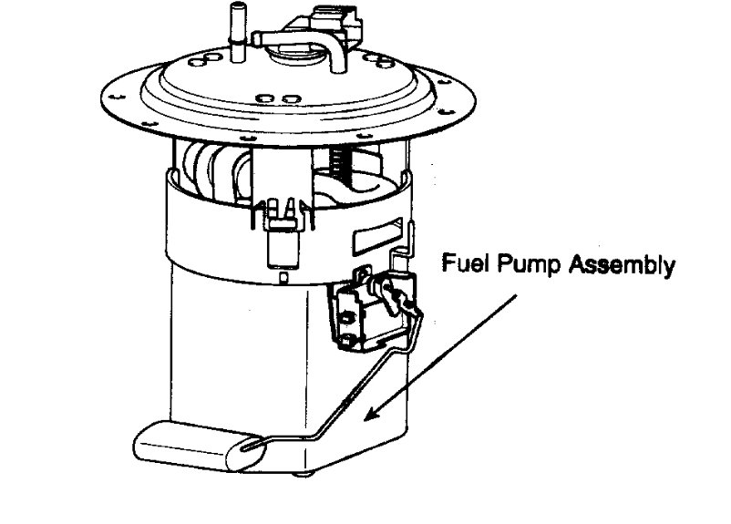

Hi, i changed my electric fuel pump tonight and i want to know what is this red piece at the end of fuel pump cover and what's doing? Does it have a part number? Mine is out of shape and i am worry about this little plastic thing. Thanks

Good evening,
Does this piece cover a hole at the bottom of the unit?
What is on the other side?
I do not see it listed anywhere separately.
Did you replace just the motor or the entire unit?

Yes, it covers a hole. Nothing on the other side it's the end of fuel pump cover. I replaced just motor. i think it hold fuel in the cover.
Dec 28, 2018 at 4:59 PM
Yep, I agree. The part is not available on its own.
