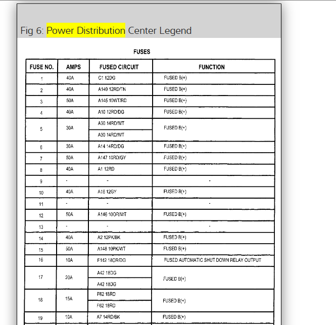

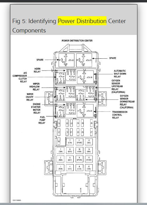

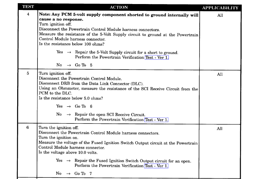

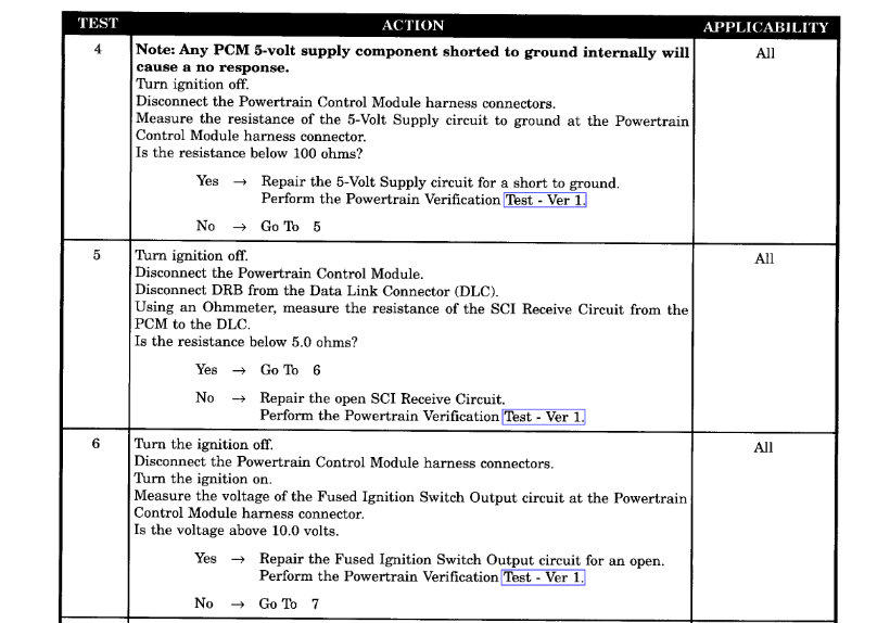

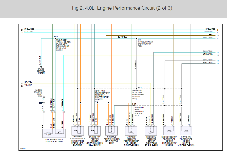

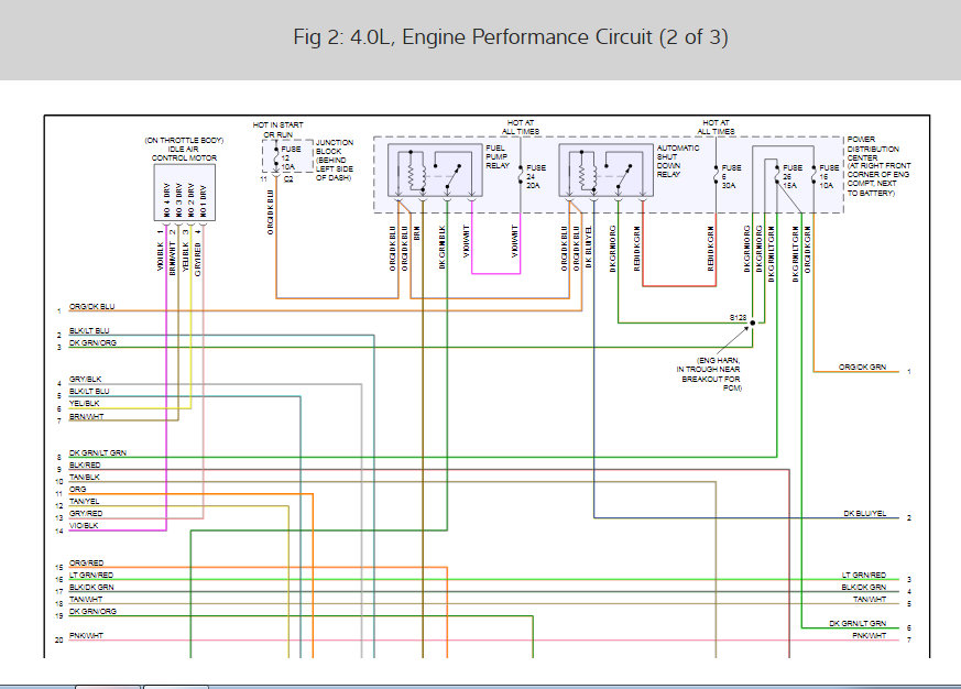

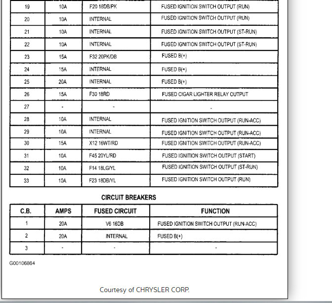

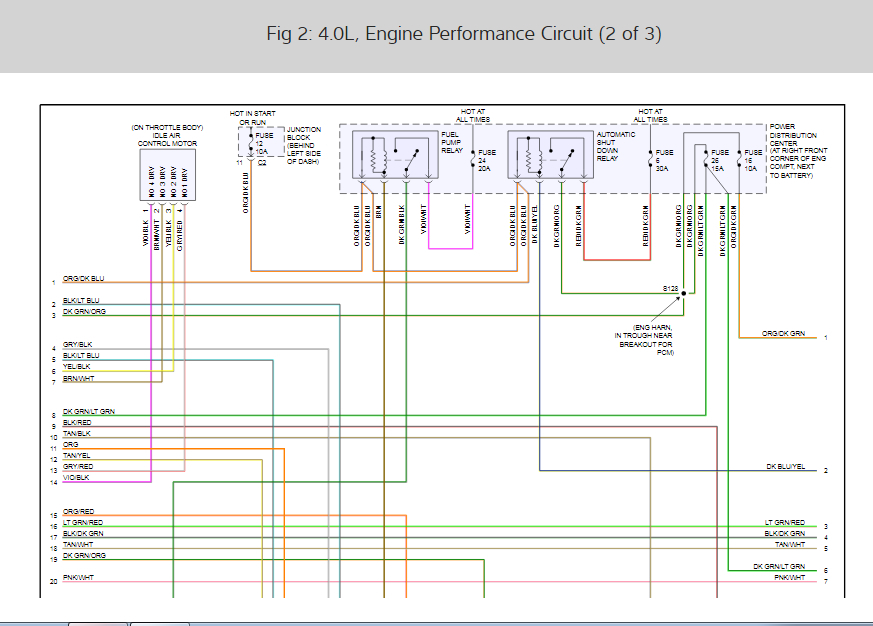

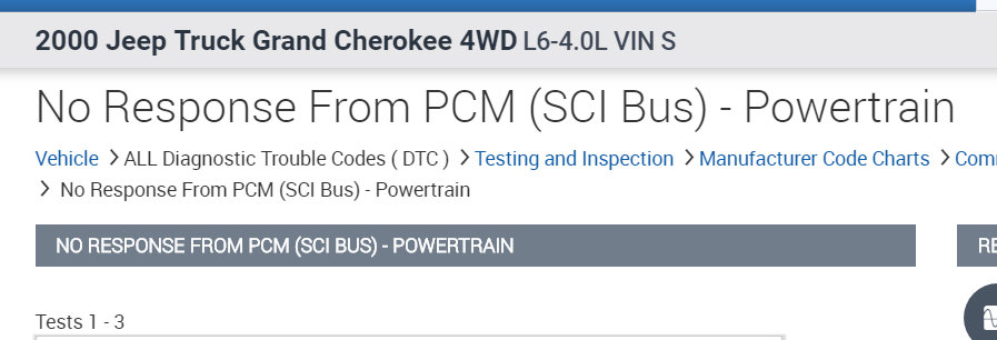

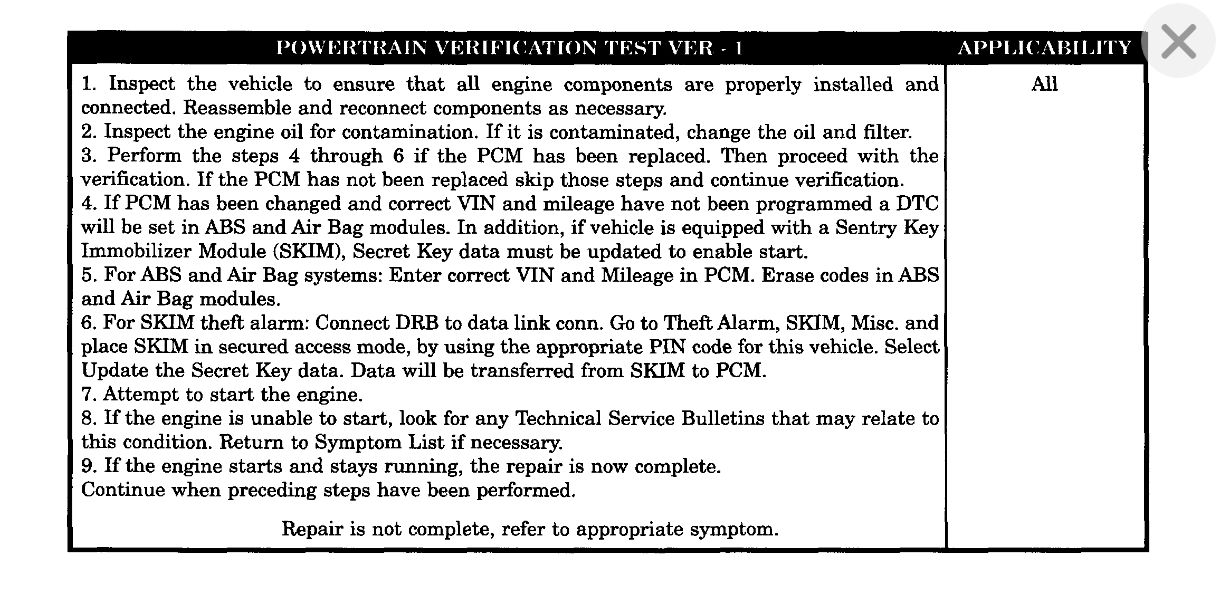

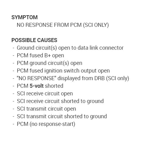

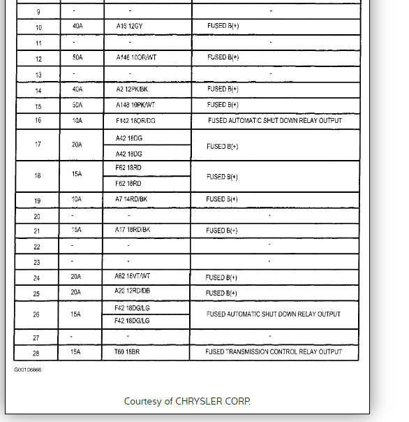

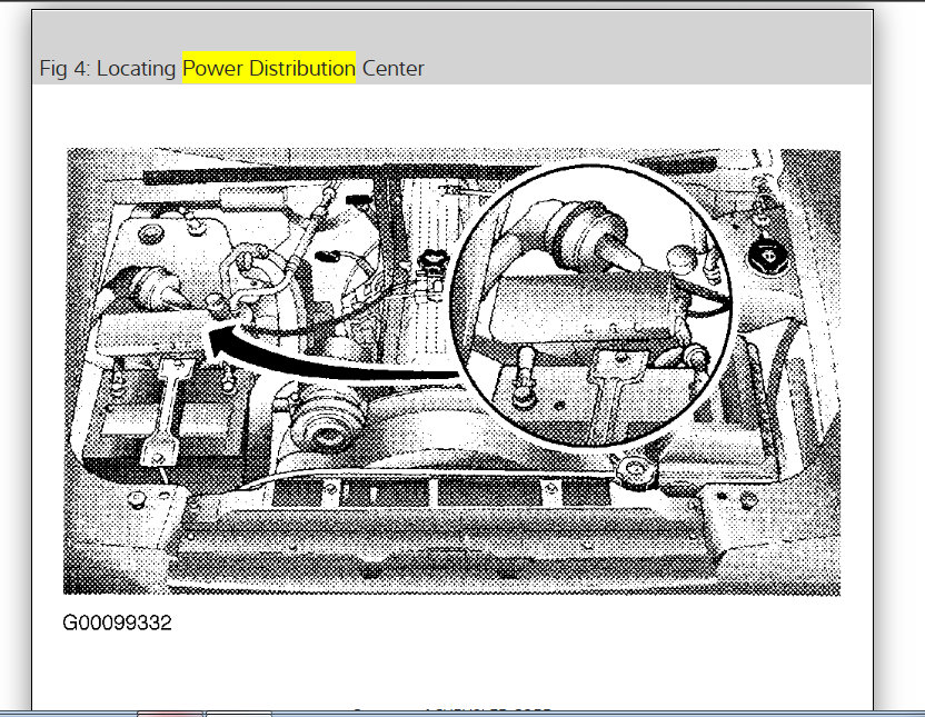

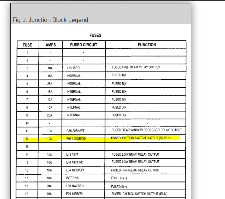

We also change and checked the relay and have power out both sides of it. where do we start to find the power loss to the pump? vehicle will turn over but will not start and has no fuel pressure.
