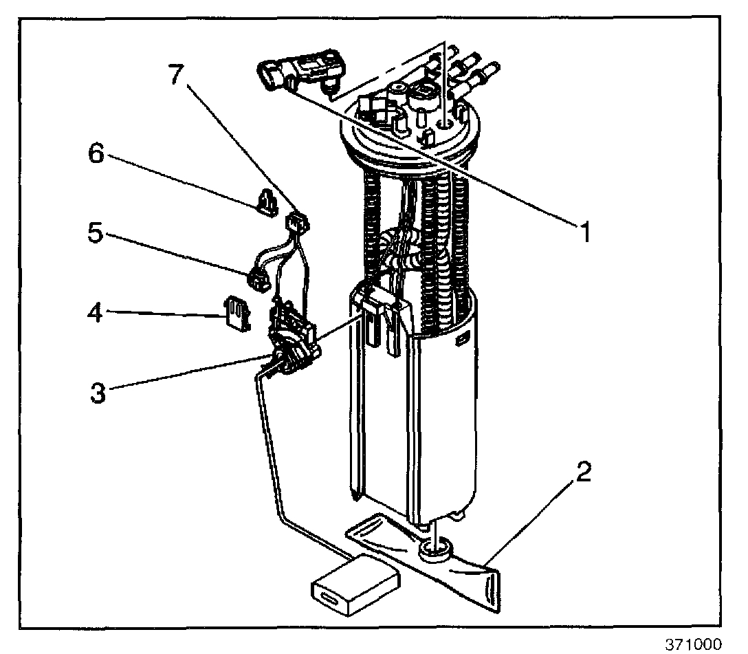

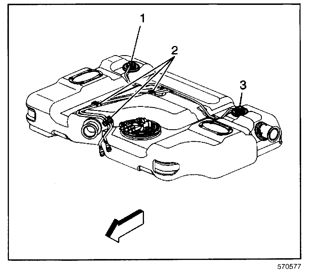

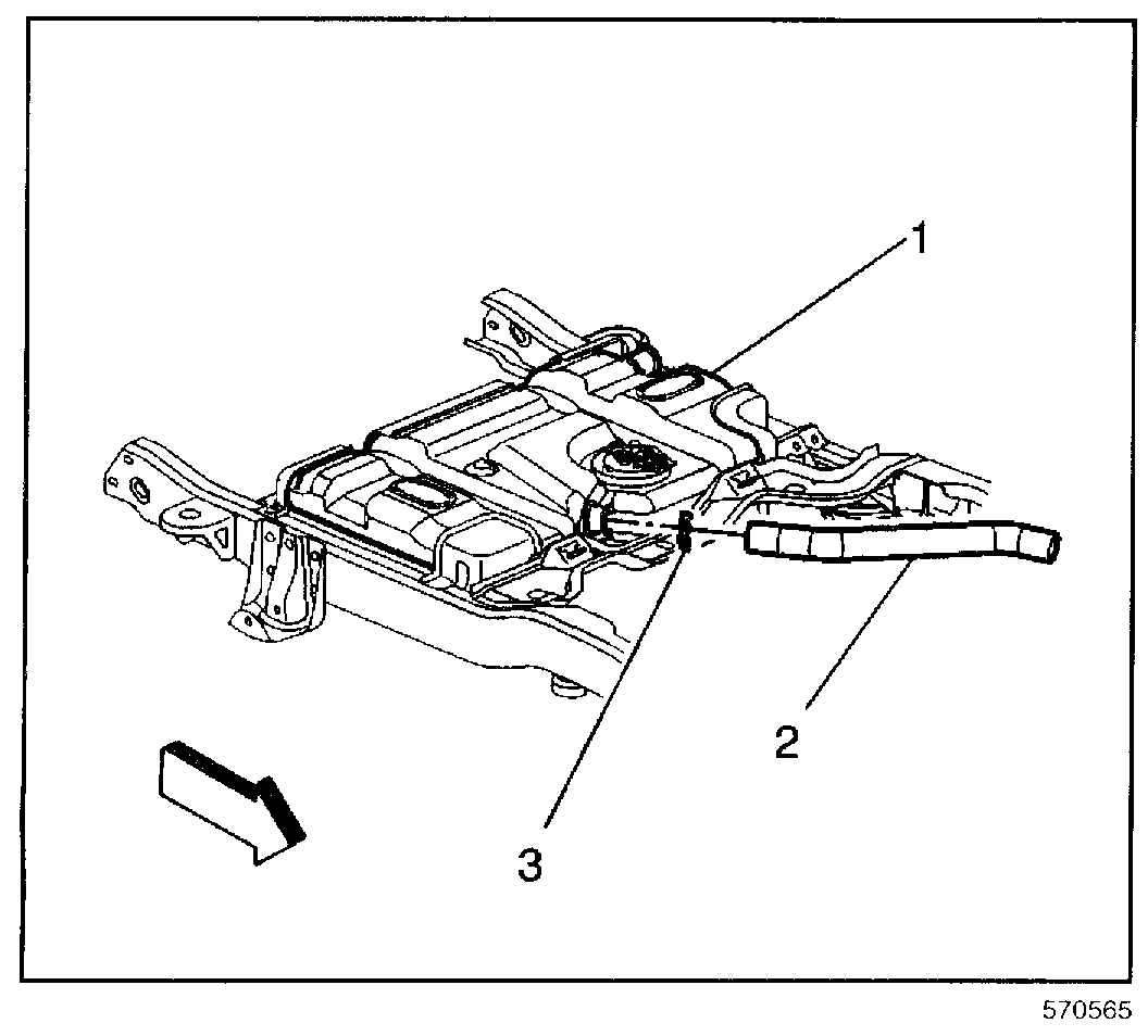

pic 1
1. Remove the fuel sender assembly.
2. Note the position of the fuel strainer (2) on the fuel sender.
3. Support the fuel sender assembly with one hand and grasp the strainer (2) with the other hand.
4. Pull the strainer off the fuel sender. Discard the strainer after inspection.
5. Inspect the strainer.
6. If the fuel pump strainer is contaminated, clean the fuel tank. Refer to Fuel System Cleaning.
7. Disconnect the fuel pump electrical connector (5).
8. Remove the fuel level sensor (3).
9. Remove the fuel pressure sensor (1).
INSTALLATION PROCEDURE

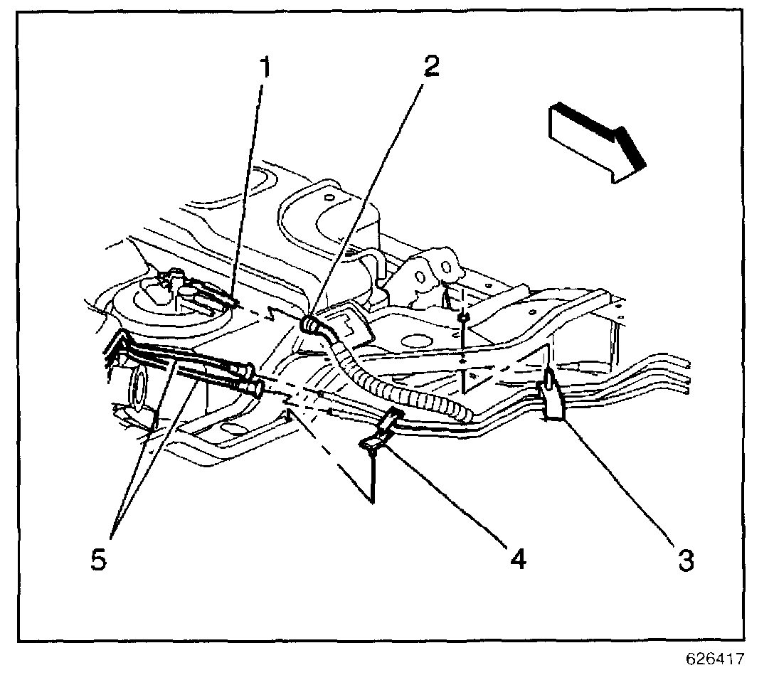

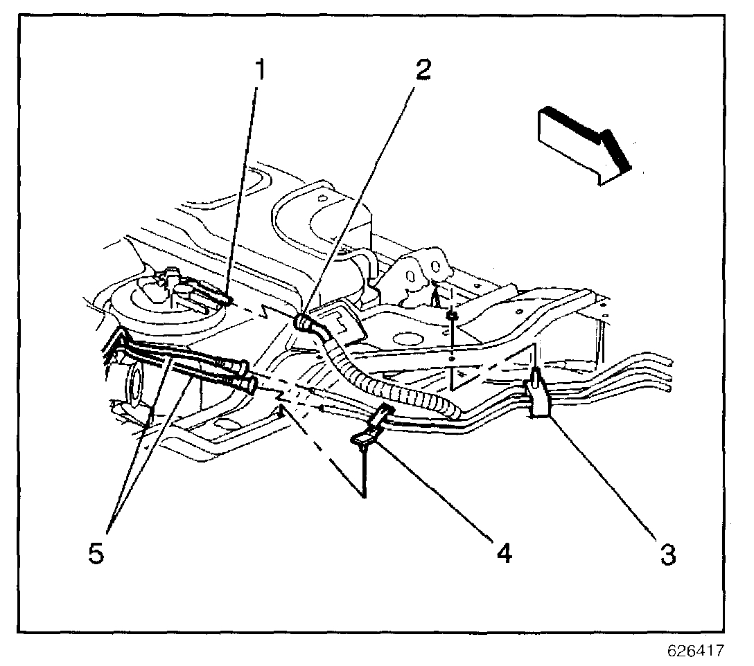

pic 2
1. Install the fuel pressure sensor (1).
2. Install the fuel level sensor (3).
IMPORTANT: Always install a new fuel strainer when replacing the fuel tank fuel pump module.
3. Install a new fuel strainer (2) in the same position as noted during disassembly. Push the strainer on the bottom of the fuel sender until the strainer is fully seated.
4. Install the fuel sender assembly.

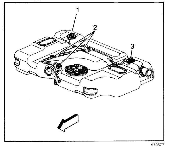

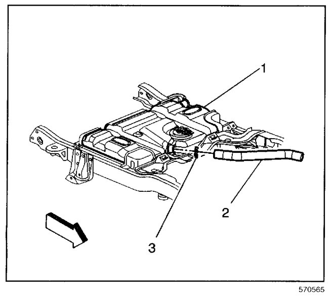

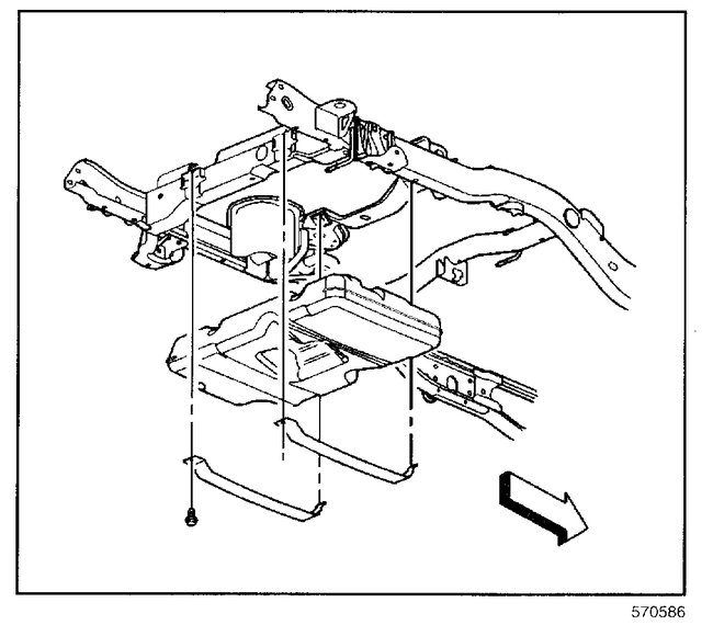

pic 3
1. Relieve the fuel system pressure. Refer to the Fuel Pressure Relief Procedure.
2. Lower and remove the under chassis mounted spare tire.
3. Raise the vehicle. Refer to Lifting and Jacking the Vehicle .
4. Remove the rear cross-member that holds the spare tire.
5. Drain the fuel tank. Refer to Fuel Tank Draining Procedure (Cab/Chassis) or Fuel Tank Draining Procedure (Utility Front Tank) or Fuel Tank Draining Procedure (Utility Rear Tank).
6. Disconnect the rear chassis fuel pipe (2) at the fuel sender (1).
7. Disconnect the fuel sender electrical connectors.
8. Disconnect the evaporative emission (EVAP) pipes at the rear tank EVAP pipes (5).
9. Cap the fuel and EVAP pipes in order to prevent possible fuel system contamination.

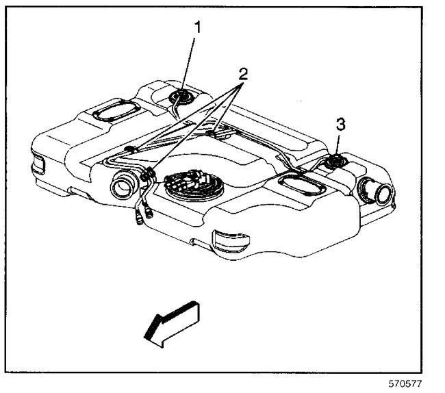

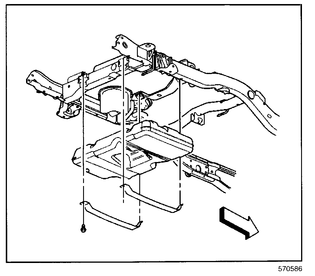

pic 4
10. Disconnect the fuel fill pipe ground strap.

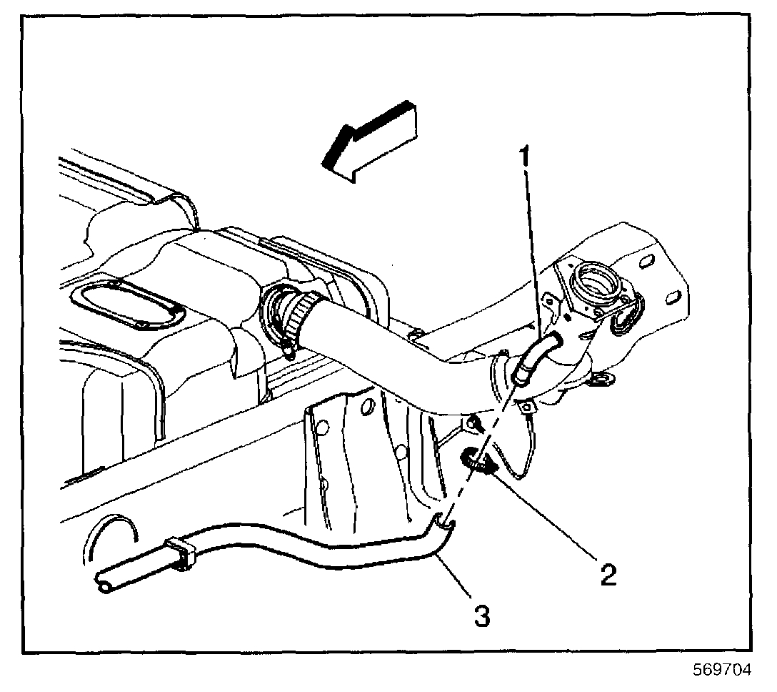

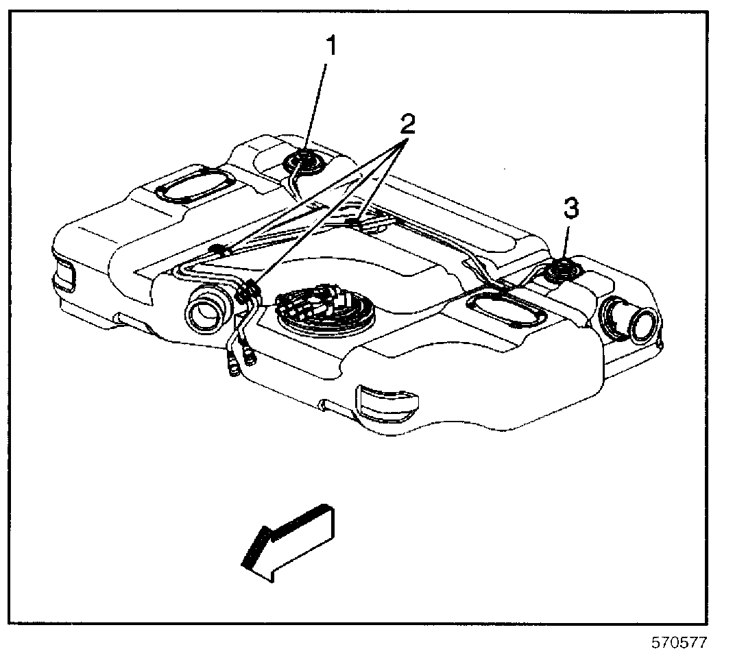

pic 5
11. Loosen the rear tank to front tank fuel till hose clamp (3).
12. Disconnect the fuel till hose (2) from the rear fuel tank.

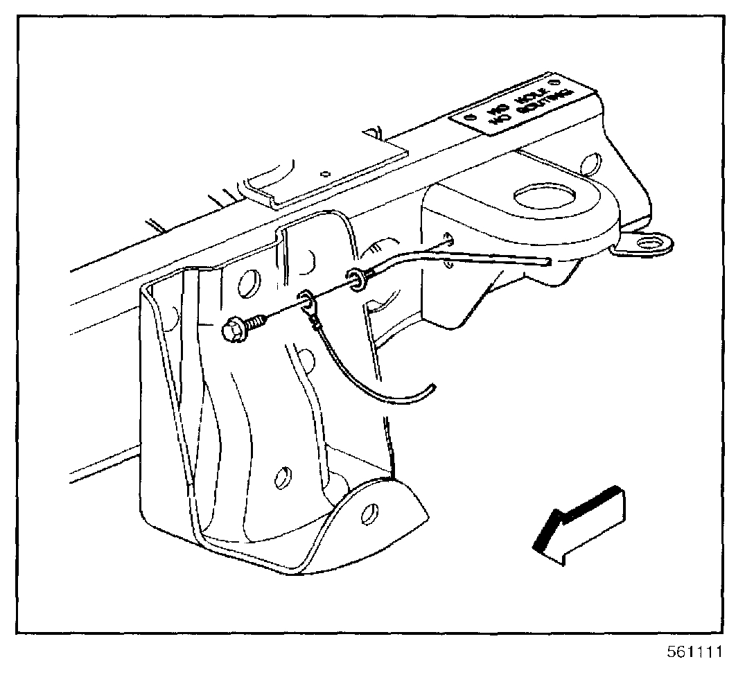

pic 6
13. With the aid of an assistant, support the fuel tank.
NOTE: Refer to Damage to Fuel Tank Straps Notice in Service Precautions.
14. Remove the fuel tank strap bolts.
15. Remove the fuel tank straps.
16. Remove the fuel tank.
