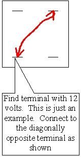

Another way to keep the circuit live is to bypass the relay with a jumper wire, but this is where you do have to know which terminals in the socket to jump together. If you have a relay that looks like one of the three in my first nifty drawing, jump terminals 30 and 87 together, or the two indicated. GM uses a lot of gray 1" cube relays with four terminals as shown in my second drawing. Use a test light or voltmeter to find which one terminal has twelve volts on it all the time. Jump that one to the diagonally-opposite terminal. That will turn the circuit on, then the bulb in place of the fuse will limit current to a safe level.

For a different method that is more practical when working in a circuit where the relay is not being turned on for you is you can install a new fuse, then use my light bulb to bypass the relay. This way the circuit will be energized all the time, even with the ignition switch off, and the bulb will limit current to a safe 1 amp. Using the bulb to bypass the relay is my favorite choice because it is faster to bypass the relay without having to get the cover off and you do not need to turn on the ignition switch. Remember to have a good fuse installed. Use the same terminals in the relay's socket that you used with the jumper wire, but this time put the test bulb there instead of the wire.
