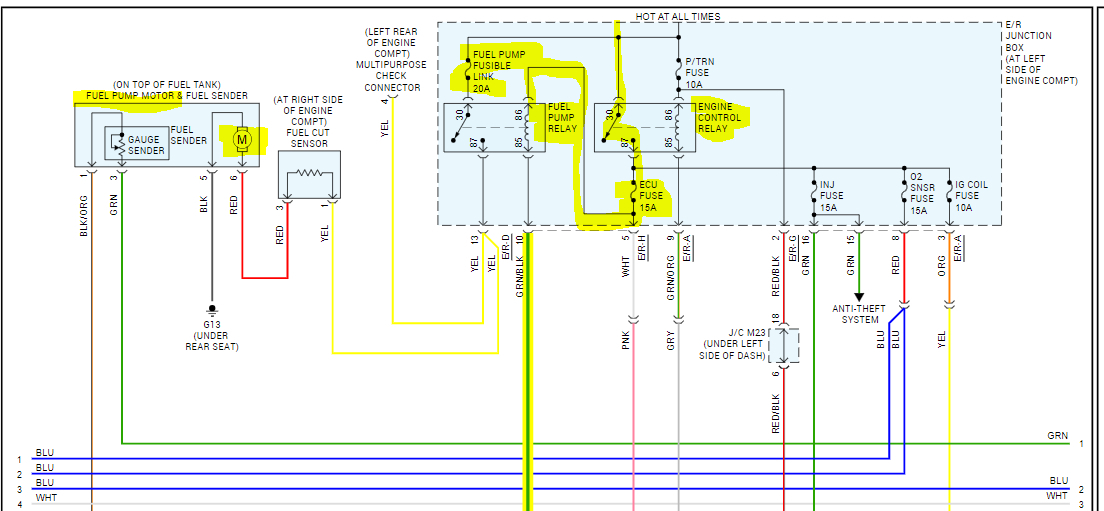

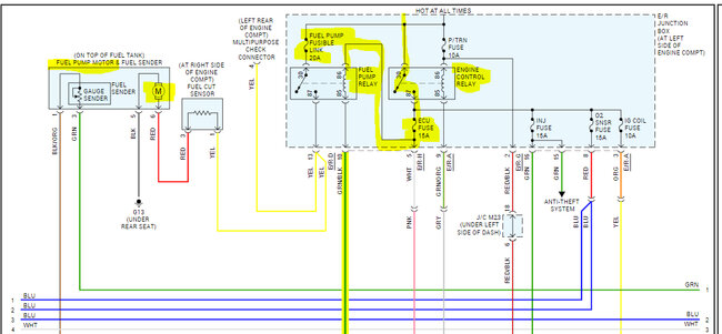

I have changed the purge valve. The crank shaft sensors I've checked the relay fuse. I've checked the regular fuses. And I have changed the fuel pump itself. But still when I turn the key on. It's not engaging and it's lagging when it starts. It first started lagging when I would get gas. Then it became every time I go to start it. It is lagging to start after I've done all this stuff to it.
