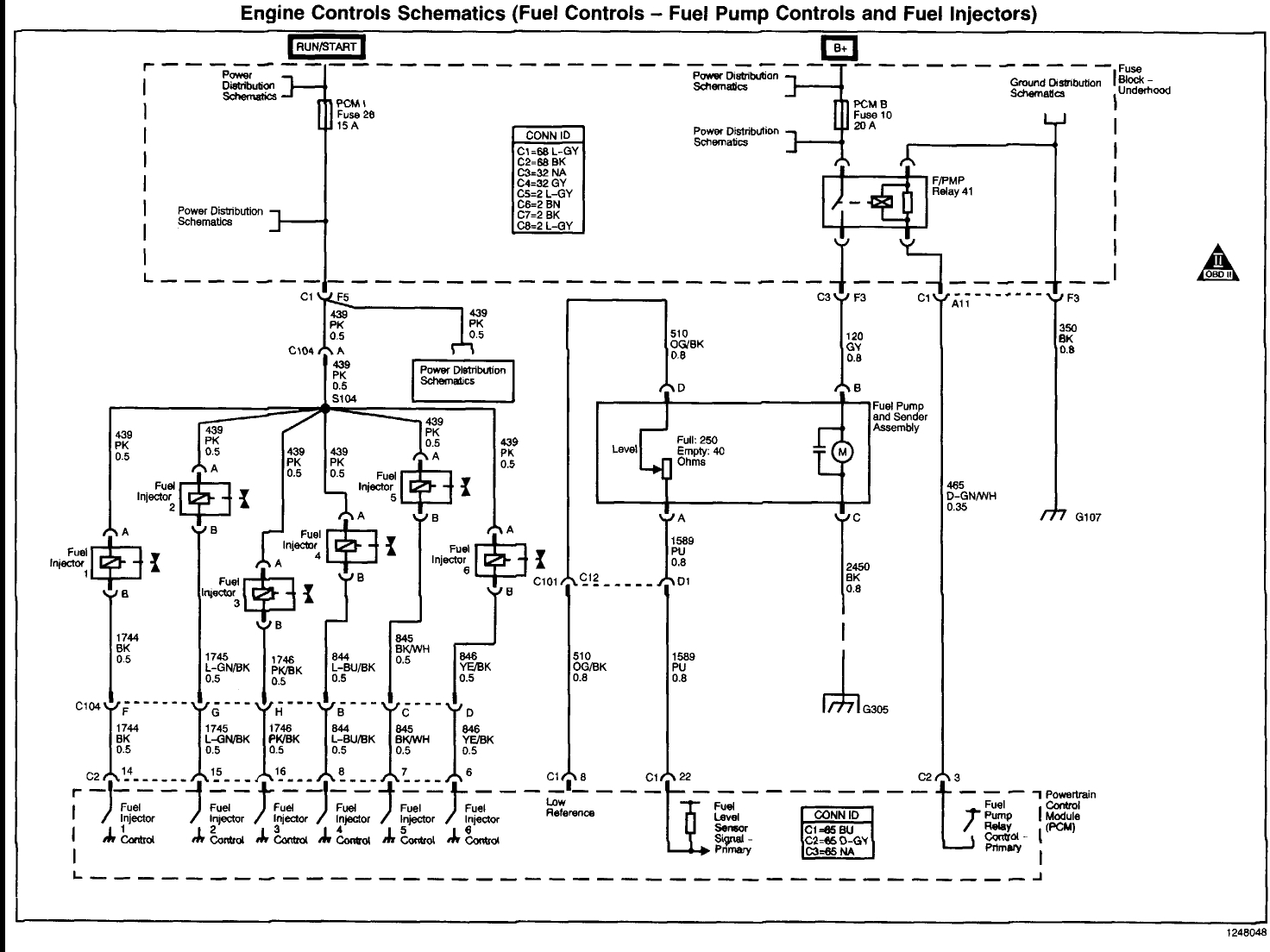

Check fuse #10 in the engine compartment. If okay then check fuel pump relay. You can do that by swapping out with another relay like headlights or horn as long as they are the same. If still no fuel pressure with a test lamp back probe the grey wire to fuel pump. If it lights up then the fuel pump is actually bad and you should be good on your repair. When you check it, have someone turn the key on. The light will just come on for a second then go out. While cranking the test light will come on again. If the test light does not light up then there is a problem in the circuit like a burnt terminal under the fuse box?

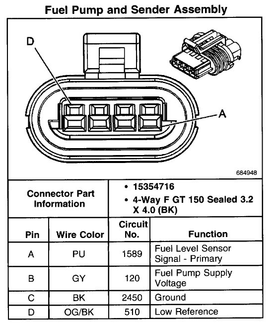

Apply battery voltage and ground
Nov 18, 2016 at 9:29 AM
JIS001
  • 3,412 POSTS
Added the diagram. The 2 pins you need to apply battery power and ground are the 2 middle pins on the fuel pump side. If you have a power probe it will be much easier. On the pump from left to right the 2nd pin is power and 3rd pin is ground. Hope that helps.

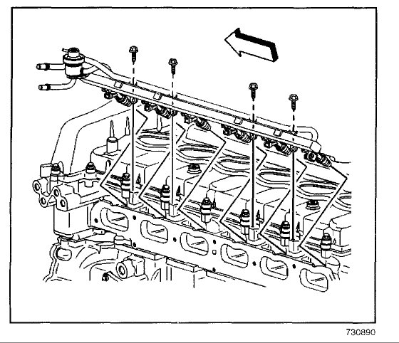

the battry cable been disconnect will that erase the codes? i will scan again, where are the injector located? i look for the injector couldn't find it can you send pictures? i did check for spark i did see a spark but the battry is low and the engine wasn't turning fast enough so the spark was a hit and miss.
Nov 22, 2016 at 11:27 AM
JIS001
  • 3,412 POSTS
If battery was disconnected then the codes will reset. The fuel injectors are under the intake manifold.
