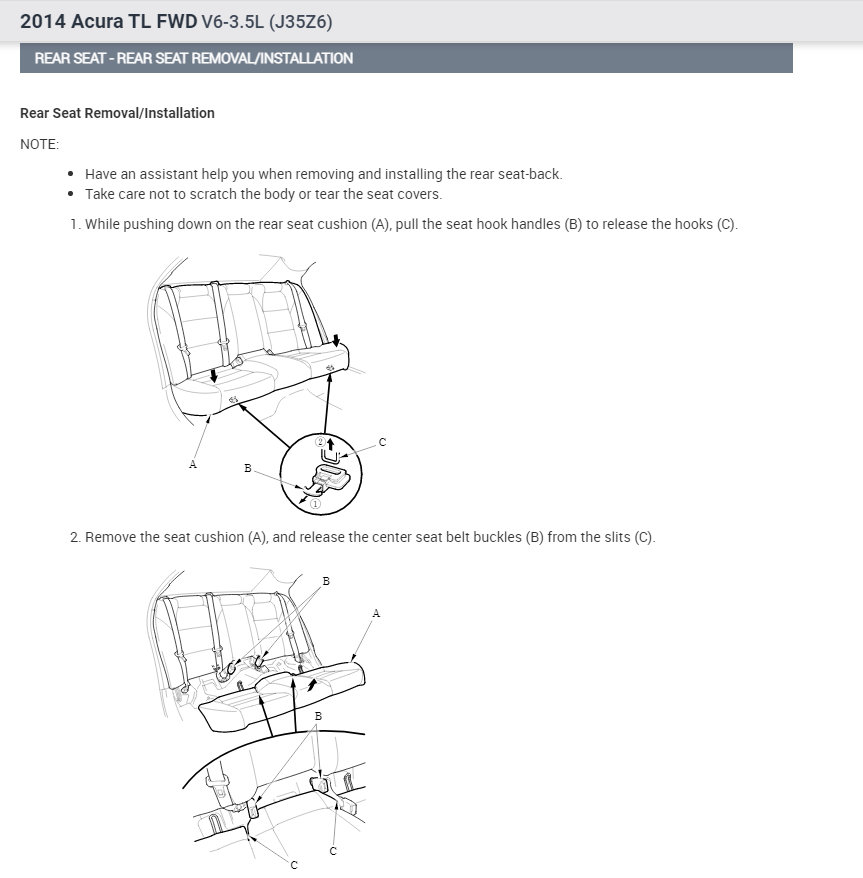

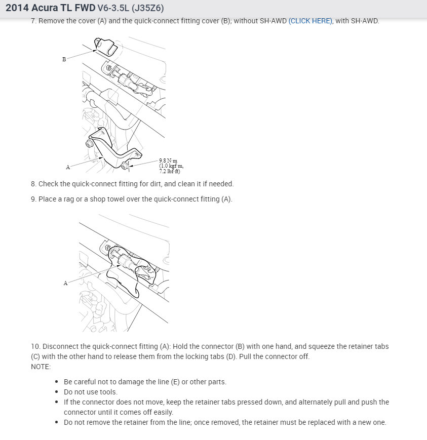

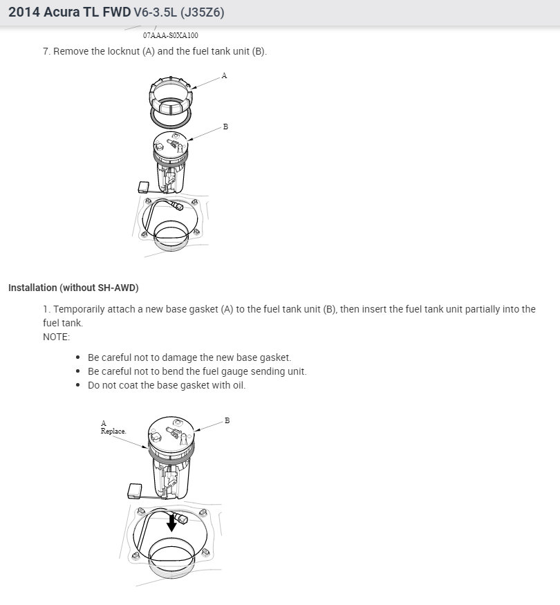

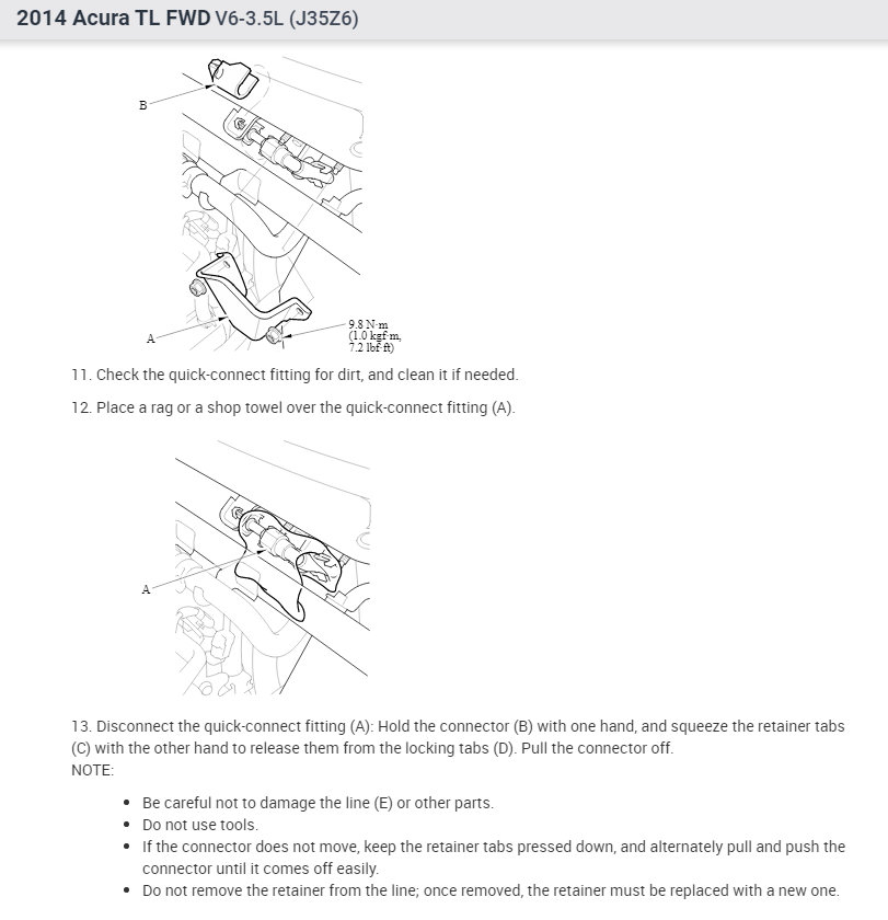

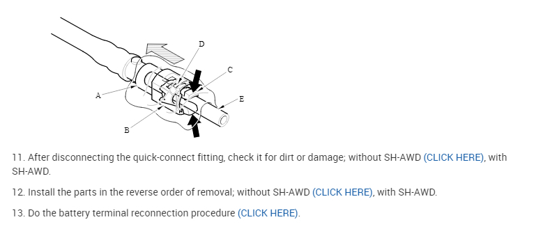

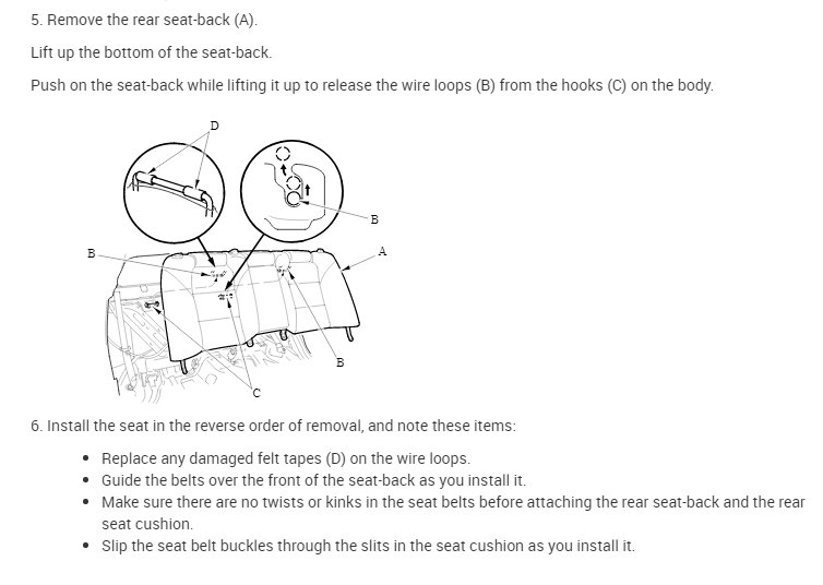

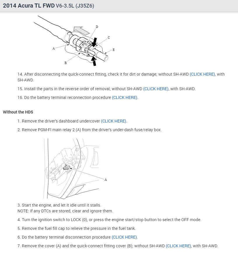

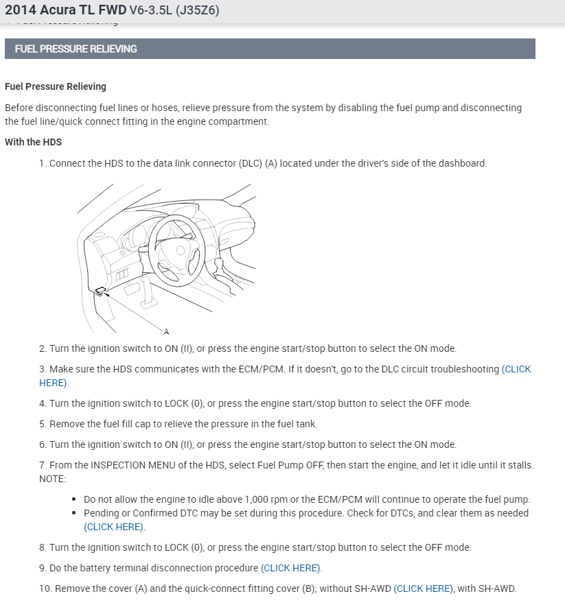

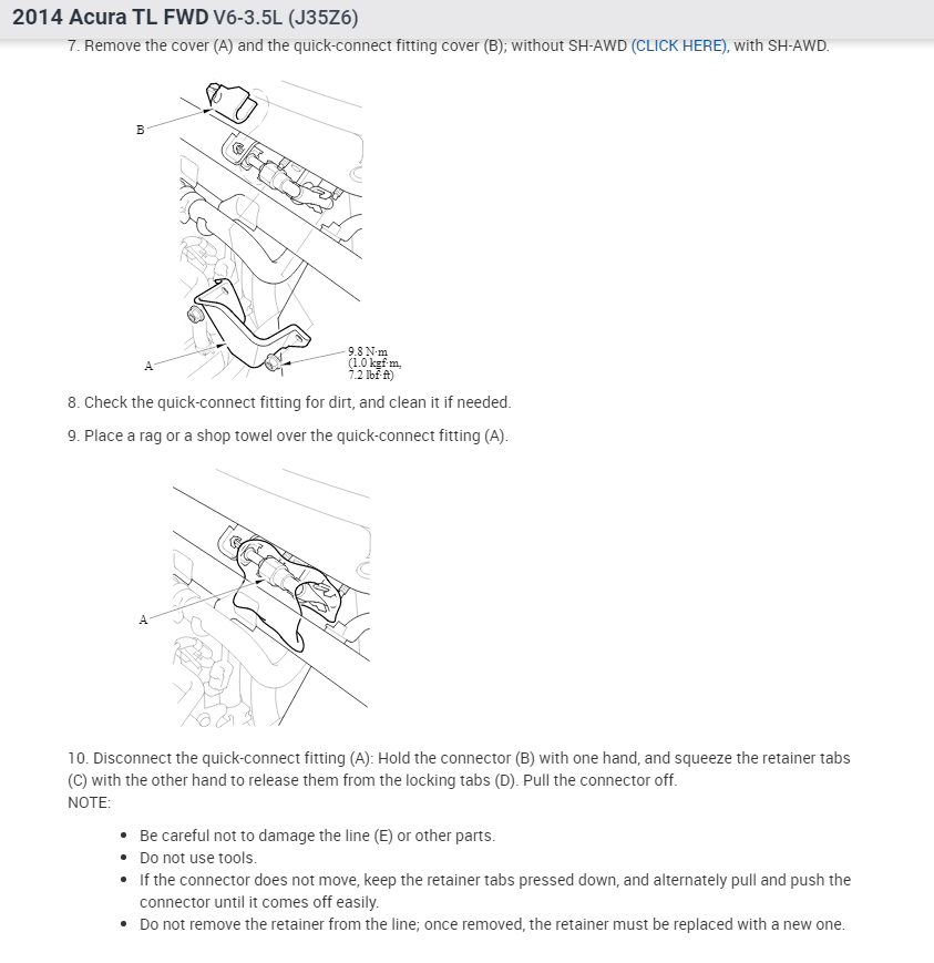

Is your vehicle front wheel drive of all wheel drive.

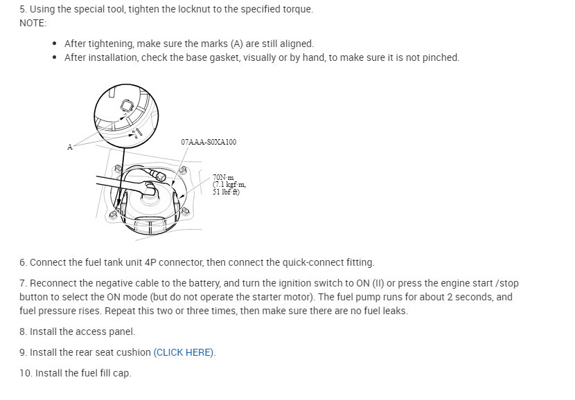

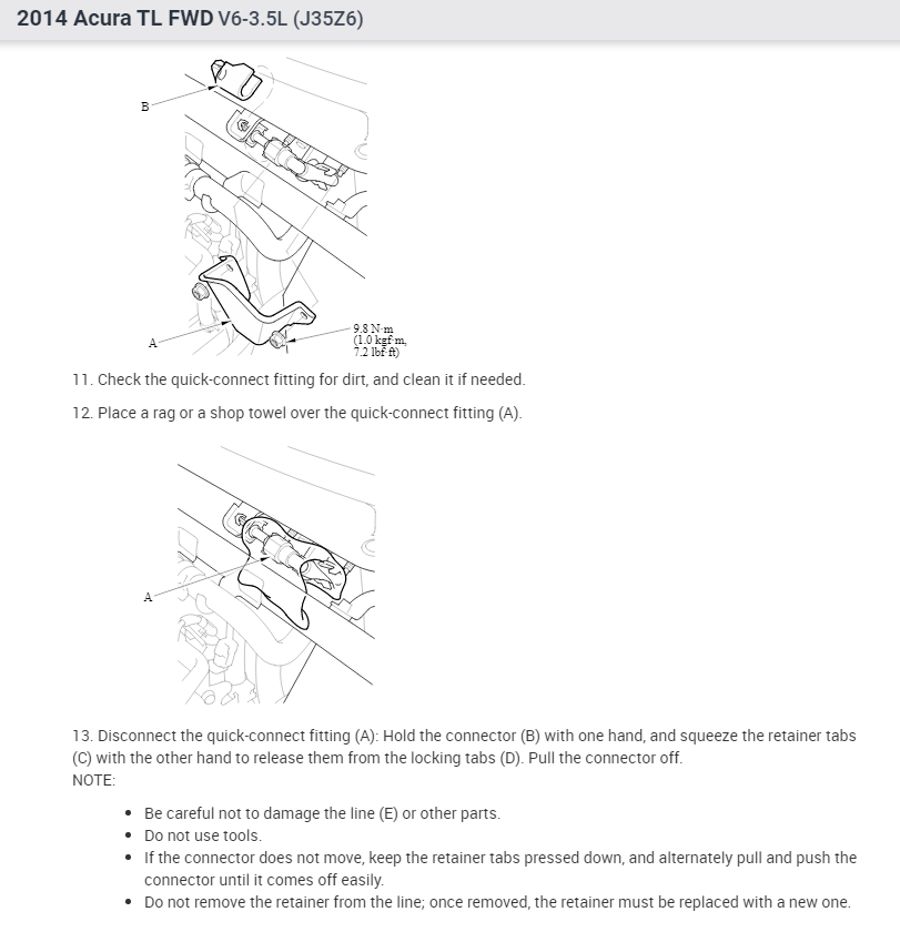

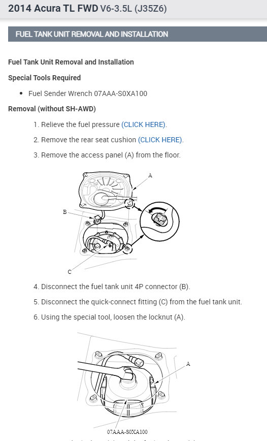

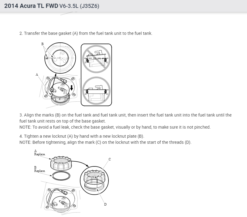

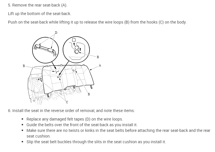

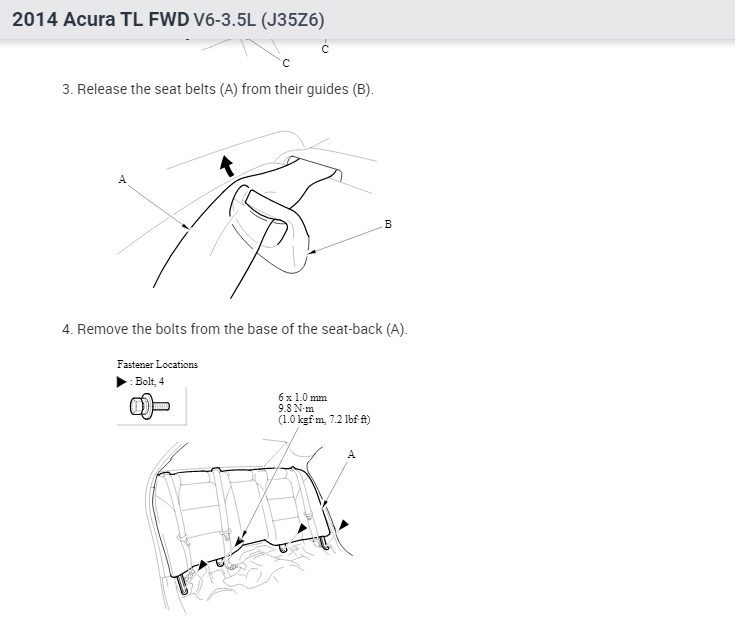

For the front wheel drive vehicles, the fuel pump can be accessed by removing the rear seat. On all wheel drive vehicles, the fuel tank must be removed to get to the fuel pump.
I have attached the procedure for the front wheel drive TL below.
Let me know of any questions.
Thank you.
